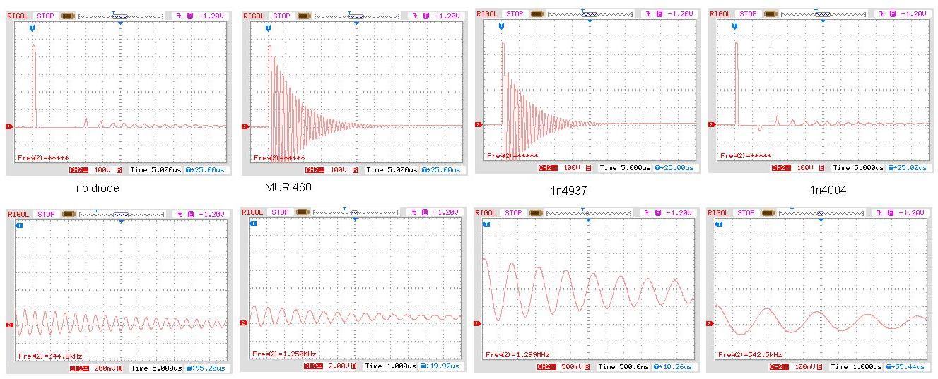

KingJL suggested some diodes in the early replies. A test I posted awhile back with some diodes. Thinking X10 probe across coil. IN4937 has a slightly higher SRF but looks like larger drop in voltage first cycle decay. Someone had posted using MUR460 diode and it looked good so I quite experimenting.Originally posted by dbanner View PostI was wondering, are there any other suitable diodes besides the MUR460 which can be used here?

There are actually quite a few... the only issue is how much voltage do you want. For through hole designs the MUR460 has the highest voltage (600 V), which is why it is so popular. The first diode that I experimented with that exibited this charactaristic was a BYV28-200 Sinterglass diode... but the limitation here (if you veiw it as a limitation) is the "200" V. For SMD apploications the MURS360 (600 V) and the MURS320 (200 V) will work.Originally posted by dbanner View PostI was wondering, are there any other suitable diodes besides the MUR460 which can be used here?

I have not had success with extremely low ( ~1p ) capacitance diodes. It appears that there has to be enough capacitance to hold a charge large enough that it will not be dissipated off too easily. All of the successfully used diodes (by me) are high speed or ultra fast recovery diodes and seem to have around 10pf capacitance when reversed biased.
