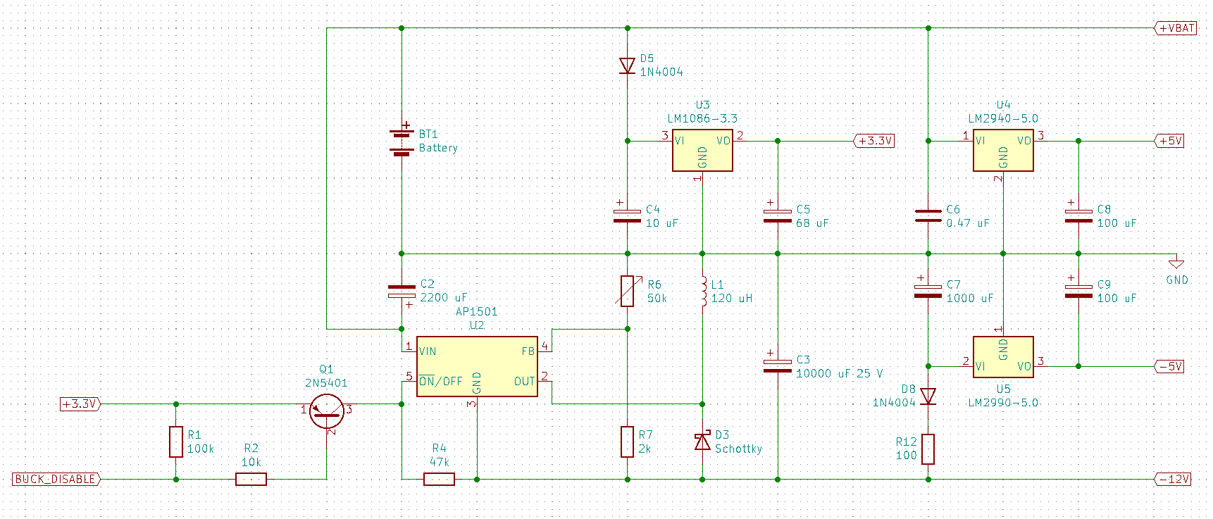

    While thinking about different ways to go about making a PI detector power supply, I came up with this and thought it looked promising. I am no expert in designing electronics, so I figured I'd post it here in hope of some feedback on why this would work or would not.
    Also as inspiration I saw some users boosting the whole battery pack up to +15V with a switcher and then having a conventional PSU after that. Didn't find anything about using an inverting buck boost though.
    I mean something like this:
    The +5V analog supply and the +3.3V digital supply can taken from the battery via linear regulators U4 and U3.
    The -12V rail that powers the TX coil is created by U2, which is one of those 5-pin "simple switcher" DC/DC converters, configured in an inverting buck-boost topology. It can be shut down by the micro during sampling. Charge is stored in capacitor C3, to provide -12V when the switcher is off.
    The -5V analog rail is derived from the negative -12V rail with a linear regulator U5, decoupled with a resistor and a diode.

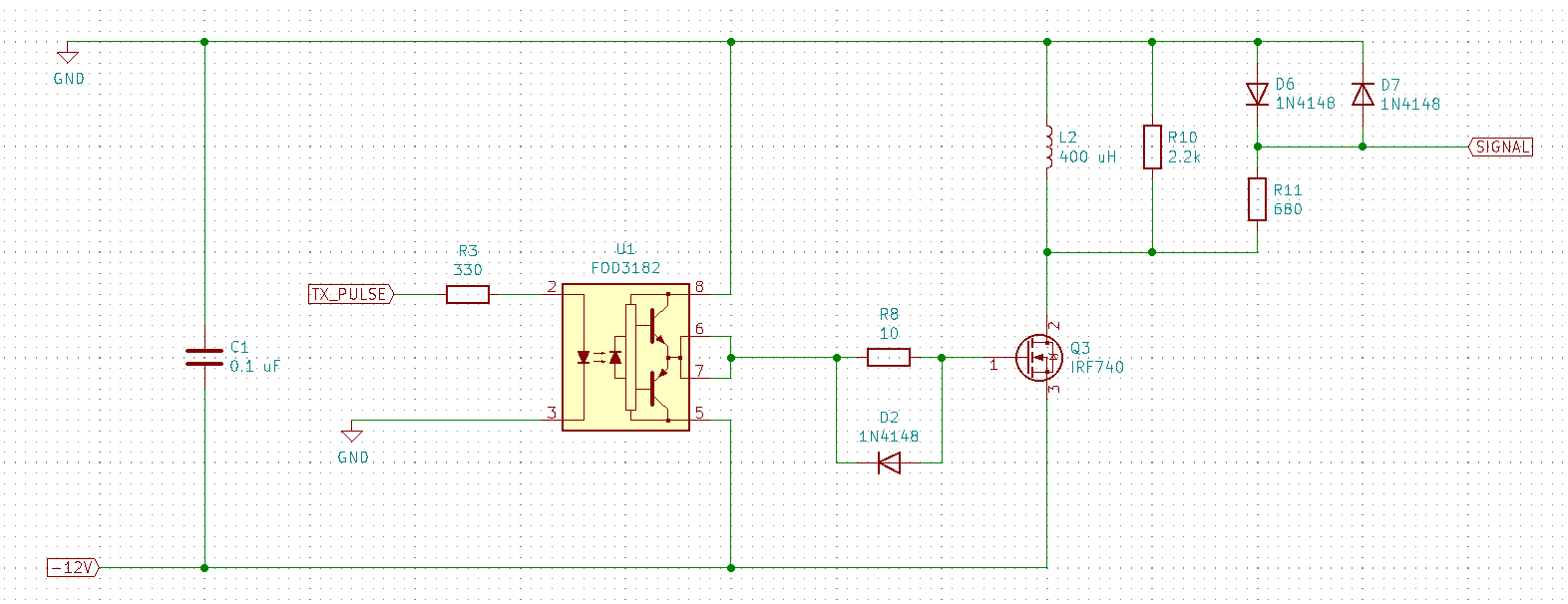

    TX part:
    Coil would be connected between battery ground and -12V. Signal from the micro has to be level-shifted to drive the FET. With an optocoupler-MOSFET-driver combined chip, for example. The RX signal would be referenced to the ground rail.
    My opinion:
    Pros:
    - Variable TX voltage
    - TX voltage is independent of battery voltage
    - Can operate from batteries as low as 6V
    - Analog rails aren't limited to charge pump currents
    - RX signal is referenced to ground
    Cons:
    - Uses a switcher, potentially noisy, harder to design
    - Needs an inductor and a large capacitor for the switcher
    - Uses an optocoupler to drive the TX FET
    - Not as efficient as driving coil from the battery
    - PPS is limited to the switcher's ability to charge the reservoir capacitor, especially if switched off during sampling
    - -5V analog rail is derived from the noisy switcher output while it is operating
    Unknowns:
    - Will the switcher be able to shutdown and restart fast enough to switch off during sampling?
    Thoughts?
    start with your last question- No, I do not think the switcher will start fast enough to turn off during
    RX period then back on. Prototyping is required to test this.
    In general the schem looks ok.
    Possibly use a different switcher chip that can be sync'ed to the TX pulse cycle. This would remove the need to turn it off during RX.
    This is a practice behind many of the PI design on this forum.
      Suggestions:
      You may want to split C3 into multiple parallel caps. Better ESR & probably smaller/cheaper.
      Instead of disabling the switcher, might can alter the feedback to fool it into thinking the output is too high. I don't know if that will temporarily disable the switching or if the PWM just drops to a low duty cycle, you'd have to try it.
        Thank you for the feedback. I'll try 3x 3300 uF caps in the final version. About a clockable switcher chip, I have seen clockable charge pump ICs used so far on the forum. I'm sure there are DC/DC converter ones as well though. I'll look for them if this 5-pin switcher I already have doesn't work out.
        So far I have built the switcher part of this circuit with a 1000 uF input and 470 uF output cap for testing. It does work. Well, with a 12V sealed lead-acid battery at least. Draws < 20 mA of current while practically idling.
        What worries me though is that it does not operate from high resistance sources, such as a 9V alkaline battery or a 12V battery with a 27 ohm resistor in series. In that case, the switcher draws 0.5A of current while the output voltage is stuck at -2.3V. The 9V battery voltage drops to 2V. If I slowly crank the output voltage up from -1.25V to -12V, it works fine. Can't say for sure what is happening, especially as my scope is broken. I am guessing that the switcher increases duty cycle too agressively. Perhaps even to 100%, which would be fine for a normal buck converter, but not for an inverting one.

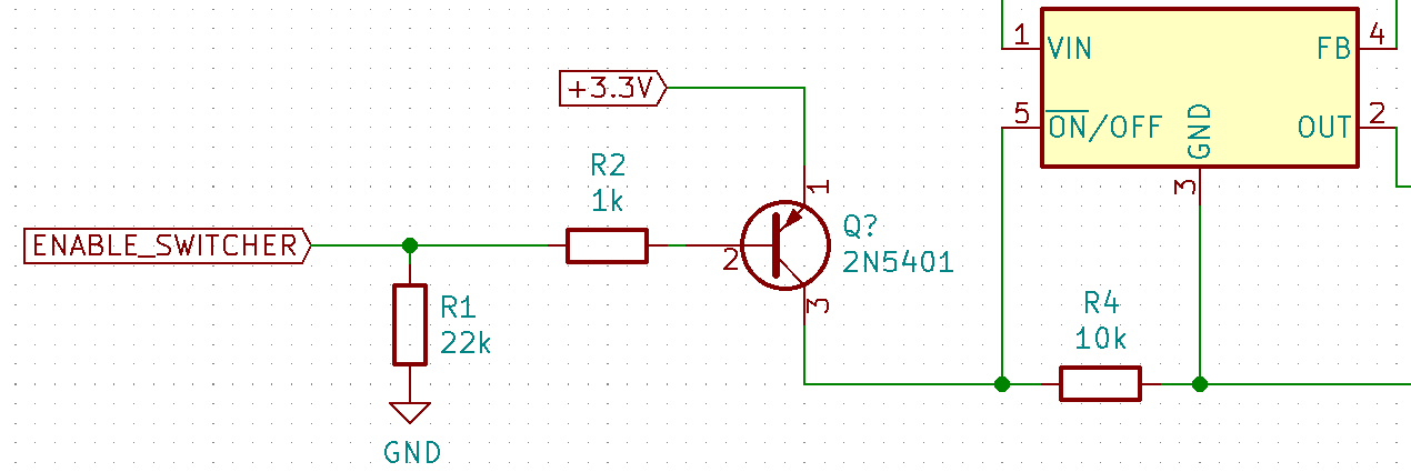

            Hi
            Regarding the enable circuit, the logic high doesn't necessarily have to be B-. 2V above V- turns the regulator off. Up to 25V is allowed in case of the LM2596 and up to 40V in the case of AP1501. Both B- and +3.3V rails sit well in this range, if one is not pushing the voltage specs of the regulator.
            I went ahead with the enable circuit I posted, because I already had the traces laid out and I couldn't think of a clean way to have the regulator off by default with the common-base transistor. I lowered the values of the resistors to speed things up, and changed the pull-up resistor R1 to pull-down instead, to have the regulator off by default.

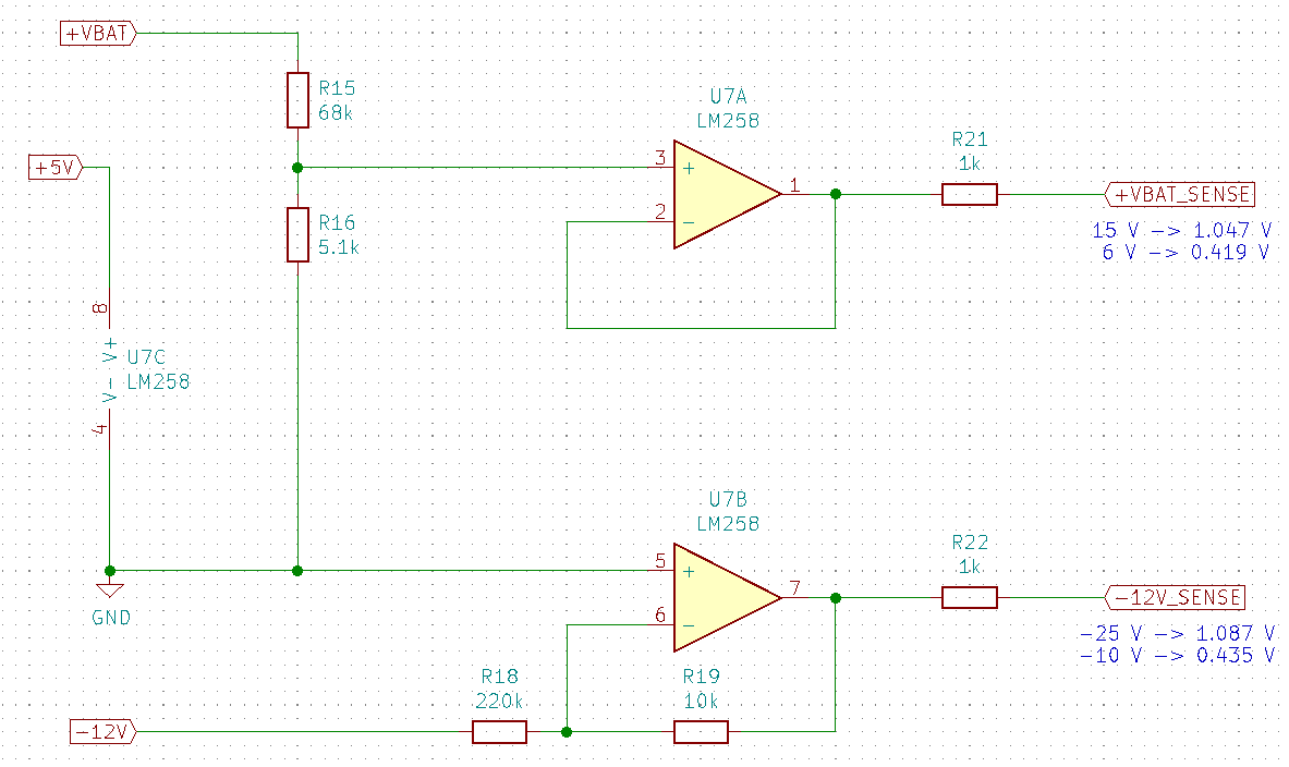

            Since I'll have to turn the switcher off during sampling period with the micro anyway, I wanted to also do a microcontroller based soft-start circuit. For this I first made a circuit to monitor the switcher output voltage with the micro's built-in ADC. Click image for larger version
ID:	356426. Also threw in battery monitoring, since the LM258 op-amp has 2 channels anyway. I chose the LM258 because its input and output ranges include ground, meaning it can output in the 0-1V range for the ADC without needing the -5V rail.

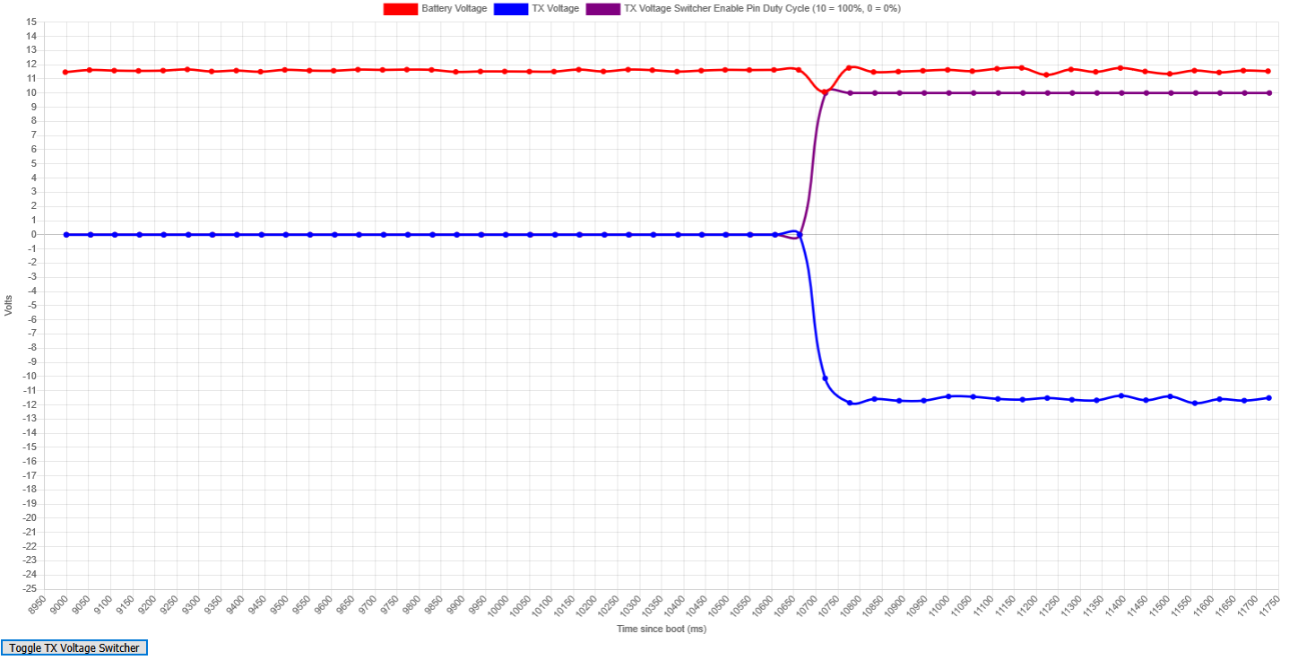

            Now for the micro I am using an ESP32 at the moment. Not wanting to mess with the power from the USB cable and from the detector's power supply creating problems, I moved to wireless programming over Wi-Fi. Quite neat. This meant setting up a HTTP web server on the micro, which I also used to create a sort of development or debug interface for the detector. Click image for larger version
ID:	356425. Here is the micro uploading the measurements to my computer over websockets. Even at just sampling every 50 ms the dip in the battery voltage can be seen when the switcher is turned on instantly.

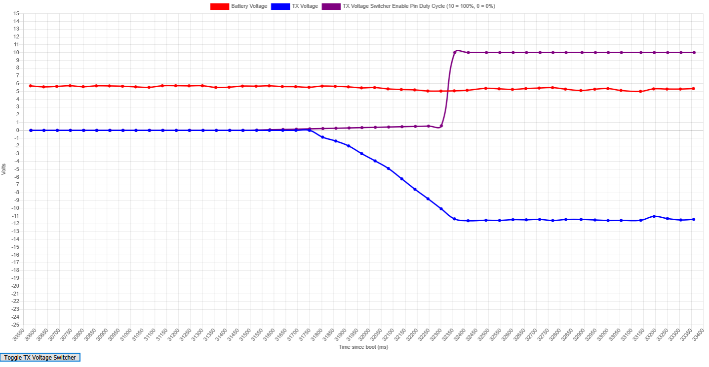

            So to solve the problem, first I just tried waiting a few seconds for the input capacitors to charge etc. before turning on the switcher, but that proved to not to be enough (I believe this is also how the soft-start circuit in the datasheet works). Next I applied a PWM signal to the enable pin of the switcher with a frequency of 1000 Hz and a duty cycle of 0% at first, which I increased by 0.5% every 50 ms. This did work, and allowed the circuit to start from a rather empty 9V battery for example. From the micro's monitoring graph it can be seen that the TX voltage also builds up gradually: Click image for larger version
ID:	356424. Also I made it so that once the switcher voltage reaches close to its nominal value, the enable pin duty cycle is set to 100% to allow the switcher to do its thing.
