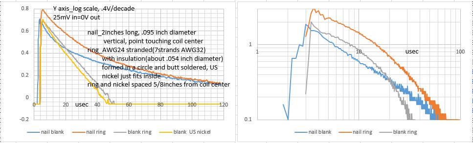

                Haven't replied with a decay profile because I don't have any rings. Thought about using a US nickel. Made a ring with some copper wire. Like waltr replied, nail position makes a big difference. Nail centered on coil flat is a lot less signal than nail centered and vertical. Nail flat near the edge higher signal than centered. Including some charts with targets centered. First chart, recorded log amplifier out vs time. Second chart, charted log-log(amplifier out)target recording minus no target recording . Can do with targets in different positions if anyone is interested.
                      Coil_Rx(2)8inch round figure8, Tx oval around Rx
                      Some thoughts. [ https://www.geotech1.com/forums/atta...8&d=1580669439 ] Subtracted the (nail) recording from the (nail ring) recording with Excel. Close to the ring recording, not exact. In general, targets side by side add, targets stacked don't. Didn't know what would happen with the ring and nail. Nail was stuck vertical in a 5/8 inch piece of foam. Placed nail over coil center with point touching coil(recorded decay). Ring was placed centered over nail 5/8 inch above coil center(recorded decay). Nail was removed(recorded decay) . Thin short time constant targets normally chart straight line decay linear X log Y. A US nickel hasn't in the beginning of the decay. Have thought decay is faster in the beginning with thicker targets was due to skin effect, current on surface only(higher resistance). Wasn't sure if not being straight line in the beginning with the nickel was real or my tester. The stranded wire ring does chart straight line decay with almost the same slope as the nickel. Think nickel is showing skin effect?
                      Maybe some skin effect, solid coin made with many rings. Smaller rings decay faster(less inductance)?
                      If ring is made with thicker solid wire and doesn't decay straight line is it because skin effect or inside of ring is smaller than outside?

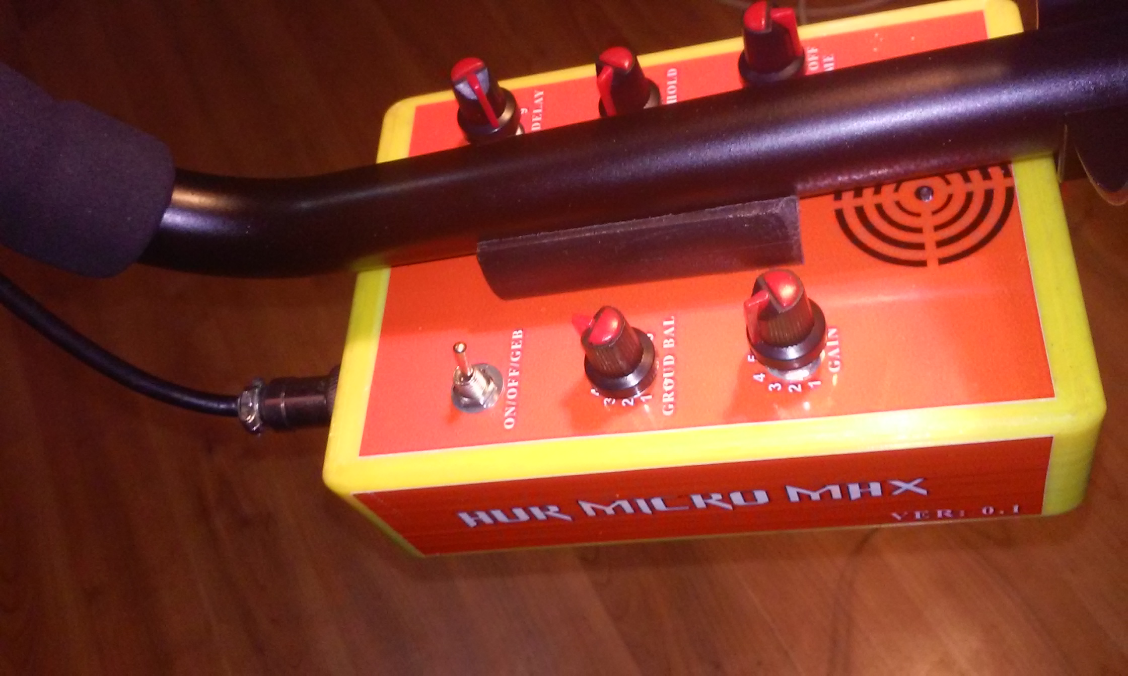

                        I have this completed in 2015 but I added now i section the same like on sheme TDI also I removed and added one amplifier in the tone section as well as the noise partas in TDI-SL, i tested in the soil Roman denarius over the cross two nails at a depth of 27cm-30cm detects in a strong clear tone I tested two VLF detectors at the same time neither could find at all roman denarius ...Of course he ate some of the letters on the label
                          Are you suggesting the TDI would pass this test as well? I don’t know anyone that has said this for sure.
                          What is the design key to being successful ignoring iron but seeing the ring?
