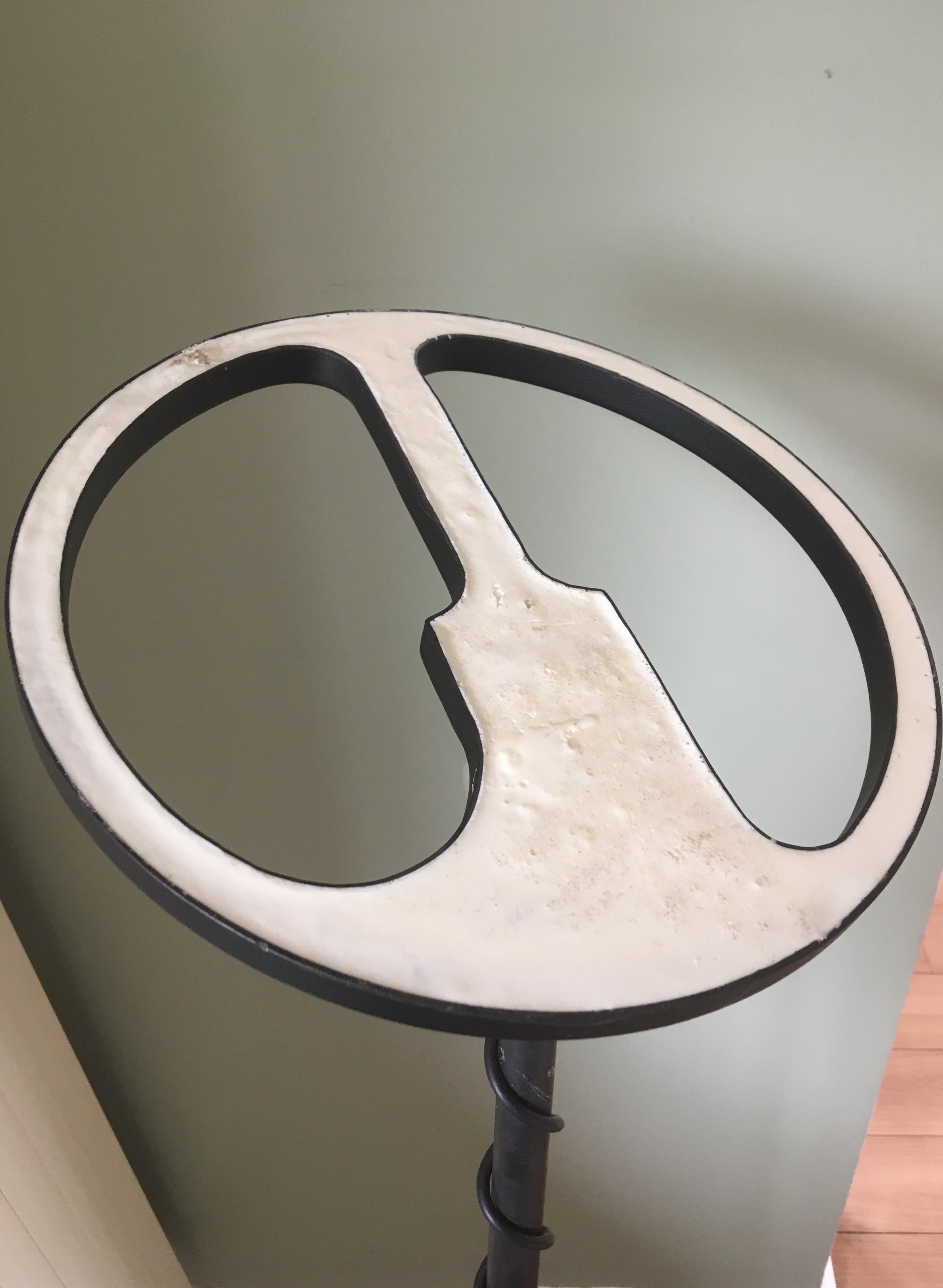

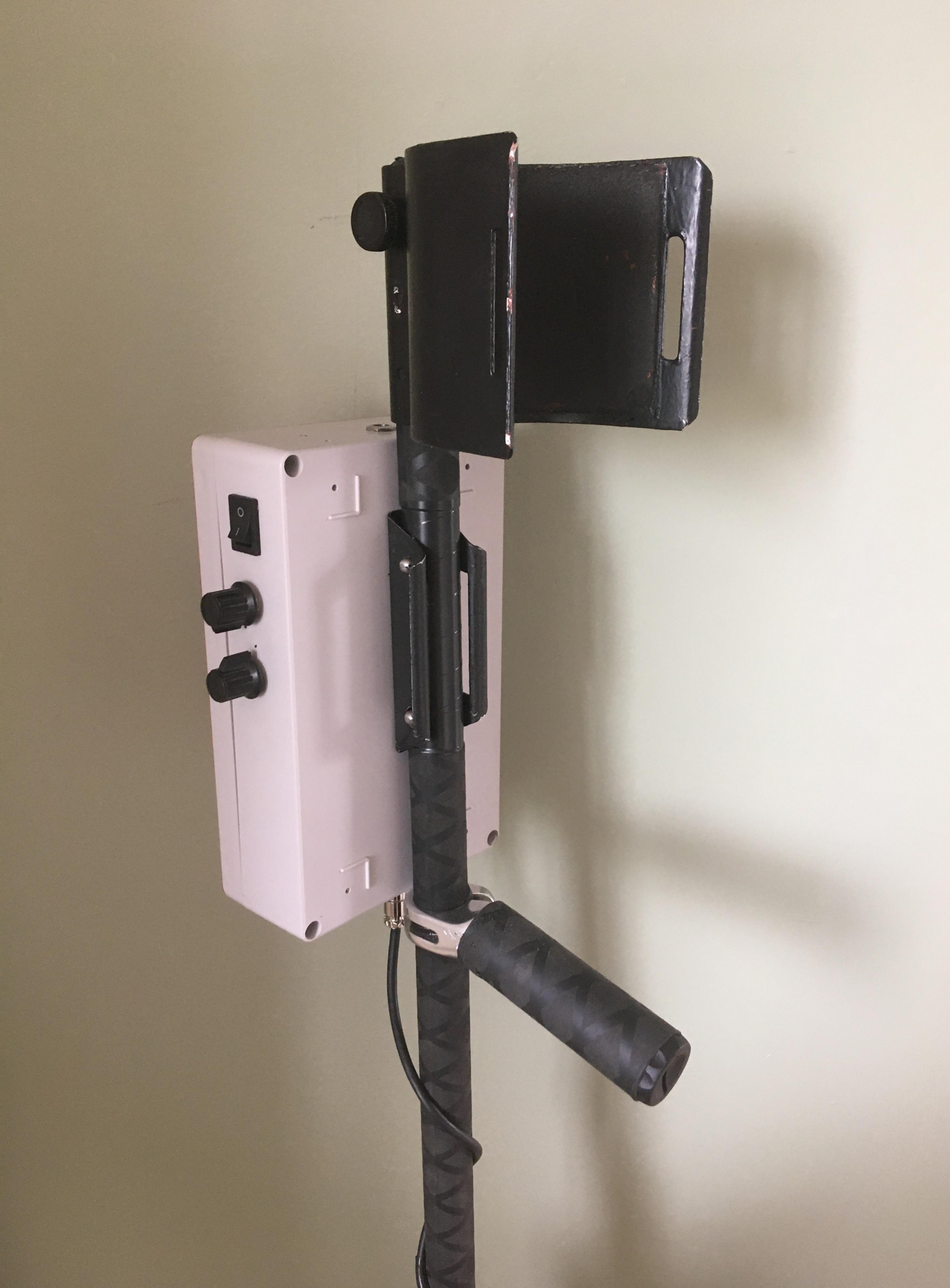

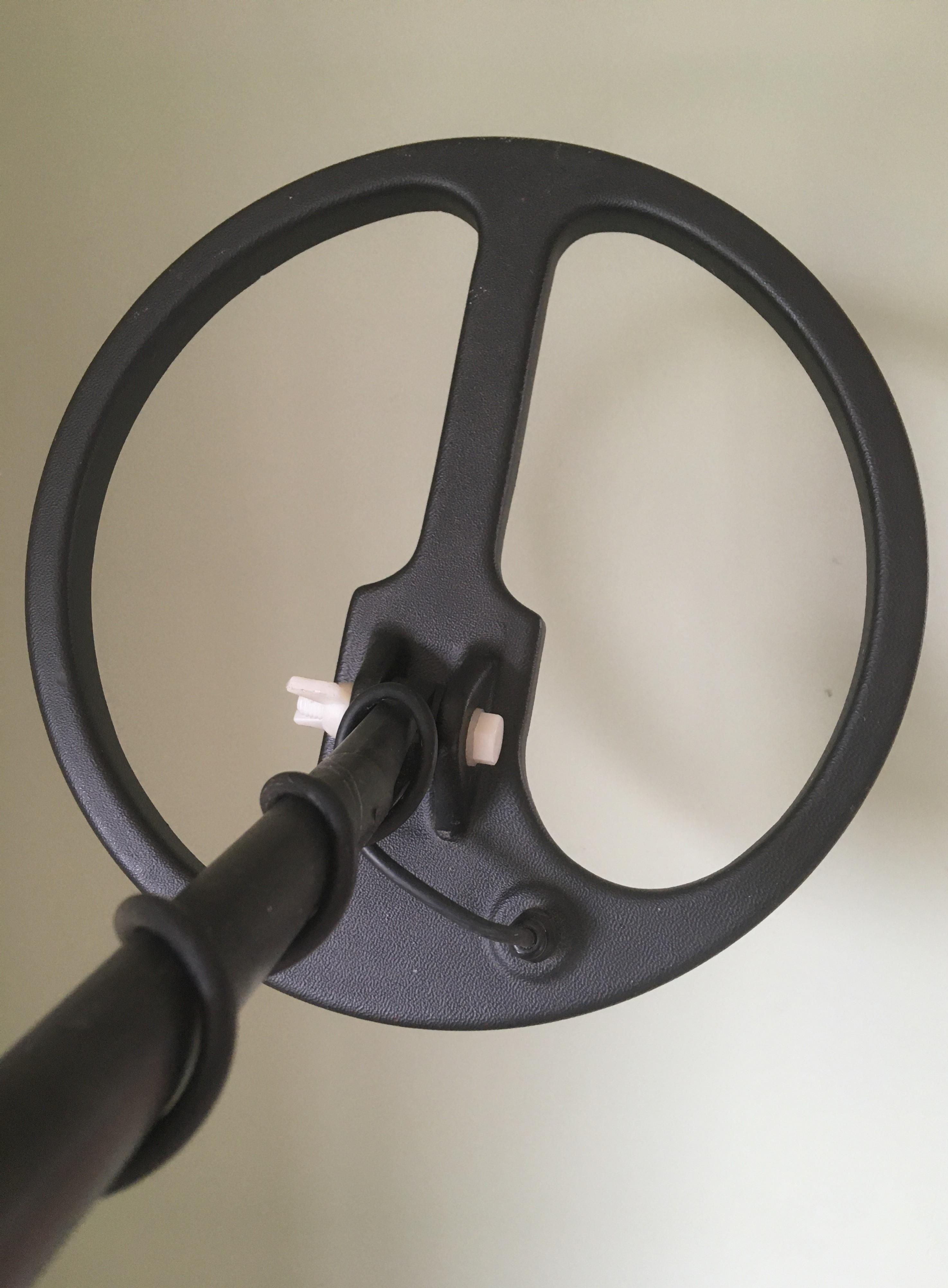

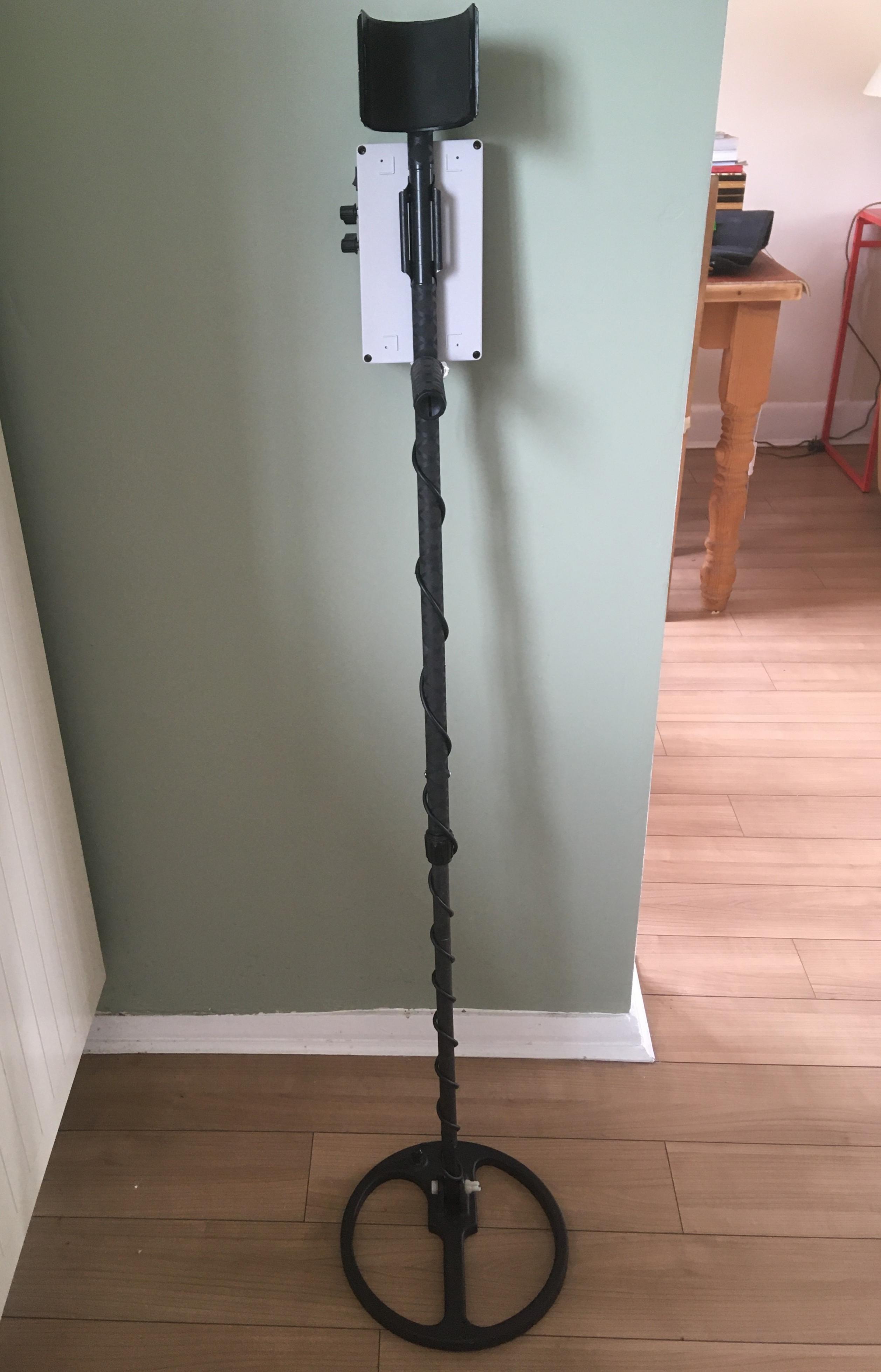

                        Thanks to everyone for their time and advice. Ive included a few pics of the finished project.

                          Otherwise great outcome. Congratulation and happy searching.
                            looks Good
                            happy hunting.
                              Great it is now fixed. Build looks very nice.
                                Not easy those Chinese script, I need always to check it again.
                                yup. mandarine is hard. i have to use his manradine in the logo... but not able to find (((
                                OOPS! this 'george'. 乔治
