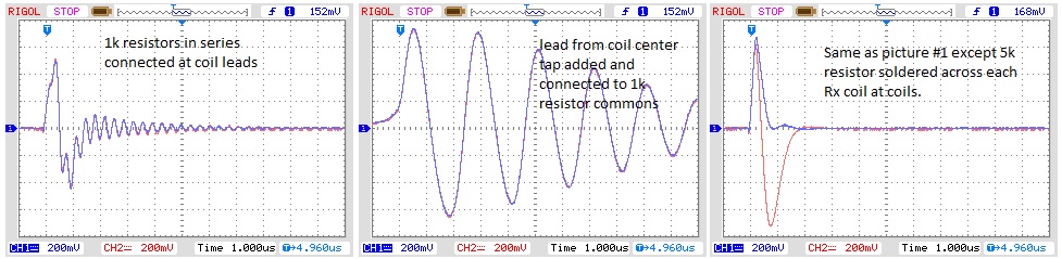

    Posted this scope picture in another thread. https://www.geotech1.com/forums/atta...6&d=1590432292 Wondering what is causing and how to minimize the oscillation. The coil(Rx two 8inch round connected figure 8, Tx surrounds Rx). Wanting to make a bigger one and would like to minimize the signal I'm seeing. Coil not connected to preamp in picture. Coil looks IB but 5mV difference in the two signals would saturate my preamp.
    Did you individually dampen each RX coil?
      Not with the Rx coil connected to the resistors only. Can't now because can't get to center tap. Will bring center tap out when I make the next coil. Tried connecting 1k across each figure8 coil when connected to the amplifier. Looking at amplifier out, signal as good with center open(2k across Rx). Didn't try with just the resistors(no amplifier). Was wondering if the two coil ends being the same phase meant anything. I do have another coil not potted I can play with. Suggestions for things to try? Does looking at coil just connected to resistors(no amplifier)with scope make sense?

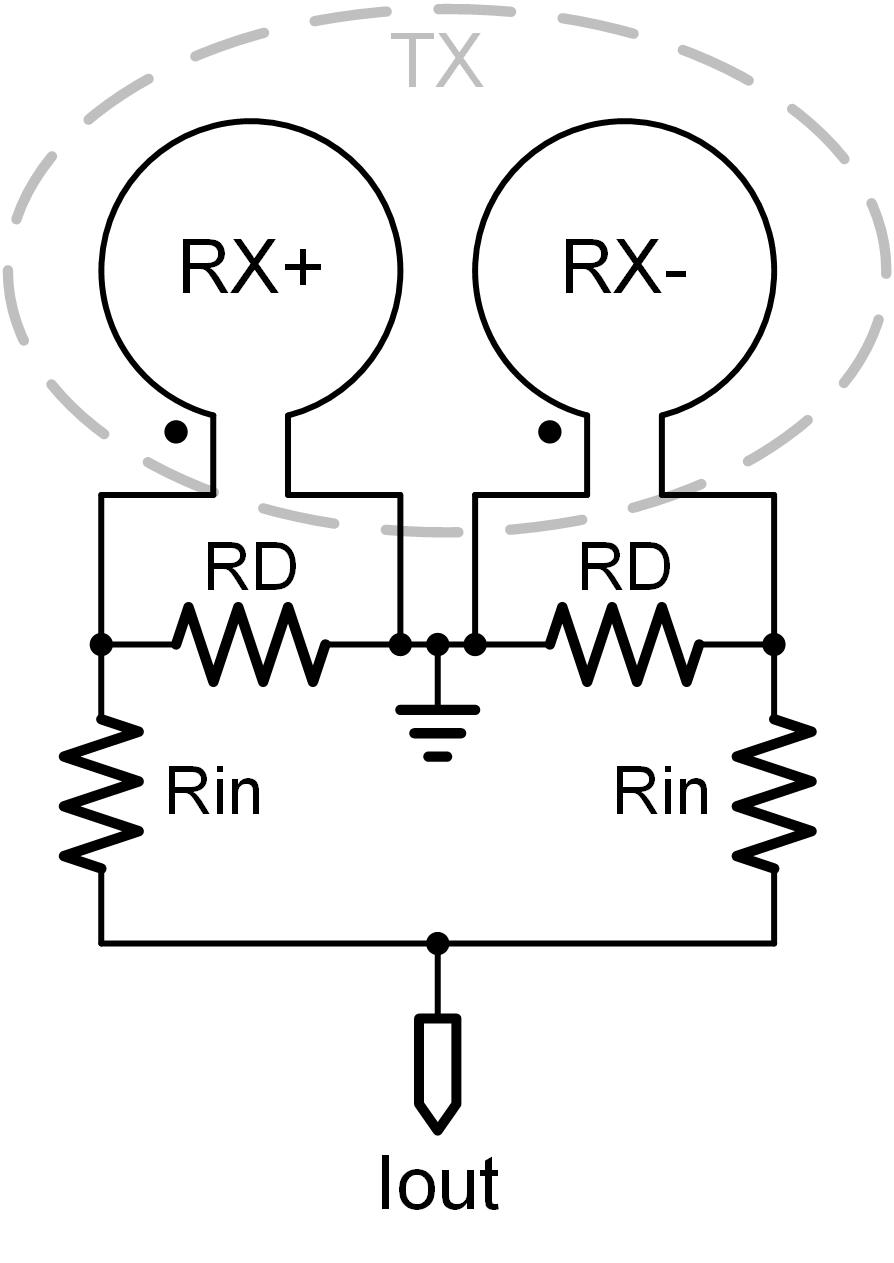

        I really need a drawing to fully understand how things are connected. But a Figure-8 RX needs to have each coil individually dampened because they tend to talk to each other. Here is how I do it in a walk-thru design:

        Sounds similar to what you describe except for the damping R's. The Rin's become the feedforward element in an inverting opamp.

          Drawing for coil same as yours. My scope picture, your Rd is my 1k. Scope ground leads connected to your ground. Scope leads connected to other ends of Rd in your picture. My first picture ground lead connected to Tx circuit ground, second picture scope floating from Tx. Playing with another coil same as above but not shielded. Will post some pictures when I learn something.
            Some scope pictures. First picture repeat of above test with same type coil not potted or shielded. Each figure8 Rx coil does need to be damped at the coils. Carl, thanks for the reminder. Learned at dual field thread but forgot. Amplitude less than what I got with shielded coil. Maybe shielding, Tx Rx spacing or something else I'm missing. Time to try the larger coil.
              Amplitude of what? A target signal, or the no-target residual?

                  No target turn off. Peak amplitude for picture(shielded coil)reply #1 is more than 10 times not shielded coil reply #6(maybe shield, Rx Tx spacing not the same or something else). Damping at the coil solved the oscillation problem so I stopped testing the not shielded coil. Rx connected to scope to see turn off, no amplifier so hard to compare effect with a target. Thanks again for suggesting damping at the coil.
                    First, your no-target amplitude is a function of coil matching, parasitic matching, and coil alignment. Less amplitude is better. Apparently your potted coil was not quite as good as the unpotted and, yes, shielding may play a role in that.
