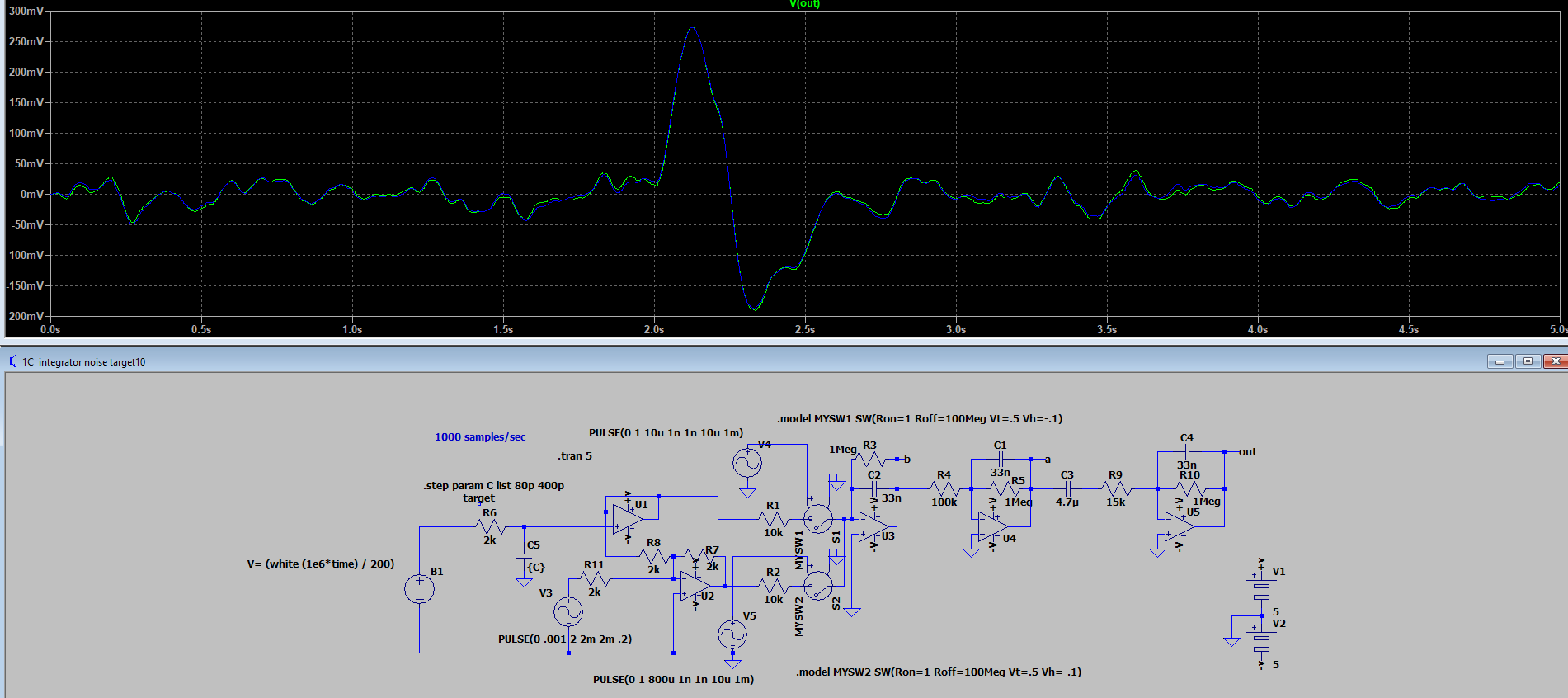

      I have been trying to get coil resonance and amplifier cut off around 1MHz. Probably needed for short tau targets, around 1us. For rings, coins, >1/2gram nuggets and longer tau targets maybe 200kHz is high enough. Tried an analysis in spice with white noise at 200kHz and 1MHz cutoff. Was expecting to see a greater difference. I like playing with spice but I'm a novice. Don't know how to tell the frequency of the white noise. Don't know if I should be looking at different cutoff frequencies. Planning to look at integrator or differentiator output with 1MHz and 200kHz amplifier cutoff with my bench circuit. Any thoughts on what I'm planning or should I be trying something different?

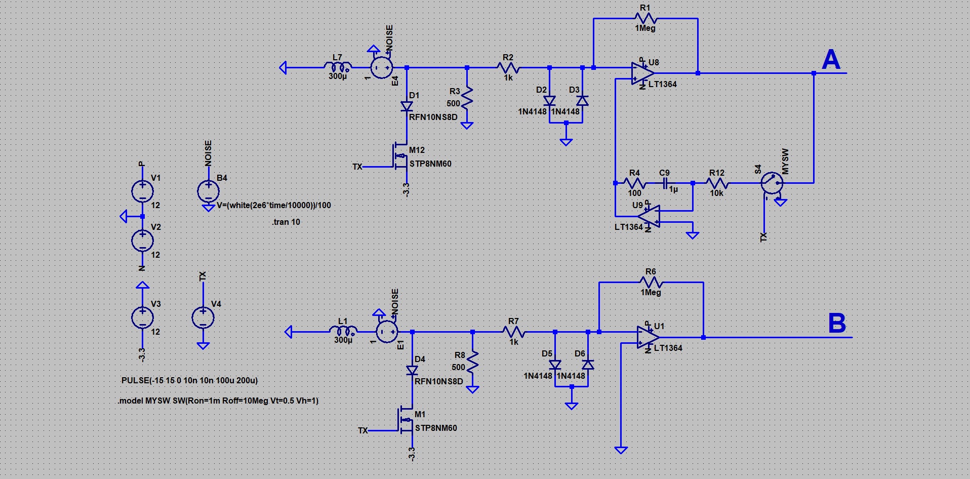

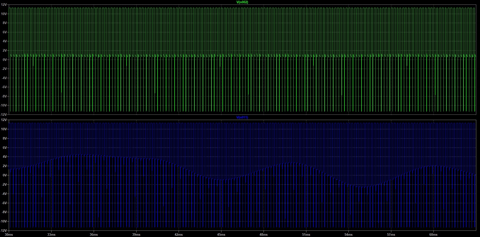

        The best noise mediation I have found is a demodulating feedback loop at the first amp .... works like a charm. No need to sync with the mains either.
        A is with noise removed
        B is with noise not removed ... ;-)

          Thanks for the circuit. Don't see why circuit would help with EMI or mains. Need to do some studying.
            That's a good solution for LF noise. One thing you rarely see in PI designs is any high-pass filtering applied to the preamp, yet it can be done and will help with LF noise. The feedback integrator is more elegant and let's you select what part of the signal gets applied for filtering.
            Paul, in practice do you sample the integrator during TX as shown in the sim? I would expect induced EMI to be heavily attenuated by the switch. Seems like you would sample just before TX.
                      Thanks Carl
                      I sample during RX not TX .... the way the TX is connected the sample switch is ON when the coil TX is OFF.
                      Attached the sim file below.

                          Thanks Altra ... this idea tries to prevent the low frequency noise being modulated onto the high frequency signal waveform before further sampling ... so you will still need additional sampling / hp / sat etc as Carl mentioned.

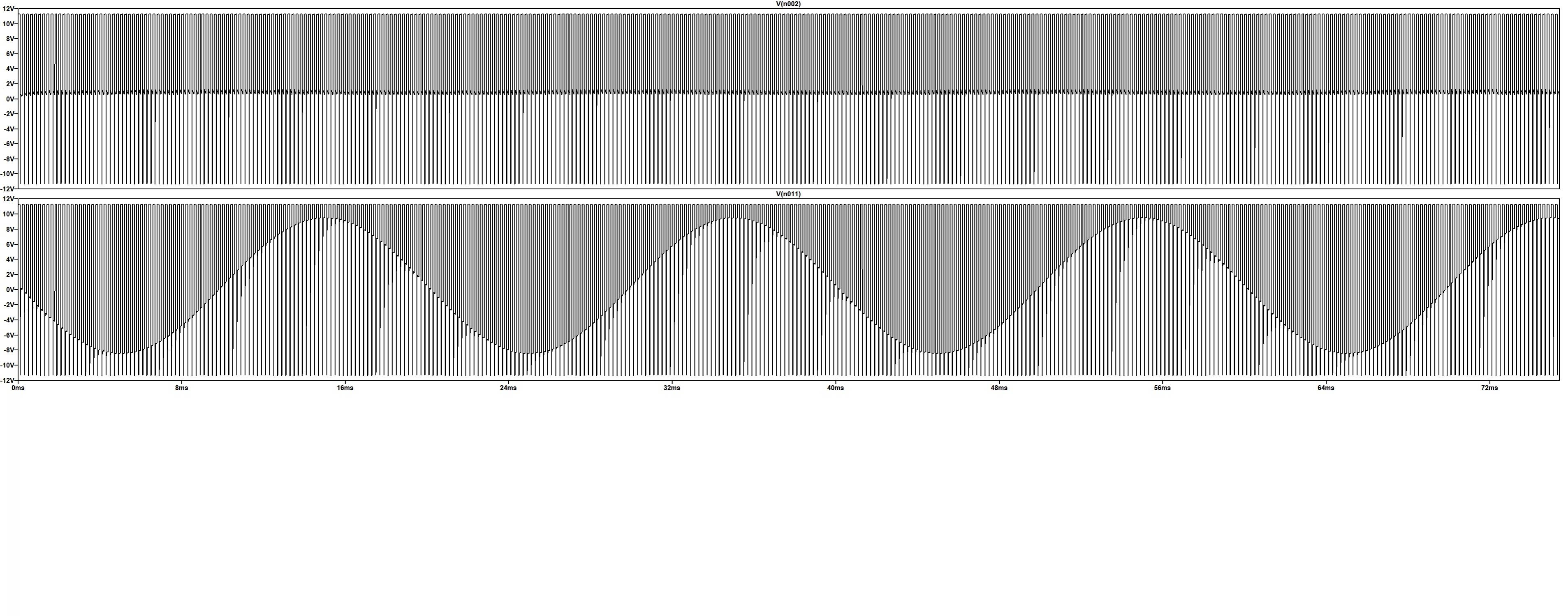

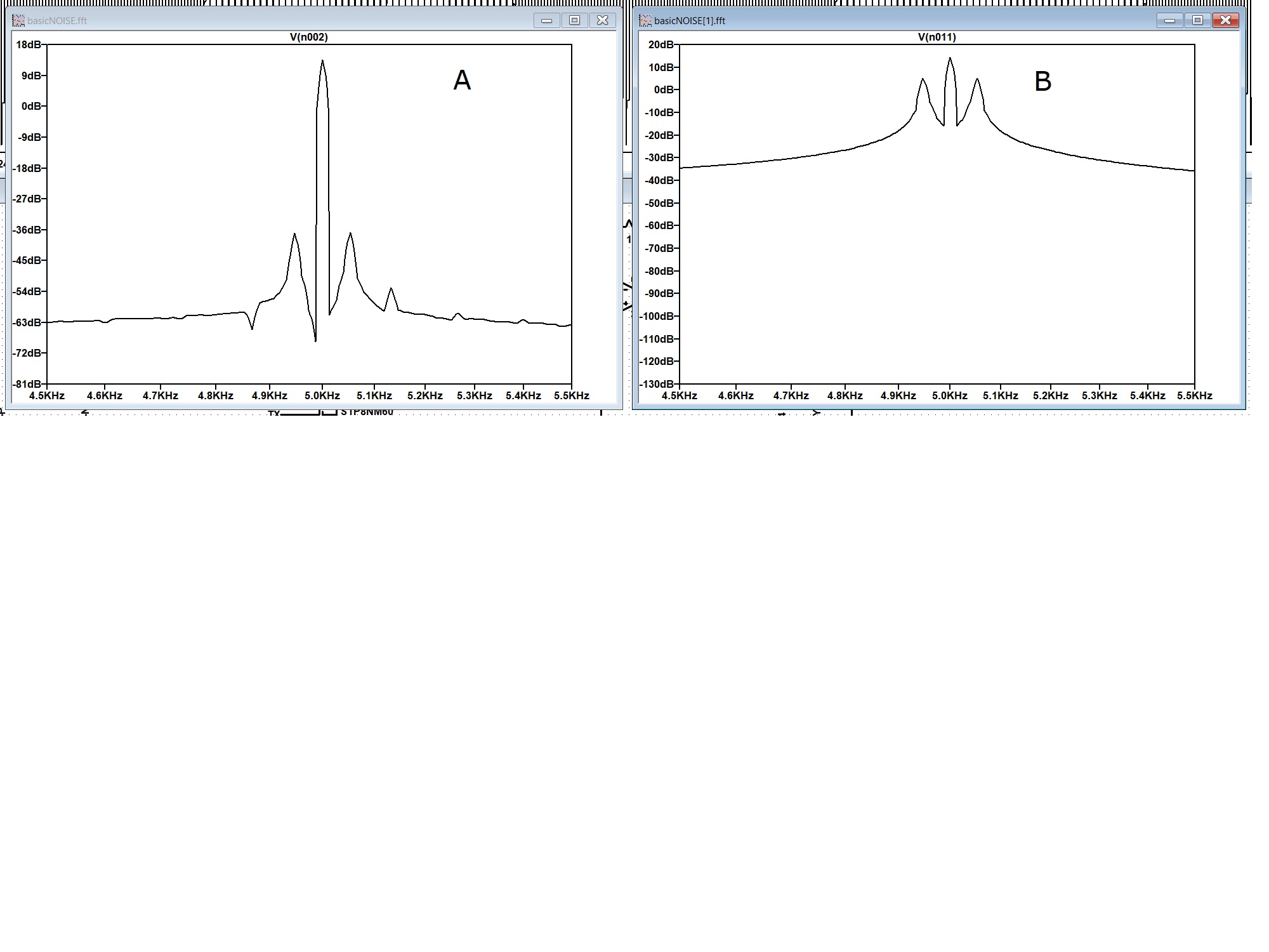

                            It is very important to realise that the low frequency noise will be modulated onto the higher frequency components due to the non linearity when the amp overloads due to periodic TX.
                            Below is a 50 Hertz hum of 10 mv at the coil for A and B and the spectrum plots at the 5 Khz component from the FFT of the A vs the B output .... you can see that the 50 hertz induced sidebands are reduced by around 40 db with this circuit ... better can be achieved.

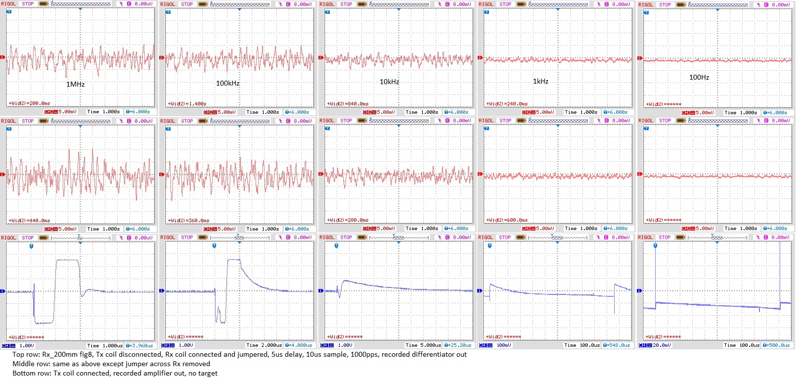

                              I would turn off the TX and try various preamp BWs, from 100Hz to 100kHz.
                                Some scope pictures. Recordings were made on the kitchen table. Don't see any LF(<100Hz)noise if I did it right. Anyone see anything that doesn't make sense?
                                capacitor was used to change amplifier cutoff frequency
