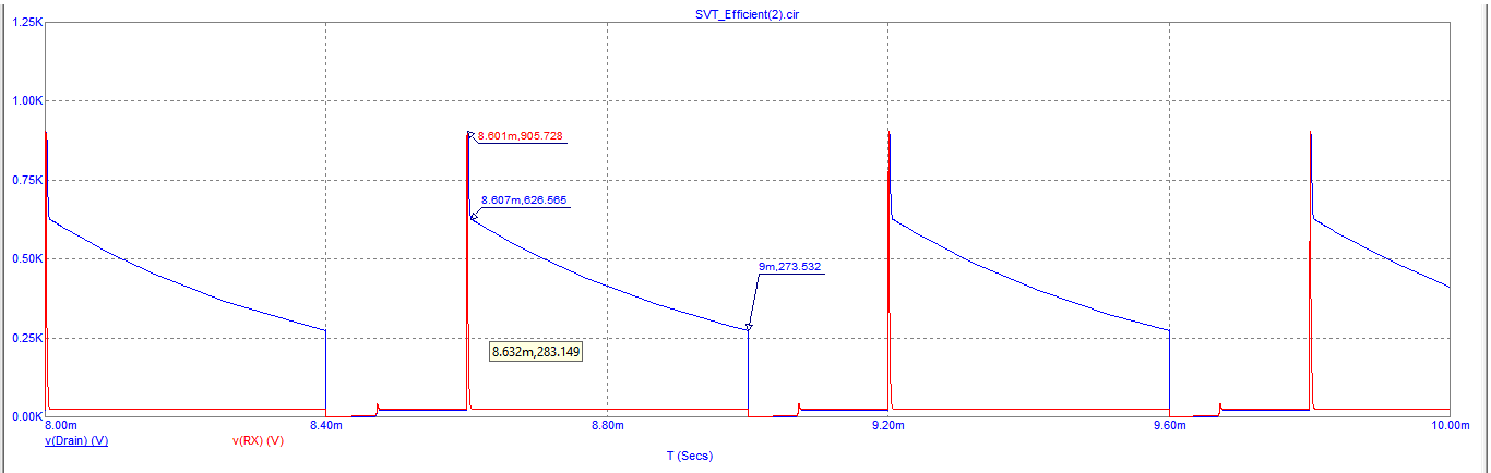

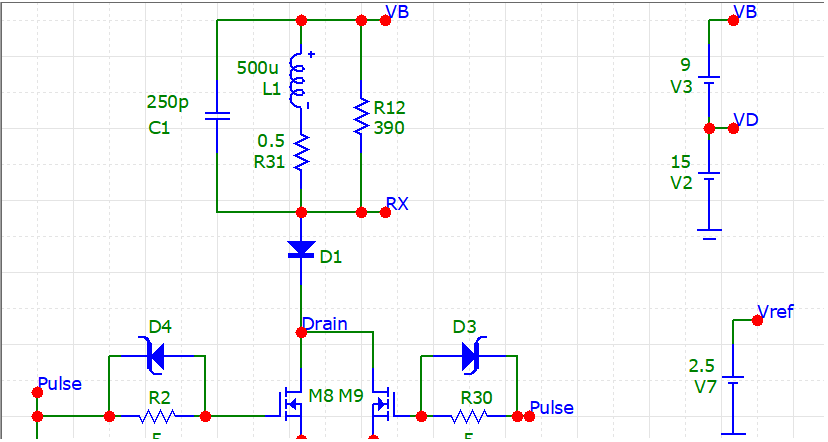

              A fast reverse recovery diode with low junction capacitance in series with the drain of you power MOSFET will reduce your overall solid state parasitic capacitance seen from coil.
              how?
              your diode capacitance will be in series with Coss of your MOSFET thus two caps in series, and I suppose you know what happens to the overall value?
              but the story has not finished yet
              since capacitors hold charge and there are two of them in series one smaller(diode) and the other larger(MOSFET) they're gonna trap part of the flyback charge and distribute between themselves after turn off, and the major chunk of this charge will be on the MOSFET's Coss obviously because larger capacitor eats more.
              that charge or voltage whatever you're comfortable with will remain there and part of it slowly discharges due to Leakages(Drain-Gate, Drain-Source, P-N, PCB) all the OFF time when you're busy with signal processing, now what that remaining charge does is it will put these P-N junctions in Hard reverse bias which will decrease their capacitance by orders of magnitude (good news).
              for example your typical MUR460 will have around 100pF for 1V of reverse bias but for 200V it'll be lower than 10pF which is great.
              circuit
Name:	Diode Effect.png
              blue trace is Drain(where you trap the charge)
              Red is RX
              as you can see the blue trace basically starts at 626V and discharges down to 273V in 400us
              you may say why doesn't it go all the way to the 900V flyback then decay form there?
              the answer to that is my MOSFET can take 900V flyback but not my 600V rated diode hence starting form there, the blue trace actually does go to 900V for a moment but diode breaks down fast and continues from 600V
              if the MOSFET was 600V as well then the flyback wouldn't go that far.
