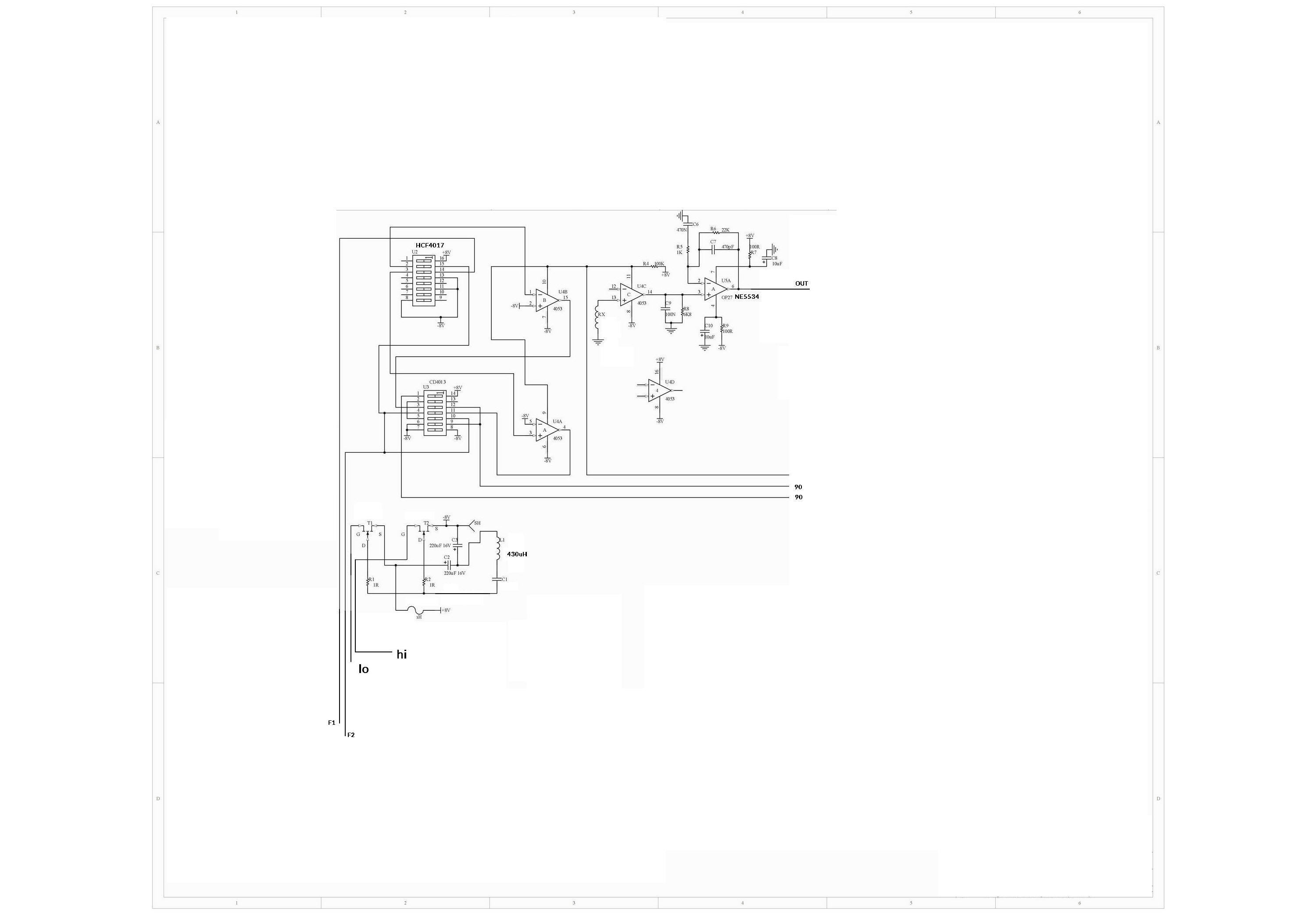

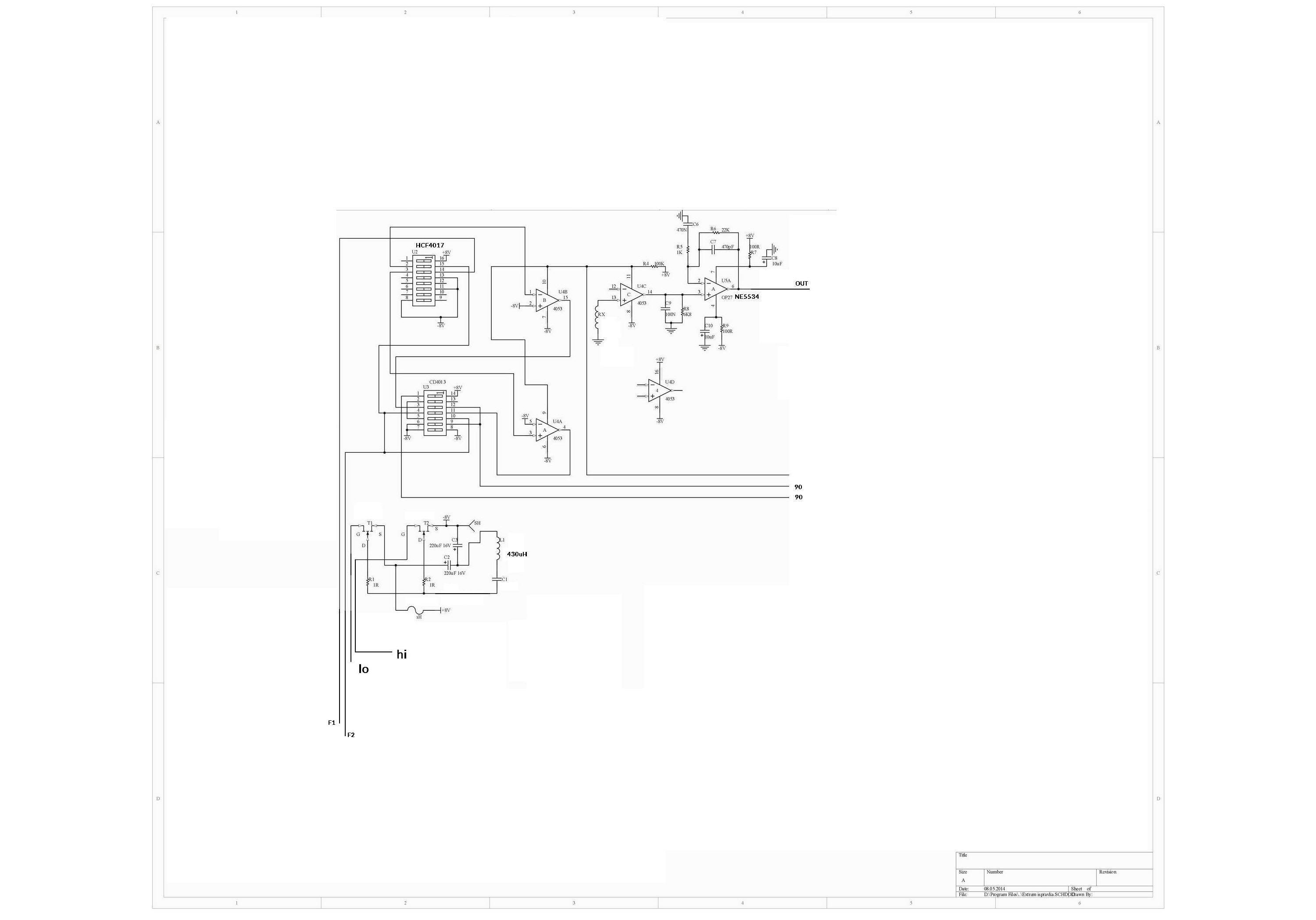

                        You are right, I didn't remember his quote. But I did remember his schematics in the first post and there are no capacitors in series with the coil. Maybe he has a secret THS system that he didn't post or he didn't read the patent? Anyway it's not important "Who's" is better.

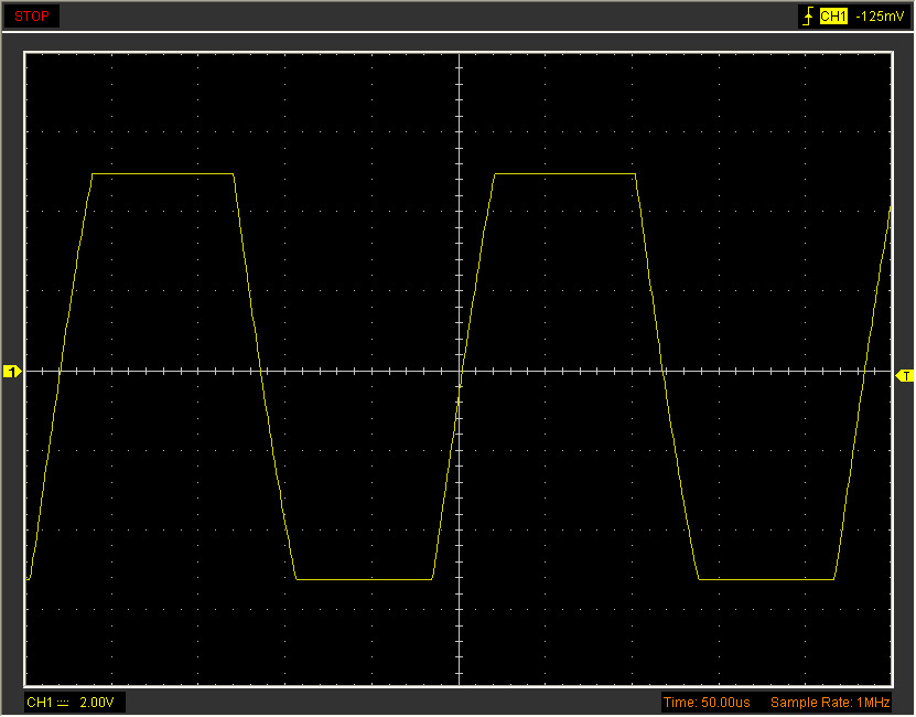

                          My experiment promises for now...Click image for larger version

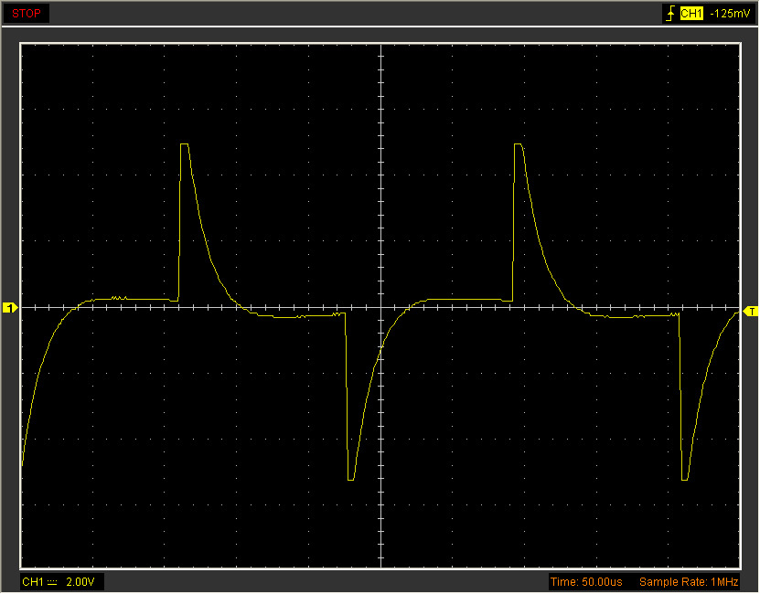

ID:	357816with a little finishingI think Alexander hides things about his new TX design!Click image for larger version
                            Bi.Polar .VLF
