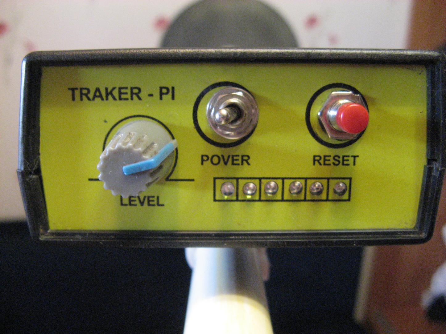

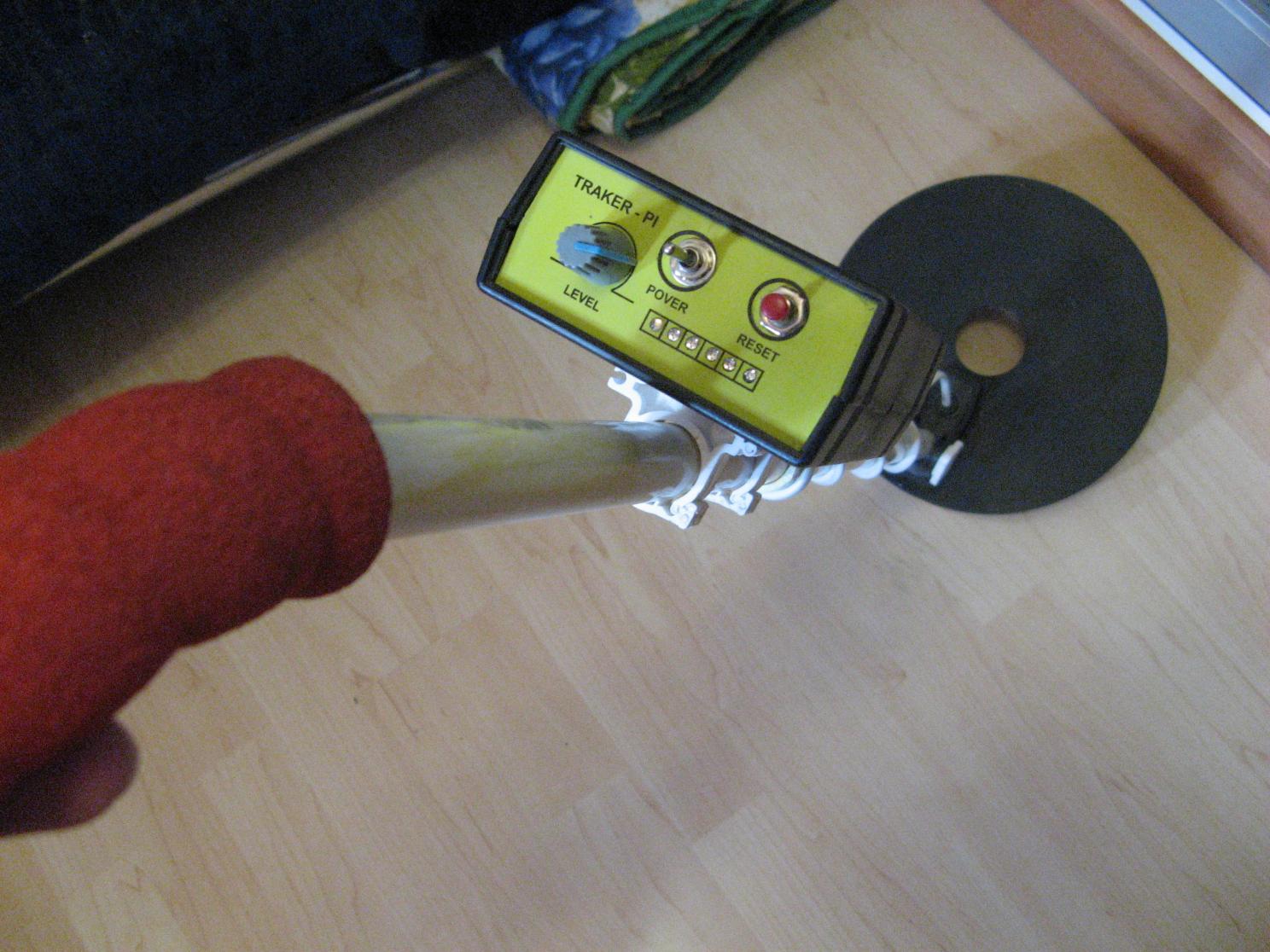

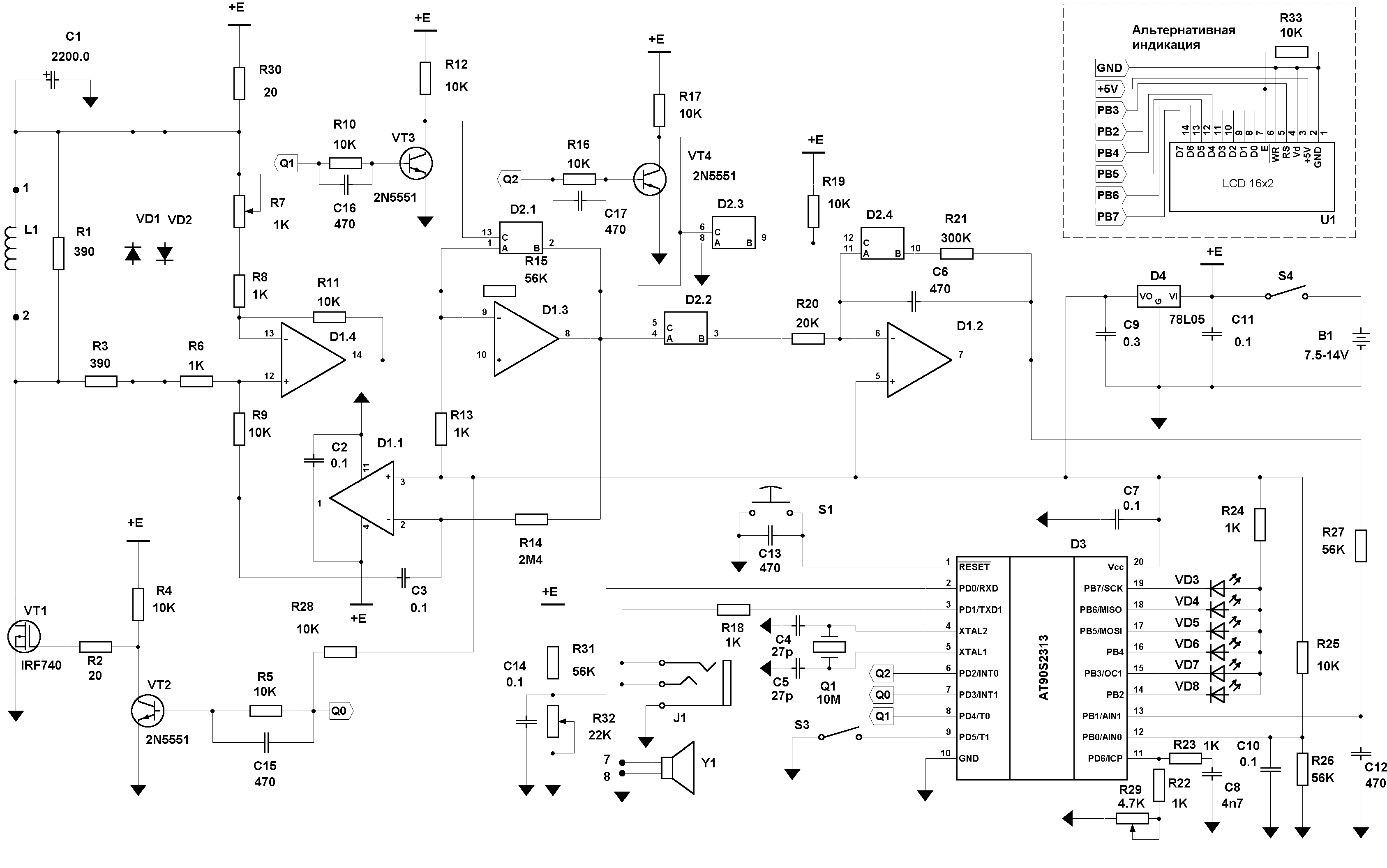

                first of all, you need to shield an enclosure. second, put a pot in preamp pin, look schematic. by this pot you have to tune detector on maximal
                sens. it is famous trick in russian part of the net.
                the detector on pics is not mine. you have to see the pot on the box.

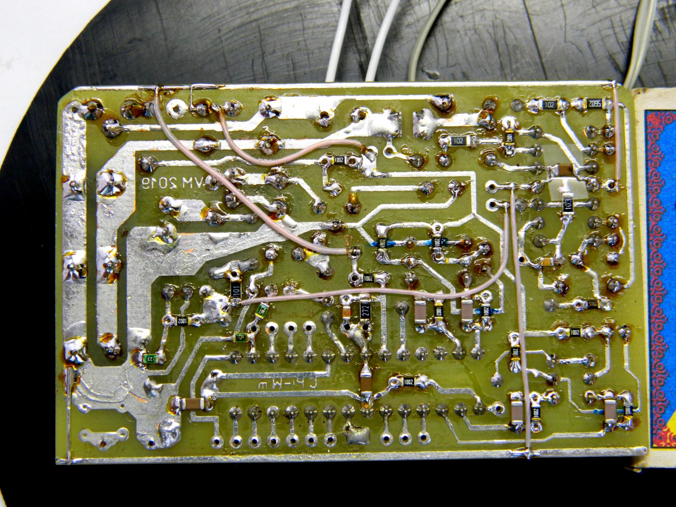

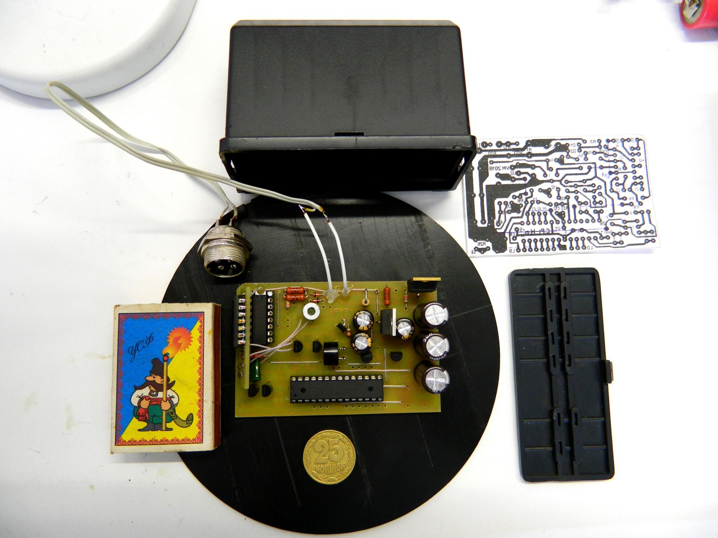

                  this page from old deleted site. i converted it in DJVU format, for universal reading. read FAQ part.

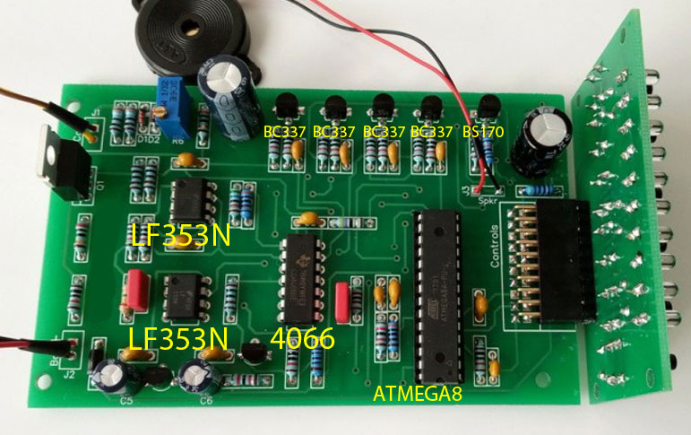

                    Actually my Clone PI-W has nothing to do with the schematic you uploaded kt315, it is a board that I've bought (pre-assembled) from an e-shop.
                    I don't even know If I can even call it Clone PI-W because it is run by Atmega8 and it has 2 X LF353N and 1 X 4066, no XTAL or anything else on the board..
                    I guess it is a modified version of the Clone PI-W and I don't think there is any solution in the detection range, the current draw is 65-75mA based on the manufacturer.

                    I don't have a shielded coil or enclosure but even on bench tests it really sucks big time, with a 60cm coil it can detect a 35cm oven-pan at 80-90cm with the barrier setting on 2/6.
                    During the initial start up all LEDs go out so I guess this MD it just isn't up to the task.

                      i said about just PREAMP, not about whole schematic.
                      read my posts more attentionally.

                        If you mean the 1k pot that is next to the two 1N4148 diodes (look at the picture in my previous post), I have already maxed it and the detection range remains almost the same with very little difference.
