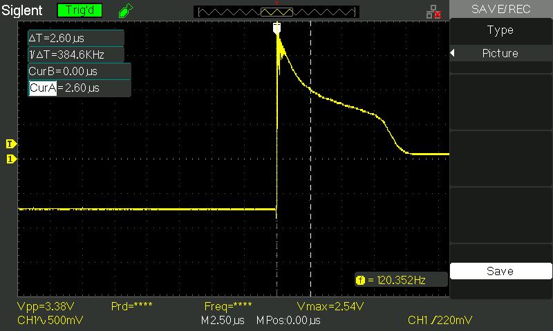

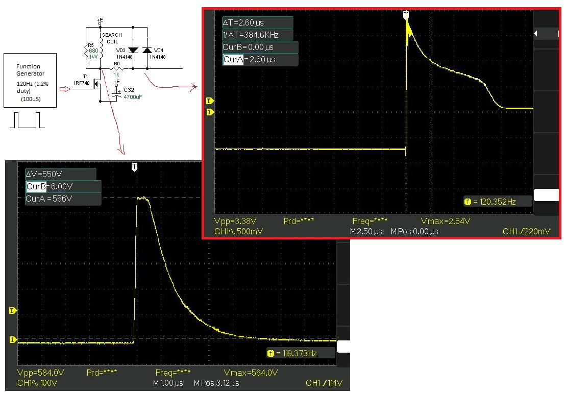

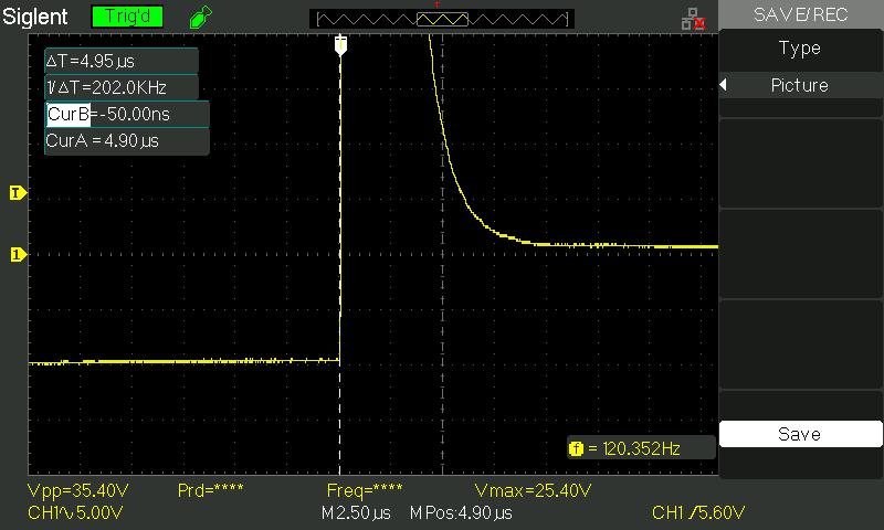

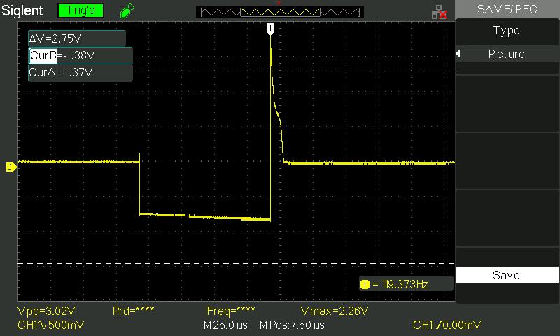

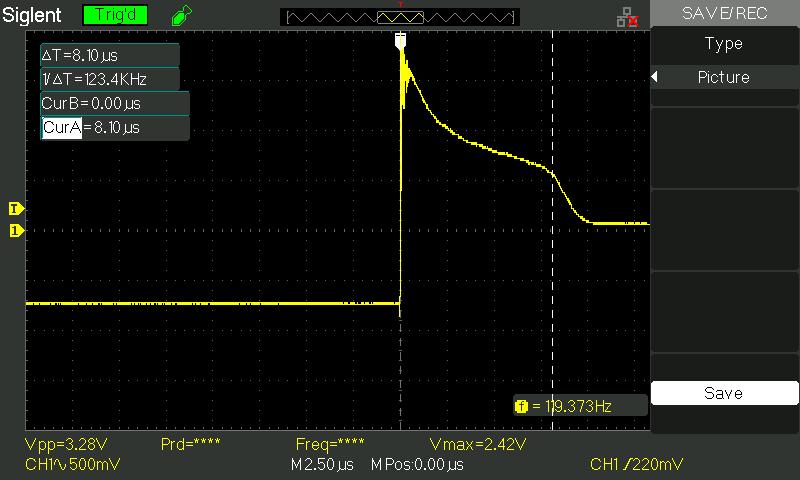

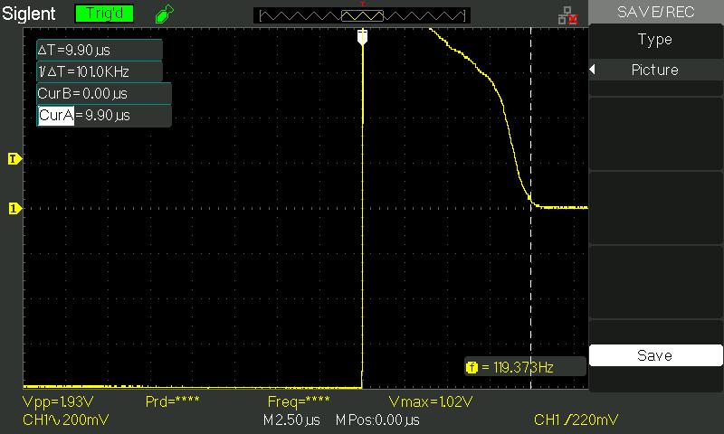

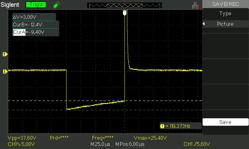

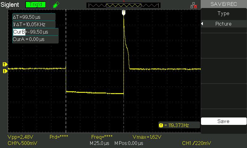

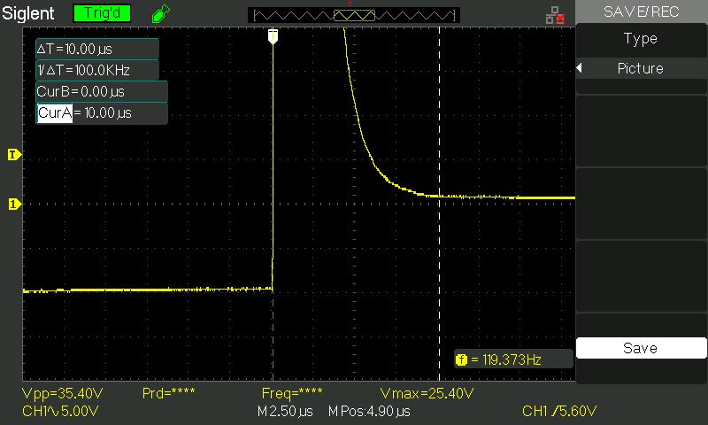

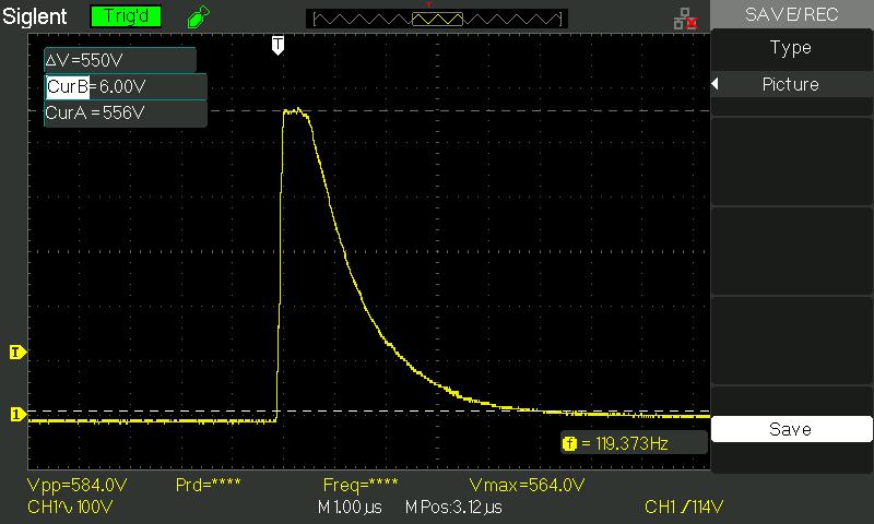

    I made the coil and the parameters are these:
    25 cm, 25 turns, 0.5mm wire -> 506 uH, 2.0 Ohms

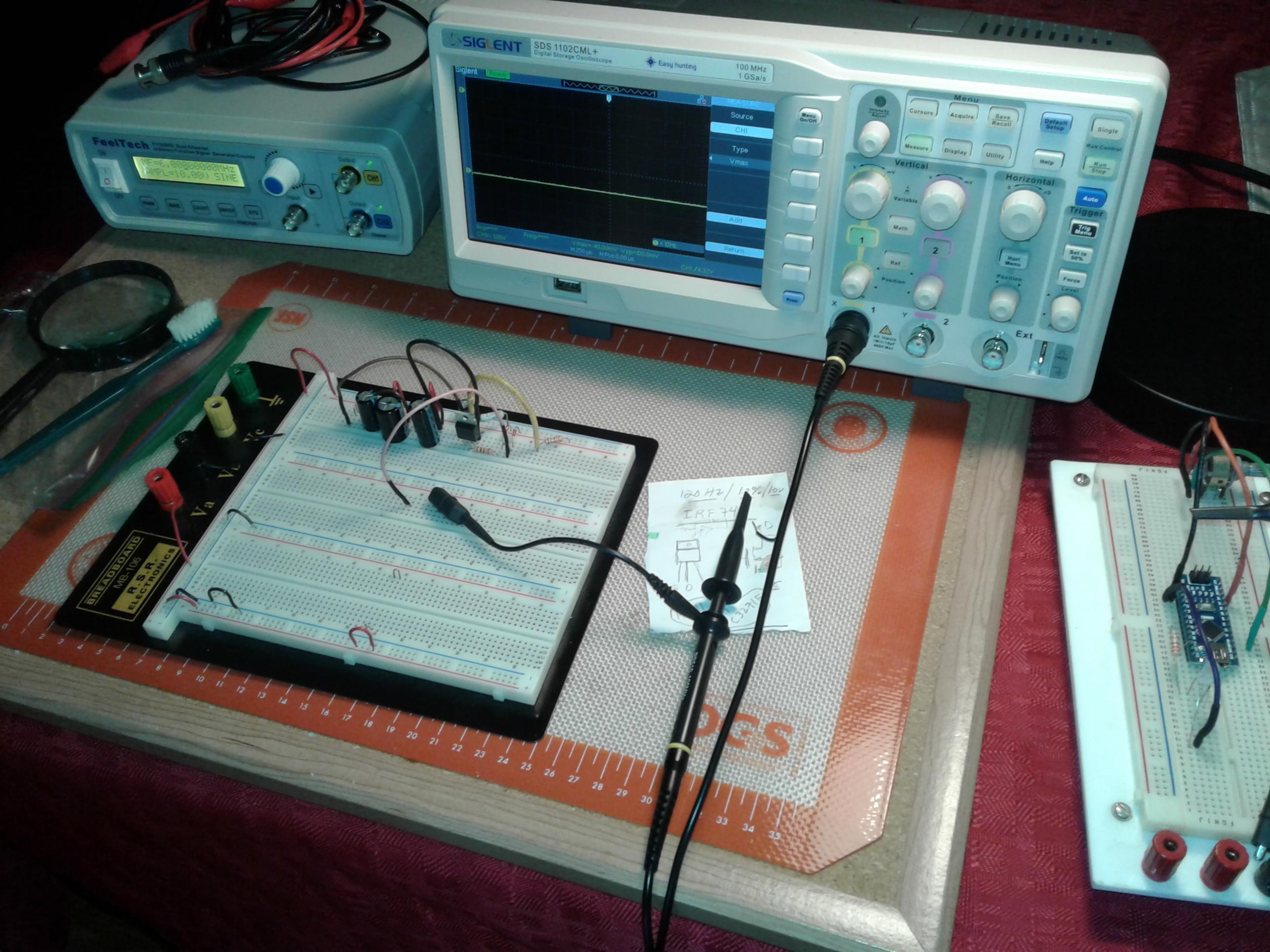

    I have use a breadboard to test the driver circuit (timer + power). I used a function generator to created a pulse at 120Hz (1.2% duty) ~100uS (signal positive 10V pulse width)
    Basically I would like to have a first step/part like the Delta Pulse (IRF740 + LF357/TL071).

                Disregard the Linux question (I lack sleep ), give us at least some details about the project, what makes it different than other projects and generally any hint would be helpful, oscillographs don't say much.
                  Just want to use some power driver part... like the one from Delta Pulse + first op and take that as input to a PIC I can manage only with software.
                  But would like to have something stable/good in the first module.
                  I loaded the oscillographs and the coil parameters to start looking for a good reference after feed the signal in the PIC (Arduino Nano or Mega2560, which I already have).

                      I have bought a couple of devices to start this hobby, also a multimeter (VC97A) and a DC power supply (30V 5A) :-)
                            Nice equipped lab to start with MD (you should show VC97A, that is somewhere in background, and PS too).
