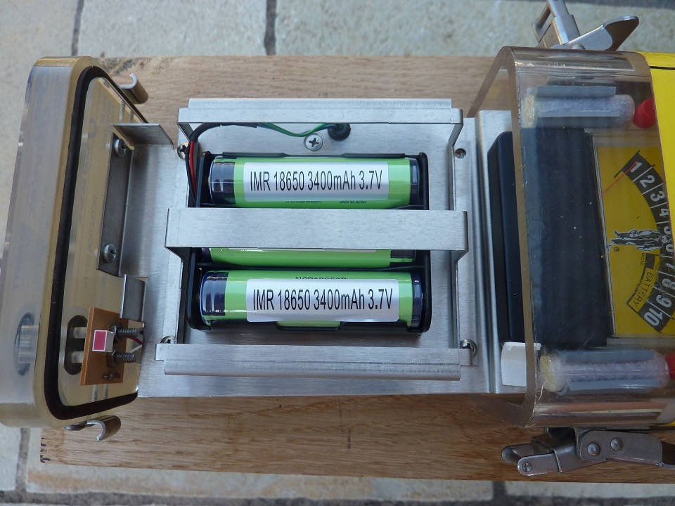

    Two jobs done so far. First was to change the 7 cell Nicad pack for something better and lighter. Now I use 3 Li-ion cells which are half the weight and much bigger capacity. I've used protected cells to avoid draining them if the detector is inadvertently left switched on. Charging circuit needs to be changed too. The electronics at the moment draws 150mA so the added capacity will allow running at a higher rep rate to speed up the response which is a bit slow at present. TX pulse width is 200uS so I will look at increasing that too. Mosfet will be changed for one with a lower Rds.on and a series diode. I will remove the IC's from the RX chain and put in sockets so that alternative devices can be tried. Several other things could be changed but this will do for the present. Oh yes, I changed the twisted wires from the coil socket to a miniature coax. The problem with this case is that the connector is on the bottom and very close to the pcb pads for the coil. To withdraw the electronics for testing then requires a long internal cable if the same connector is to be used.

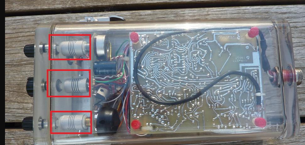

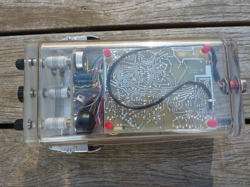

          Where can I find these waterproof potentiometer shafts? Looks to be a standard part I have the same on the JW Fishers 8X.
            The part in the red box is purely a flexible shaft coupler. The primary seal is the ring which sits in a groove within the top plate to the left of the red boxes. The 1/4in shafts from the knobs and into the couplers are stainless steel, but it does not matter what metal the actual pot and switch shafts are made of. Could even be plastic. There is an additional seal between the control knobs and the outer surface of the top plate which consists of a nylon washer under the knob and an O ring against the top plate surface. How the O ring groove in the top plate holes are machined I do not know. It also appears that those three O rings are square section.

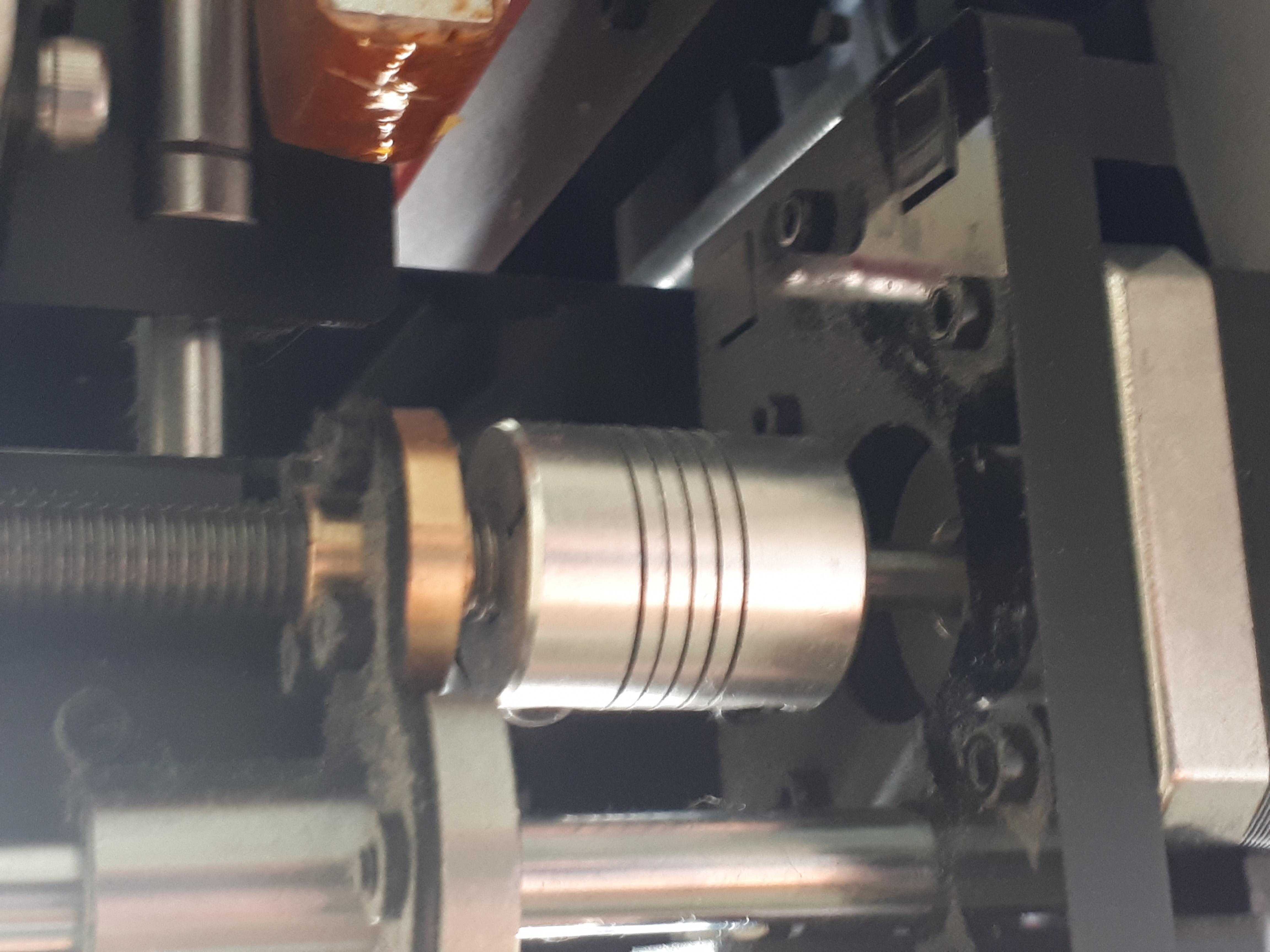

                Those flexible shaft coupler's are also used on 3D printers if you search on ebay on
                "3d printer couuplings" you will find lots of all sorts and cheap, you can drill them out to match the pot shaft.
                  I thought I'd seen those somewhere before. Here's one on my Geeetech i3 Prusa.
