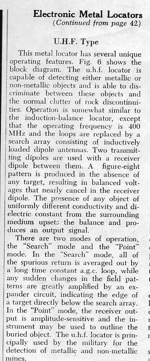

      Attached is a description of the workings of the UHF detector. Click image for larger version
ID:	358291 This is from an article in the Electronics World magazine for December 1966. There is no indication of how small a metal object can be detected and I don't know of any actual devices that work in this way. You would think that developments of this technique had progressed since 1966
      The resonance method might be worth investigating and, as you say, a frequency sweep method and a spectrum analyser for a Rx display. Objects at resonance should appear as a spike on the display.
      Eric.

                      I found this on the internet but, as yet, not the article. I can copy mine and send it as it is very interesting considering so long ago. Eric.
                      Lancaster Donald E. Electronic Metal Locators, Basic Types and Design Factors Electronics World Dec. 1966 pp. 39-42 and 62. excellent revievs of operating methods (no P.I.), good text, many block diagrams

                          Extracted:
                          • #58
                            Thanks. No wonder I couldn't find it, as it was in the American Electronics World version, not the UK one.
                            • #59
                              It is not best possible copy, yet good enough for overview.
                              If it was of a grater value for me; i would pass it through the OCR and make proper fine document... but is not.
                              OCR is not perfect and sometimes demands additional labor.
                              That's why i processed only part of the last page, which interests WM6 mostly.
                              (Continued from page 42)
                              U.H.F. Type
                              This metal locator has several unique operating features. Fig, 6 shows the block diagram. The u.h.f. locator is capable of detecting either metallic or non-metallic objects and is able to discriminate between these objects and the normal clutter of rock discontinuities. Operation is somewhat similar to the induction-balance locator, except that the operating frequency is 400MHz and the loops are replaced in a search array consisting of inductively loaded dipole antennas.
                              Two transmitting dipoles are used with a receiver dipole between them. A figure-eight pattern is produced in the absence of any target, resulting in balanced voltages that nearly cancel in the receiver dipole. The presence of any object of uniformly different conductivity and dielectric constant from the surrounding medium upsets the balance and produces an output signal. There are two modes of operation, the "Search" mode and the "Point" mode. In the "Search" mode, all of the spurious return is averaged out by a long time constant a.g.e. loop, while any sudden changes in the field patterns are greatly amplified by an expander circuit, indicating the edge of a target direct below the search array. In the "Point" mode, the receiver output is amplitude-sensitive and the instrument may be used to outline the buried object. The u.h.f. locator is principally used by the military for the detection of metallic and non-metallic mines.
                                And it was right here on Geotech the whole time:
                                https://www.geotech1.com/cgi-bin/pages/common/index.pl?page=metdet&file=info/lancaster/index.dat
