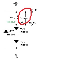

        this capacitor ( 10uF, 16v) found faulty. what else should I check ? Can anybody advice ?
          strange for me. but its possible if you use 1N4148 vd8 vd9. you must check them.
          i changed in my design them on 1N4001...06 because chinese diodes are lowcurrent crap.
            Today I checked 1N4148 diodes & also changed them with 1n4001 as guided.
            checked all ICs vCC & GnD power. its around 10.77 to 10.78 volts. Theshold pot (in auto mode),Tuning( on manual mode) seems working fine as I can hear sound(tic tic) from speaker.
            Also checked the D3 & D4 diodes, seems OK. But there is no detection happening on coil. what might be faulty ? is it the IRF840 MOSFET faulty or any any IC is faulty?
            Can somebody help & guide me ?
