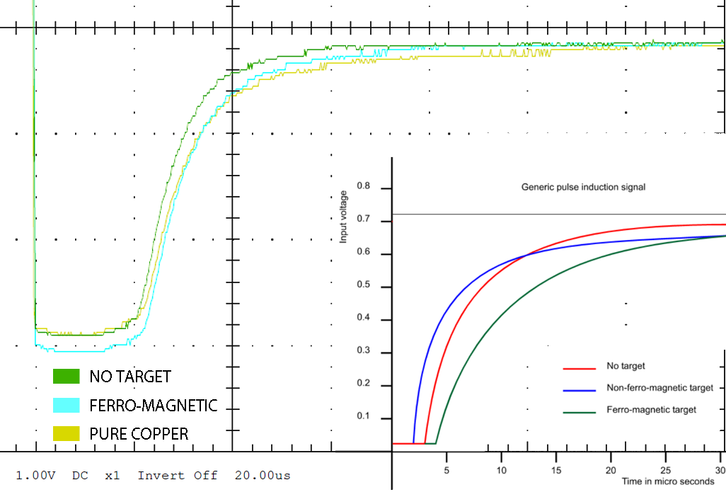

    Hello I found this article ( https://www.lammertbies.nl/electroni...metal-detector ), it talks about the exhaust curve with ferrous and non-ferrous targets.
    So I tried to do the same with my SurfPi 1.2, I read the preamp output, but I don't find correspondence with article, where am I wrong ?.
    I used a piece of iron and a piece of pure copper (same size), placed them in the center of the coil and read the output. In the article the non-ferrous targets were found to decay before the no target curve, but during my experiment don't work in the same way. Why happen this??
    where am I wrong ?
    You are not wrong. Yours is the better one.
    What you see on your traces, is the faster initial decay of the magnetic part of the iron and the slower decay of the resistive part of the iron. This is why the iron decay curve crosses over the copper curve.
    The decay curves we see on a PI, are compound exponential decays. That means there are several exponential decays superposed.

      What this clearly demonstrates is that this method cannot be trusted to provide accurate ferrous / non-ferrous discrimination, except in a carefully controlled environment with a small set of specific targets.
        Thanks for your answer. What I didn't understand is why in the article the NOTARGET curve was in the middle of the two curves and in my experiment it was always above.
        I am studying discrimination in the Pi and I started following this path, because it would be the simplest and fastest, but I agree with you, Qiaozhi, that this method is not reliable, especially due to the many variables that come into play such as: the size of the object, shape, orientation, distance from the coil.

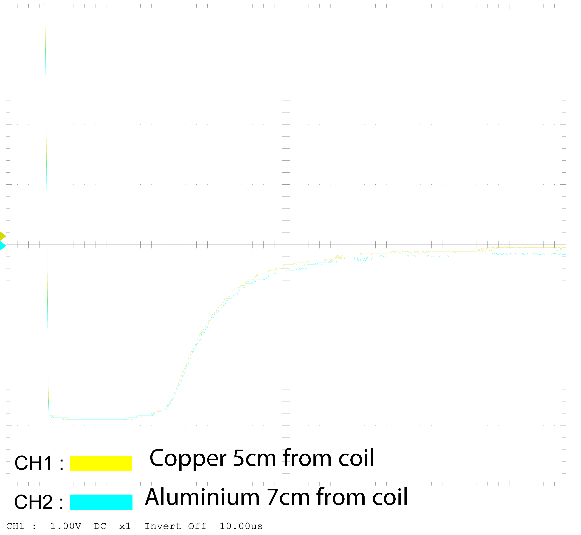

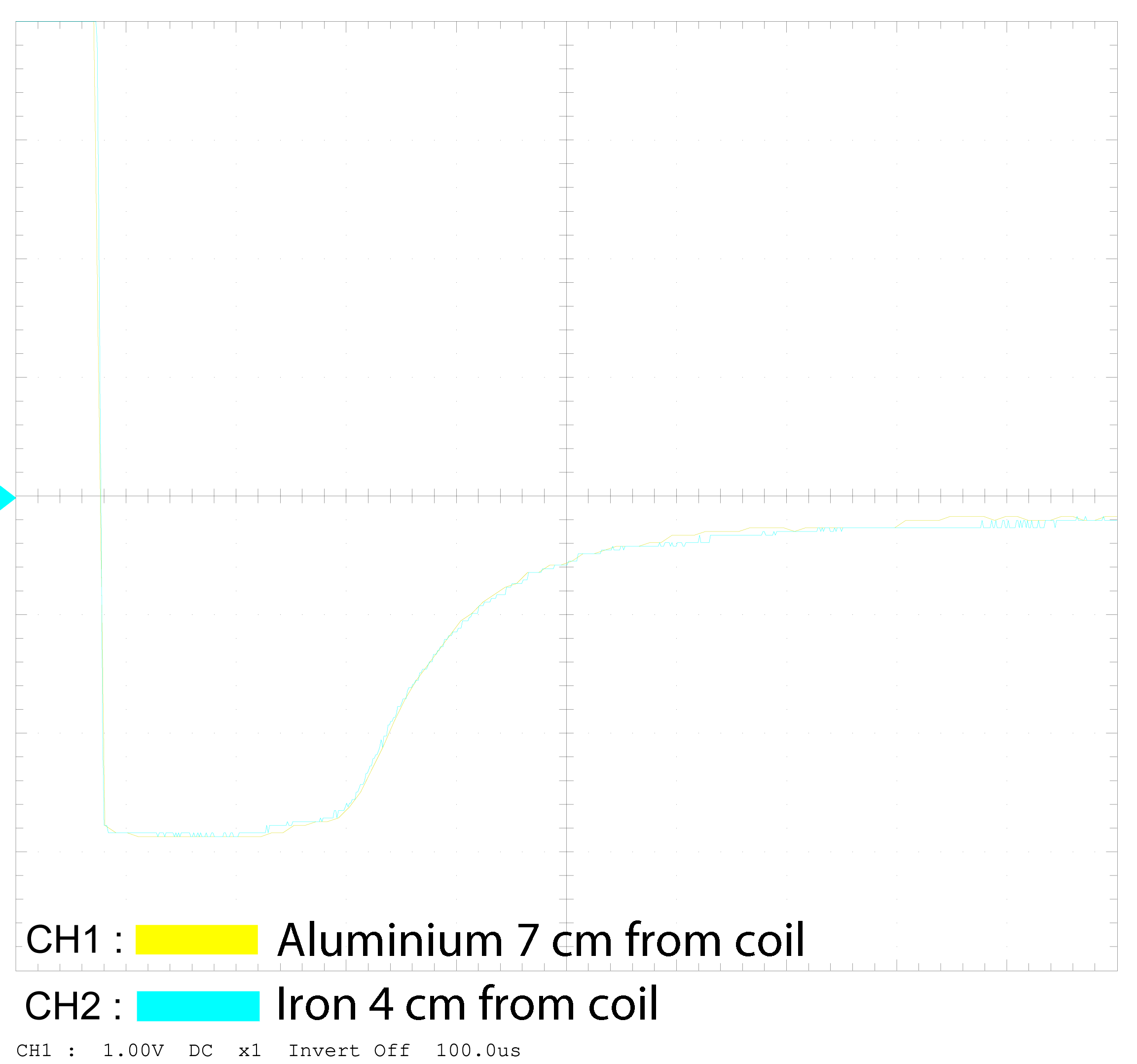

        I did a test by simply varying one of these variables, the distance from the coil, and these are the results.
        I will try the way of different frequencies as in the SD2000, I will start by studying the circuit, then trying to realize it in an analog way, and then in case manage it through a microcontroller.

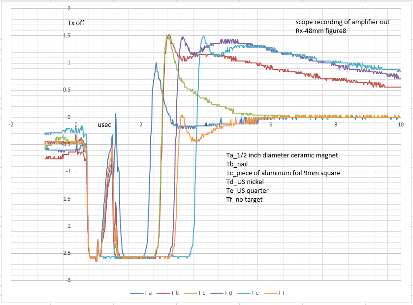

            Was never able to see effect with a mono coil. Can see with IB coil. Foil and no target peak at same time. Nickel and quarter go negative before going positive(non ferrous target signal is opposite during coil decay). Nail and ceramic magnet go positive(ferrous target signal is same polarity during coil decay). Hope I explained it right.
            Looked at chart again. Think I should have kept recorded signal from over scaling. Tried recording without over scaling, trying to make sense of it.

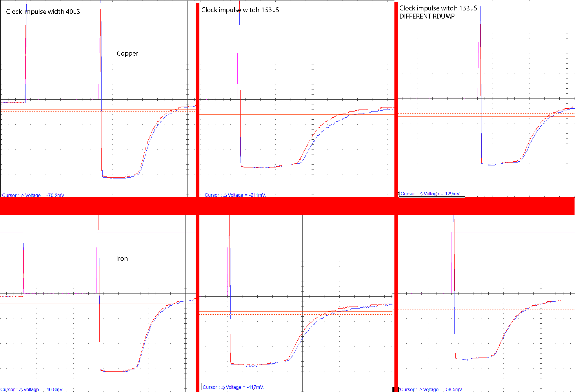

              I tried to see if anything changed with different pulse widths and different RDump values. The attached photo shows the result of my observation.

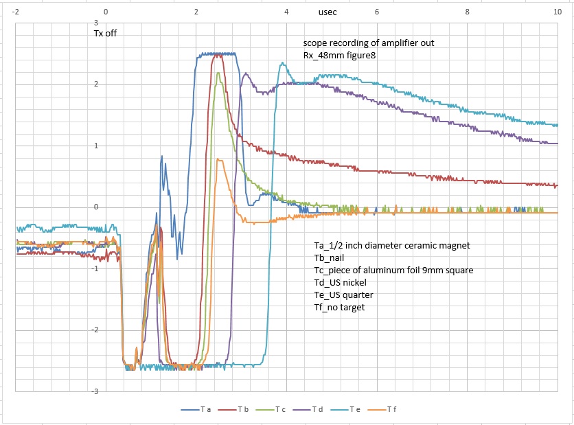

                Traces without over scaling. US quarter appears to be only target that went negative before going positive. I'm confused again.
