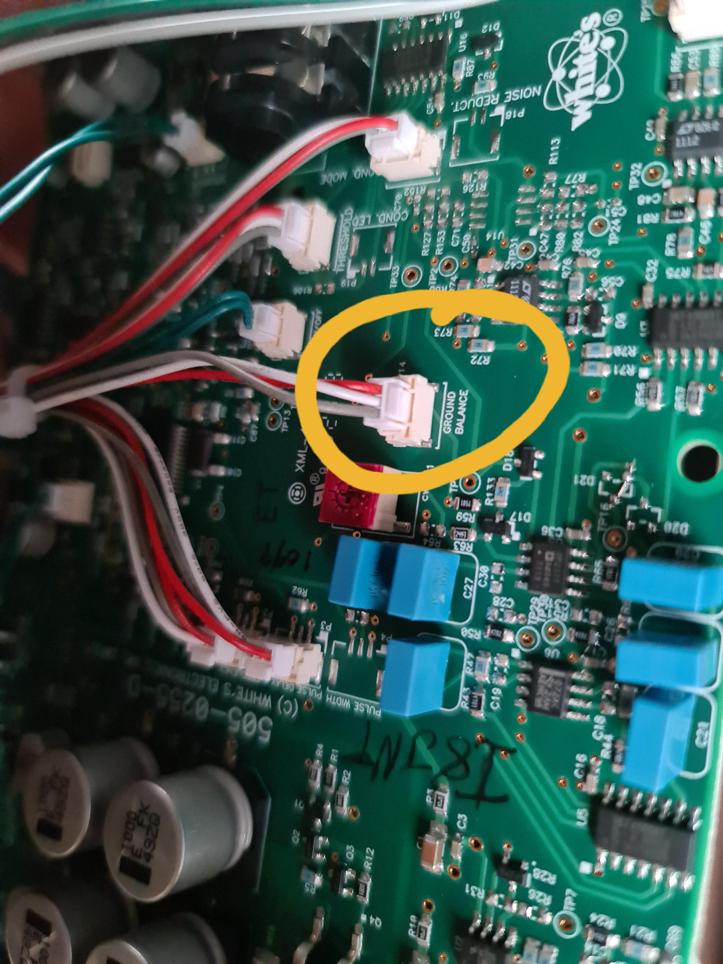

    Hi does anyone know the type of wire to board connector found on the whites TDI SL PCB? The ones where the pots connect to the board?

    If you could share a nice closeup picture you might have better luck getting some opinions.

        looks similar to a APSH connector from JST. What is the pin pitch? That is what you need to match and then you could replace it with anything (both parts) of the same pitch.
          JST 1.25mm GH series
            https://www.digikey.com/en/products/...KYuAOUpAF0BfIA
              Them the ones, thanks guys!
