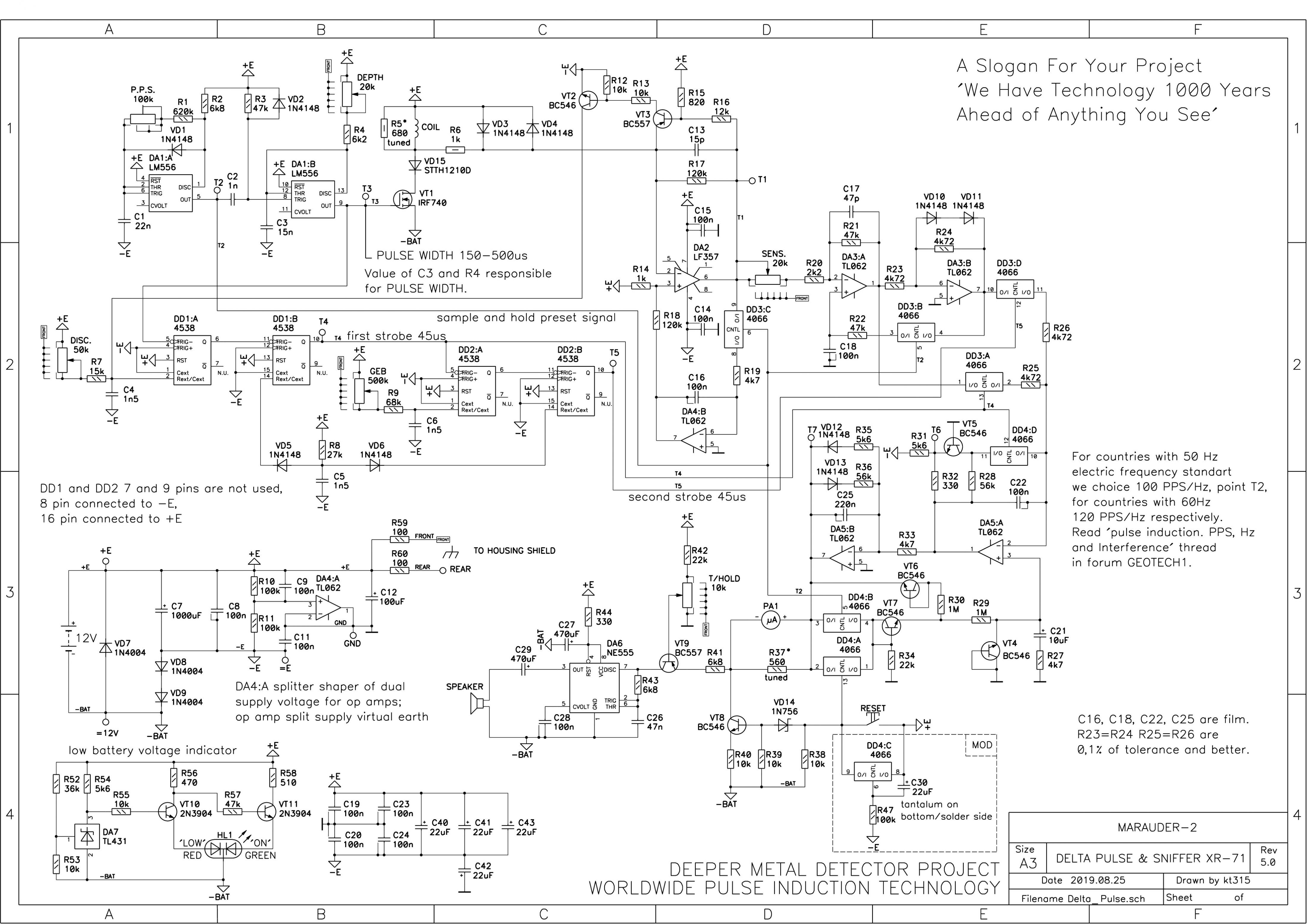

    What I need - a DIY deep search PI detector with auto ground balance or at least an inherent ability to work well in mineralized soil using a large PVC pipe single coil sled to search for deep nickel-iron meteorites. No discrimination needed. No LCD display needed, just audio feedback.
    Why I need it - I want to search a few sites of obscure, single XX kg iron meteorite surface finds just for the fun of it in the hope that deep searches haven't been done. The odds of success are very low and since this is a very limited effort I want to spend as little as possible on the detecting equipment for this single use.
    What I can do - etch double-sided PCBs, perform SMD assembly, test and calibrate with a variety of test equipment including an oscilloscope.
    I have "Inside The Metal Detector - 2nd Edition" on order.
    From reading here for a day I see these as a few of the candidates although none are specified for deep search and probably have a too-low-power pulse at too high a frequency (> XXX Hz) to be deep search capable:
    Minipulse Plus Rev E
    Geotech Baracuda
    Hammerhead PI (I already have a Rev. D through-hole and C1 SMD PCB on-hand)
    Are there any DIY suggestions for something else to use for deep search with a single large coil?
    I assume that the limited nature of what I need could be done entirely with analog circuitry. However, I wonder if a pair of the readily available and cheap ESP32 modules to provide wireless feedback from the ESP32-based detector unit into the towing vehicle cab could be accomplished even with its limited 12 bit ADC considering that just detection and not discrimination is required. As far as I know, such a design doesn't currently exist.

    Delta Pulse. There is an abundance of information on the forum. KT315 can sell you a PCB.
      From your description of the requirements, I would also suggest Delta Pulse as the best candidate.

          Years ago I went down this same path for the same reason and actually etched a few different PI detector boards to play with, one of them laid out just like the completed one shown here:
          https://www.geotech1.com/forums/atta...4&d=1610126229
          but I didn't drill or populate them because I got sidetracked by one of my other tech hobbies.
          The one I etched has the markings:
          www.teknolojiekibi.com
          01.04.10
          duzenleme: 01
          Is that a Turkish Delta Pulse II PCB?
          I found this and wonder if it is an improved Delta Pulse II. It's a Delta Pulse (PCB labeled as Marauder-2 Delta Pulse Legend +) / Sniffer XR-71 thread:
          https://www.geotech1.com/forums/show...ght=Marauder-2
          https://www.geotech1.com/forums/atta...6&d=1393695514
          https://www.geotech1.com/forums/albu...chmentid=47678
            https://www.geotech1.com/forums/show...ight=superscan.
            Superscan PI
            I think it's a good choice.

                Most any of the PI designs can be modified to do what you want. Increase the pulse current, reduce the pulse rate, slow down the integrator, increase the sample delay, etc.

                    kt135, you look like the person to talk to about that Delta Pulse II (PCB labeled as Marauder-2 Delta Pulse Legend +) / Sniffer XR-71 thread. Is that the latest version of a Delta Plus? The PCB looks beautiful.
                      I've got what I guess is your book on the way and already have your excellent v2.1 2006 PDF on Hammerhead assembly and theory. Any other similar gold-standard PDFs with theory like that on this site?

                        all revisions is same schematic. i changed only placement because people used components
                        not in dimensions i did suppose.
