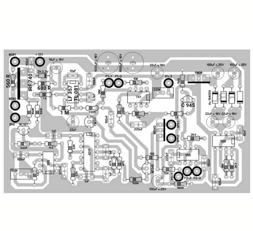

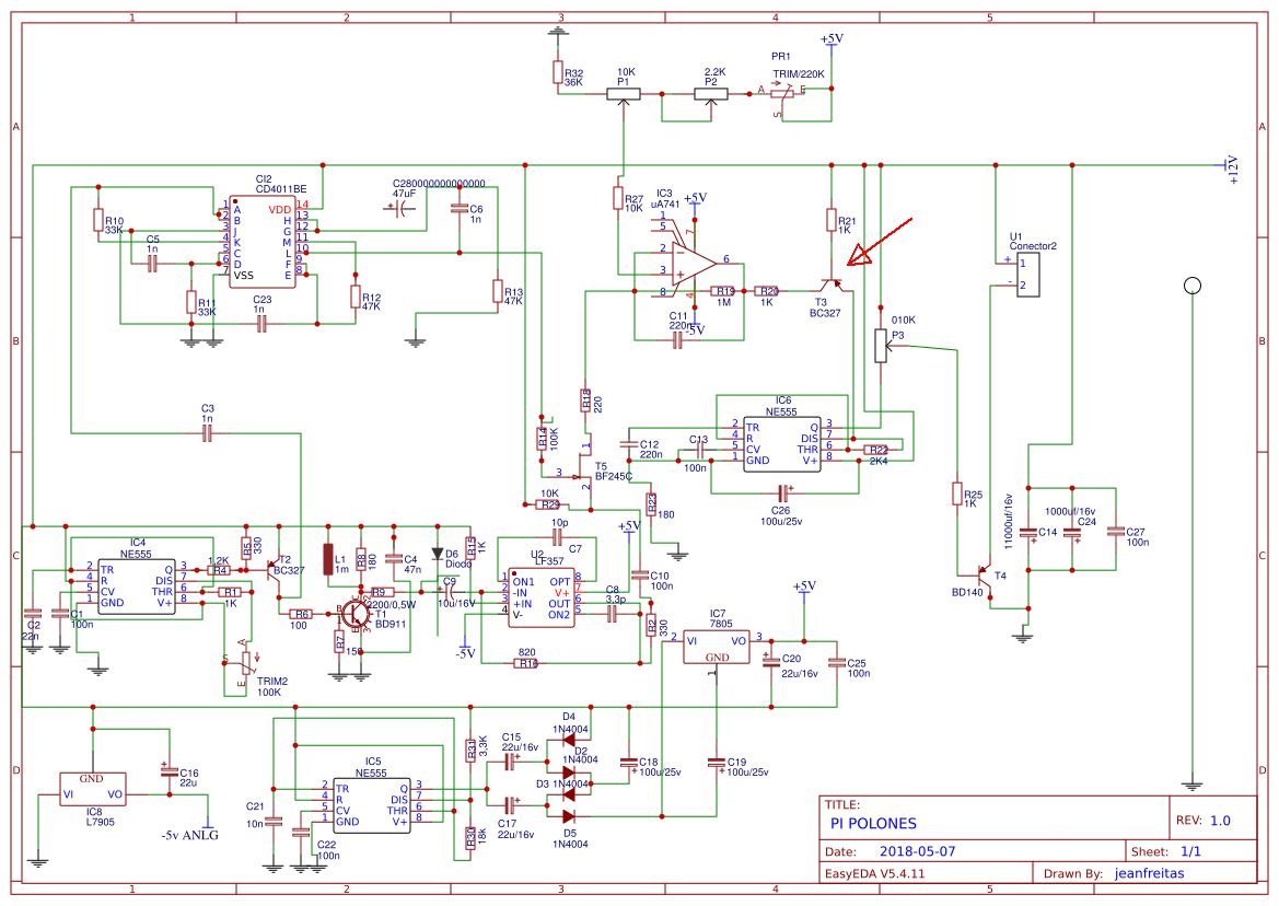

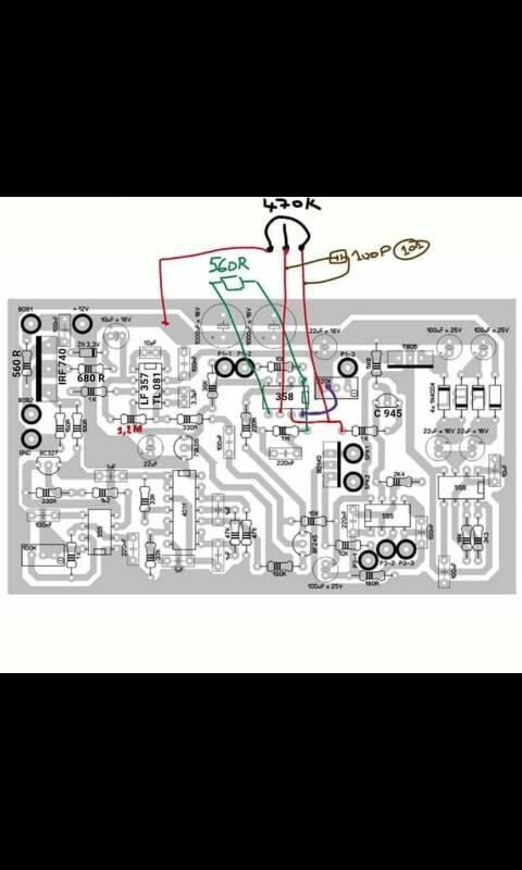

    This is the PCB that we did. There is a pretty long thread on the German forum that Bernte and his group did of their build. I cannot find the link right now.
    Here is the link to the PCB that we did. There are a couple of errors in it.
    https://easyeda.com/jeanfreitas/pcb2-placa

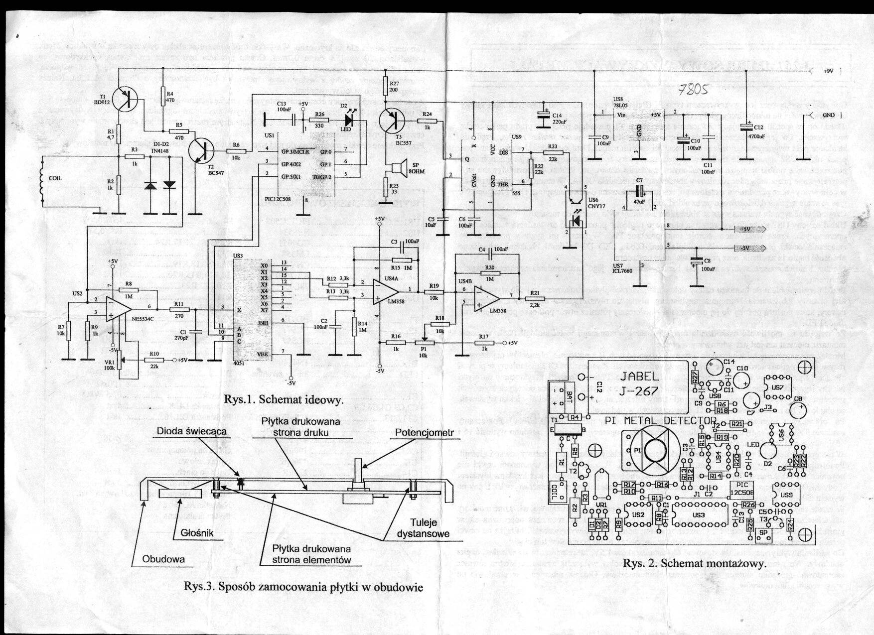

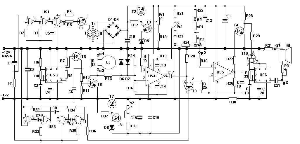

      I was looking for one of the first Polish PI publications to verify this detail.
      MOR_AL
        He is talking about a circuit and does not show a circuit diagram where the relevant components can be seen.
        This is nonsense for me
        The simulation sucks, not the circuit
          My mistake!
          No comment!

            XXX_Det_Met_PI_Polon (.PDF)
Name:	XXX_PI Polones 2019 Schematic_Ed.jpg
            My simulation
            XXX_Simulation.pdf
            MOR_AL

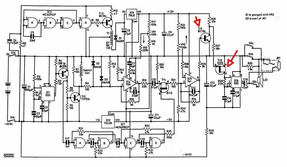

              I suspect that the transistor behaves differently in the overall circuit than in the isolated simulation
                Right! Your suspicions are well founded. We cannot ignore that many Polish PI assembled, are working.

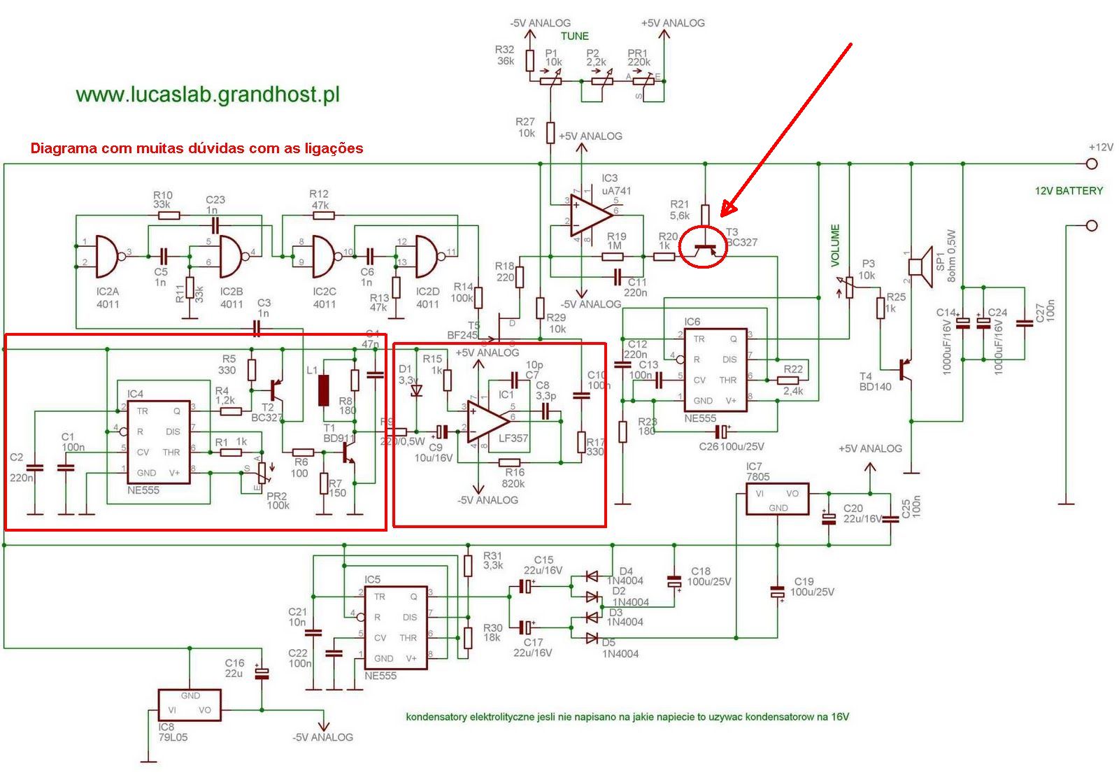

                I cannot explain this. But I noticed in a circuit, that transistor T3 was replaced by a current source. See Tr5 and Tr6 on the attached circuit.
Name:	XXX_PI Polones com FonteCorr.jpg
                Source:
                https://pe2bz.philpem.me.uk/Comm01/-...sandbanks.html

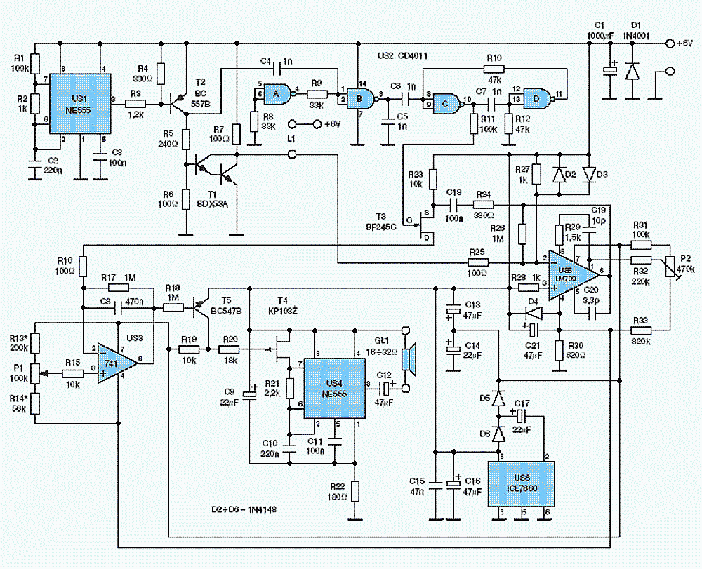

                  I have seen a published schematic that replaced the transistors with an opto coupler that drives the 555, it was very simple and apparently worked,

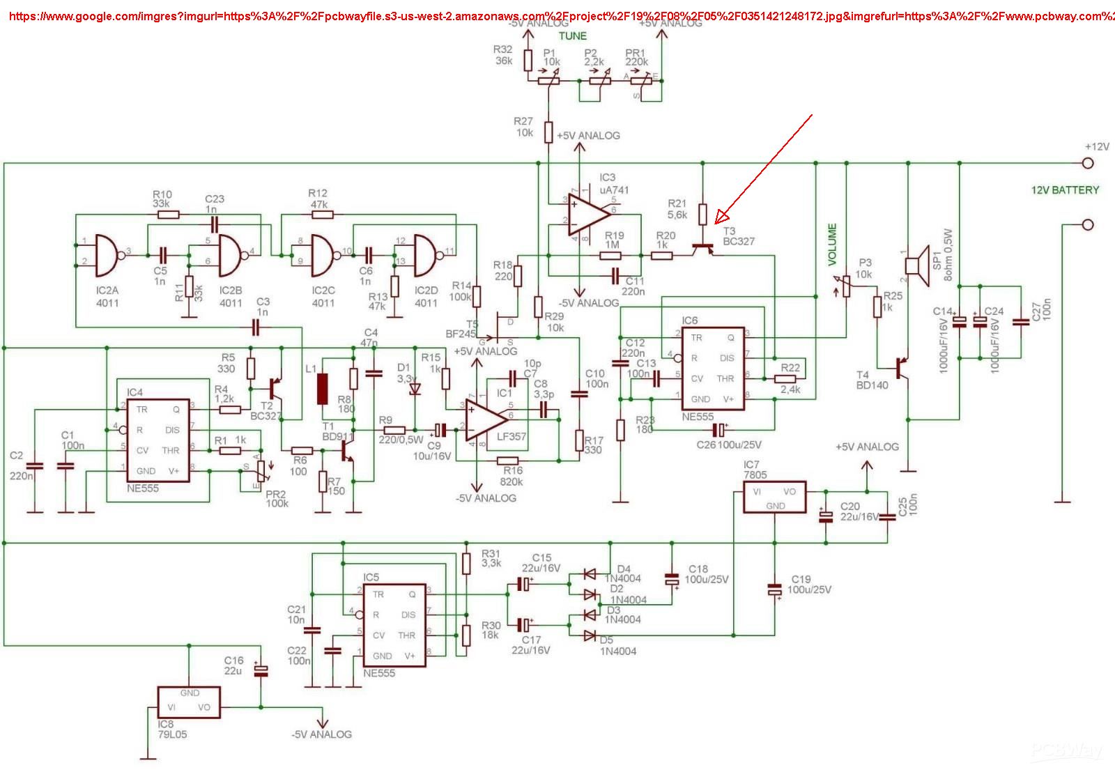

                          What is the purpose of the modifications?It's hard to see in the picture
