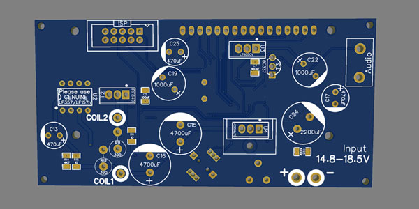

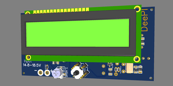

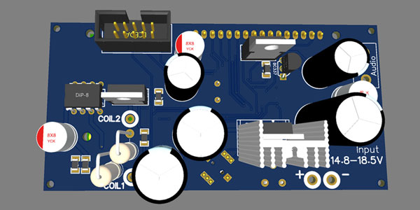

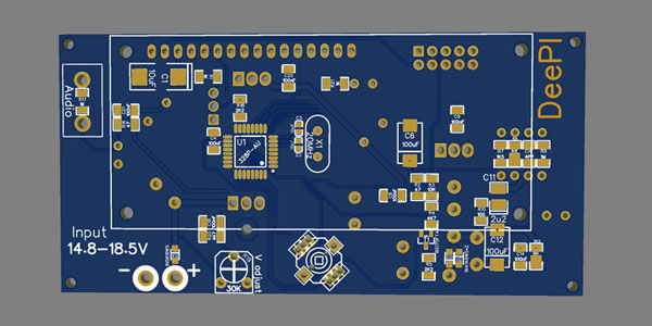

    This is DeePI, a compact SMD variant of Felezjoo PI made to fit in small enclosures (100mm X 50mm PCB size).
    All major components are on-board, the only needed external wires are for the battery and speaker.
    For battery you can use 4 X 18650 in series (14.8V) and adjust R19 pot until the screen displays 18V with fully charged batteries.
    DeePI on OSHWLab (EasyEDA)
    BOM file included, It will appear once you save the project on your projects.
    HEX file:
    DeePI_3.35-FullEdit.zip
    Please note that the board has not been built or tested yet.
    This is my second attempt and there might be minor errors, in case you spot any please let me know so I can correct the PCB.
    Thanks, could not figure out how to see schematic, I ran the DRC and it threw up some errors.
      Thanks for the reminder, forgot to check it.

          cant find any pcb files files, link is dead?
            I've made the project private for now because I want to build it first to make sure everything works OK and then I'll make it public again.
            I was hoping someone else could verify the design but it's better to check it myself. Being a smart@$$ take its toll.
