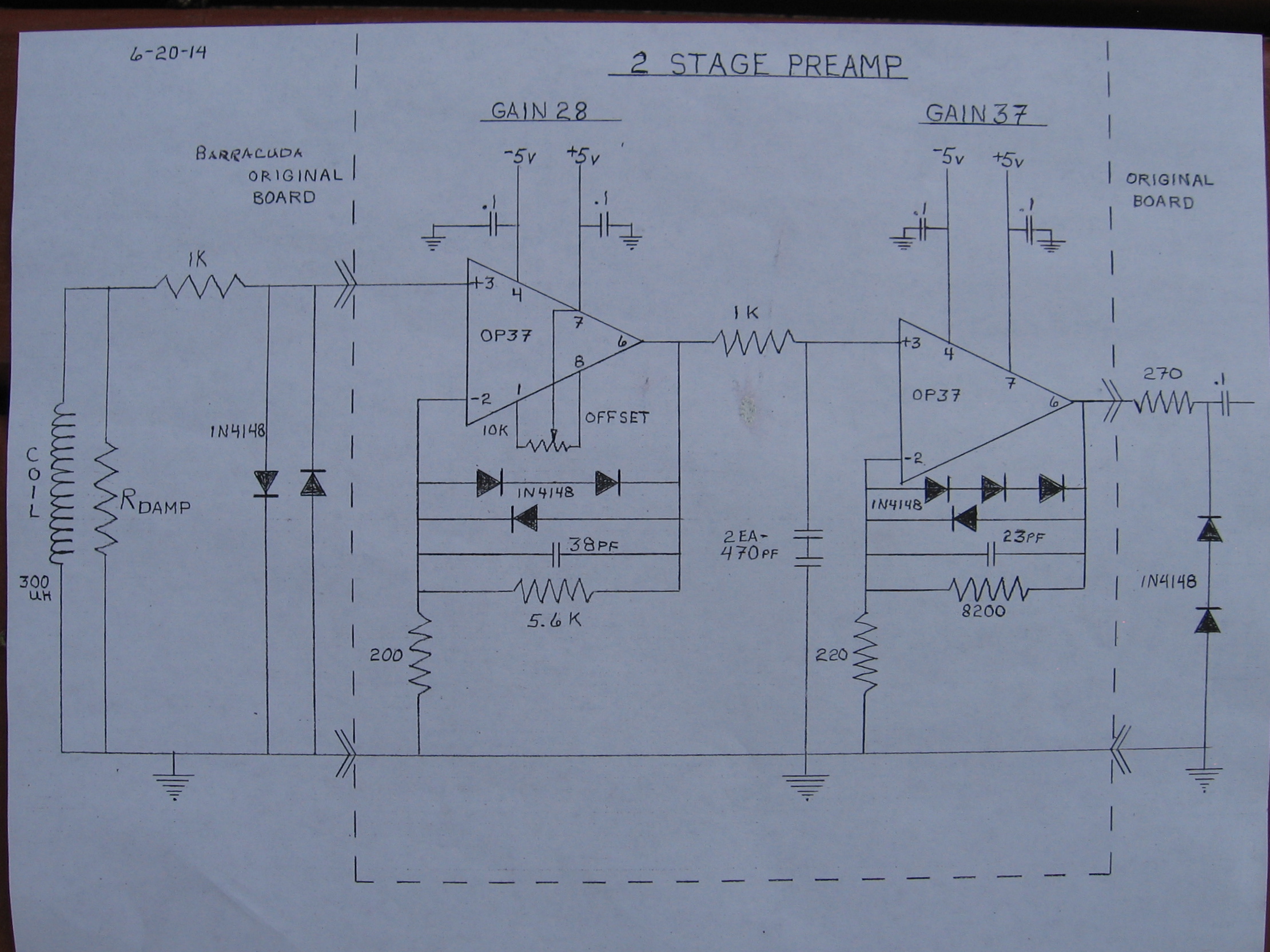

    Hello
    i have some questions regarding some of the previous preamp designs in our forum
    off we go:
    the example
    if anyone would take a minute to answer them, I'll highly appreciate it.
    I'll try to explain my thoughts in detail so you can tell where i'm wrong.
    Questions and my current answers to them:
    starting from AMP feedback caps
    1_ 38pF and 23pF capacitors on the feedback path, is it for high frequency and noise cancellation or what else?
    the cutoff (-3dB) frequency of first stage is about 748 khz
    the second stage is about 844 khz
    I calculated these with the feedback resistor(the large one of course) and feedback caps, is it right?
    these numbers look a bit low for me since this particular two stage pre amp is capable of more than 1Mhz BW (based on calculations)
    2_ another low pass filter in between the two stages, 1k and two 470pF in series, hummm
    the cut off frequency of this guy is about 677 khz
    beside the weird combination of the filters on cutoff frequency, " WHY to use two 470pF in series to form a 235pF cap? "
    is it the value that needs to be precise or some other reason? this config ain't gonna give lower ESR or ESL, but maybe lower leakage possibly
    3_ the RC low pass "or" high pass filter on the output of any preamp regardless of the preamp itself.
    my way of understanding it:
    Low Pass = Noise cancelling? although I'd worry about signal fidelity if i'd use one, gotta be careful with the cutoff frequency.(what should we aim for?)
    High Pass = no need to adjust the DC offset, but noises are free to run like the wind blows...
    IS IT CORRECT?
    what if we add a good 2nd or 4th order sallen key bandpass? (from what Fmin to what Fmax i'm wondering)
    4_ now let's get into the lovely bounding diodes.
    first stage:
    clips the output to one diode drop (+0.7V) when coil is charging i.e tx on (great)
    but on the decay side it clips the decay curve to two diodes (-1.4V) which is very unnecessary in my humble opinion because the second stage
    will amplify it by 37, so only a 0.2v is needed to absolutely saturate the second stage output! can't we just use two back to back schottky diodes?
    schottky diodes will give it serious rise in dv/dt which is slew rate basically.
    second stage:
    when tx on it behaves the same as the first stage +0.7v
    and when decay comes on, it suppose to limit to negative three diodes (-2.1V) , but does it?
    because there are two diodes between output and ground so i think it will stop at -1.4V and make those three diodes useless, am i wrong on that?
    BTW what's the purpose of the 270 ohm res.?
    I apologize for this long romance, i couldn't help myself
    it's been almost two weeks that i can't sleep fine with these questions hovering in my head
    Op-Amp nightmares every night, you can imagine...
    Invalid Attachment
        1. Numbers are correct. It's often more useful in PI systems to think of the preamp BW in terms of tau. Without the cap the first stage is limited by the opamp to 63MHz/25.5 = 2.5MHz, which has a tau of 64ns. Generally you don't need a preamp tau any higher than 5x the smallest tau you want to detect, which in this case would be 300ns. Are you wanting to detect a 300ns target? If not, then throttle back and cut some thermal noise in the process. If you only want to detect a 1us target then shoot for a 200ns tau. For a 5.6k resistor that would be a 36pF cap. Hey!
        2. I would not use 2 caps in series. Probably ever. This extra filter provides very marginal noise reduction.
        3. Both LP & HP can reduce noise. HP does decouple DC offset but can also reduce e.g. power line noise.
        4a. I agree, not sure why the first stage has 2 diodes. 1 diode will do it.
        4b. The 270R is to current-limit the opamp when the 2 output diodes turn on. The output can still continue to drop and if it drops another 0.6v or so the 3 feedback diodes will turn on.
          Thank you very much master

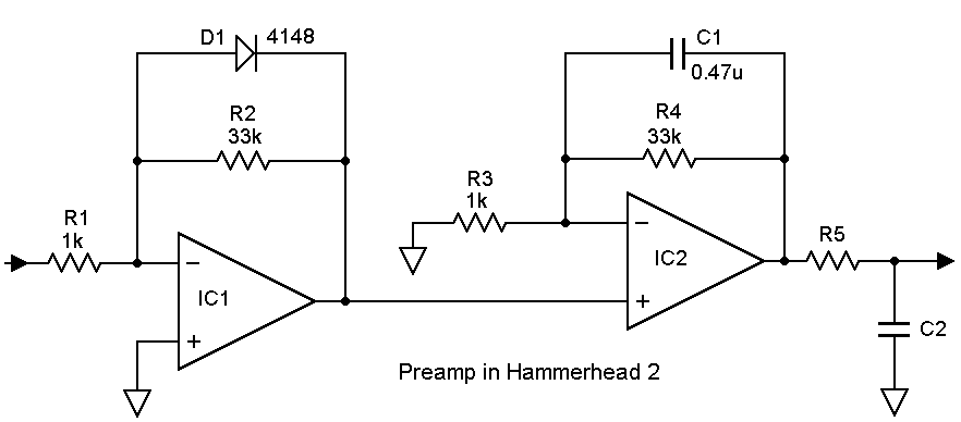

          i'm also wondering about this!
Name:	Hammerhead2 preamp.GIF
          integrator in the PreAmp!
          right now the only thing that i can think of is:" it will kill the signal "
          it's gonna average out everything, how we're going to see those subtle changes produced by target metals?
            [ATTACH]54562[/ATTACH]
            Probably a typo. I deny responsibility.
              Understood.
              Thanks again.

                    3) about the three bounding diodes in the second amp feedback and those two extras on the output
                    couldn't we just use either one of them, or is it necessary to go with both? maybe a leftover from the original scheme?
                      you said "throttle back and cut some thermal noise in the process"
                      how do we reduce thermal noise ?
                      Resistors are a source of thermal noise known as Johnson noise.
                      https://en.wikipedia.org/wiki/Johnso...3Nyquist_noise
                      Reducing the resistor values can reduce this noise.
                        yeah exactly
                        but what i'm wondering about is what Carl meant about lowering Johnson noise with limiting the bandwidth
                        maybe I'm getting it wrong
                          not sure how 80khz came along the way, 2us is 500khz and 10us is 100khz
                          are we being generous about that ?
                          That's for omega. Bandwidth (f) is 1/(2*PI*tau).
                          1) you said "throttle back and cut some thermal noise in the process"
                          how do we reduce thermal noise ?, by lowering the Amp speed with lowpass filter?
                          because i think the op amp will not operate slower internally but it will shove that fast current to feedback cap so the output is slow
                          Yes, bandwidth-limit the opamp. It will also bandwidth-limit the noise.
                          2) I am hesitant to use capacitors in the feedback of the preamp because i think they will greatly reduce Slew Rate of the Amp
                          any other way to limit the bandwidth without compromising?
                          Opamp BW affects the linear (non-saturated) operation. In non-linear (slew-limited) operation the feedback cap has little effect.
                          The 3 diodes limit the large-signal gain of the opamp but don't necessarily limit the output voltage. The 2 diodes limit the output voltage.
