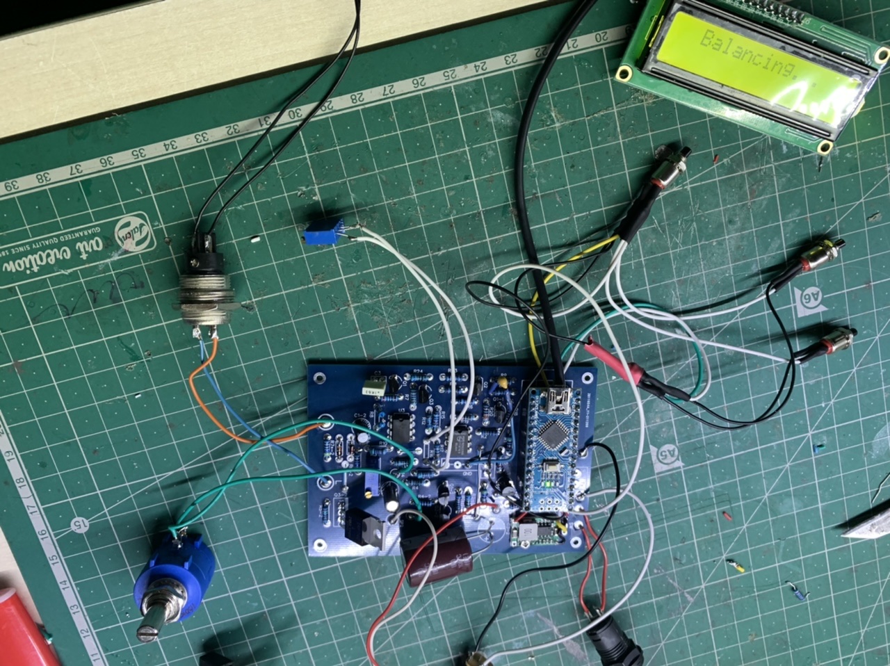

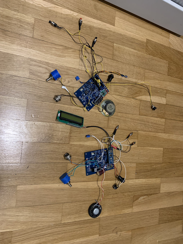

          I have build this neco spririt pi, the LCD version. I am struggling to make it work. It seems that it is not as stright forward as it presumes. I have double checked all components several times. I even built another one from scratch. It looks like some resistors have critical values that have to be found using an oscilloscope in order to fin which value triggers the ne5534.
