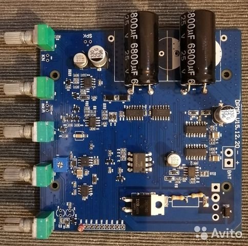

Classic DeltaPulse in new SMD revision

        Or what can you say about tantalum capacitors, why are they in the DeltaPulse?

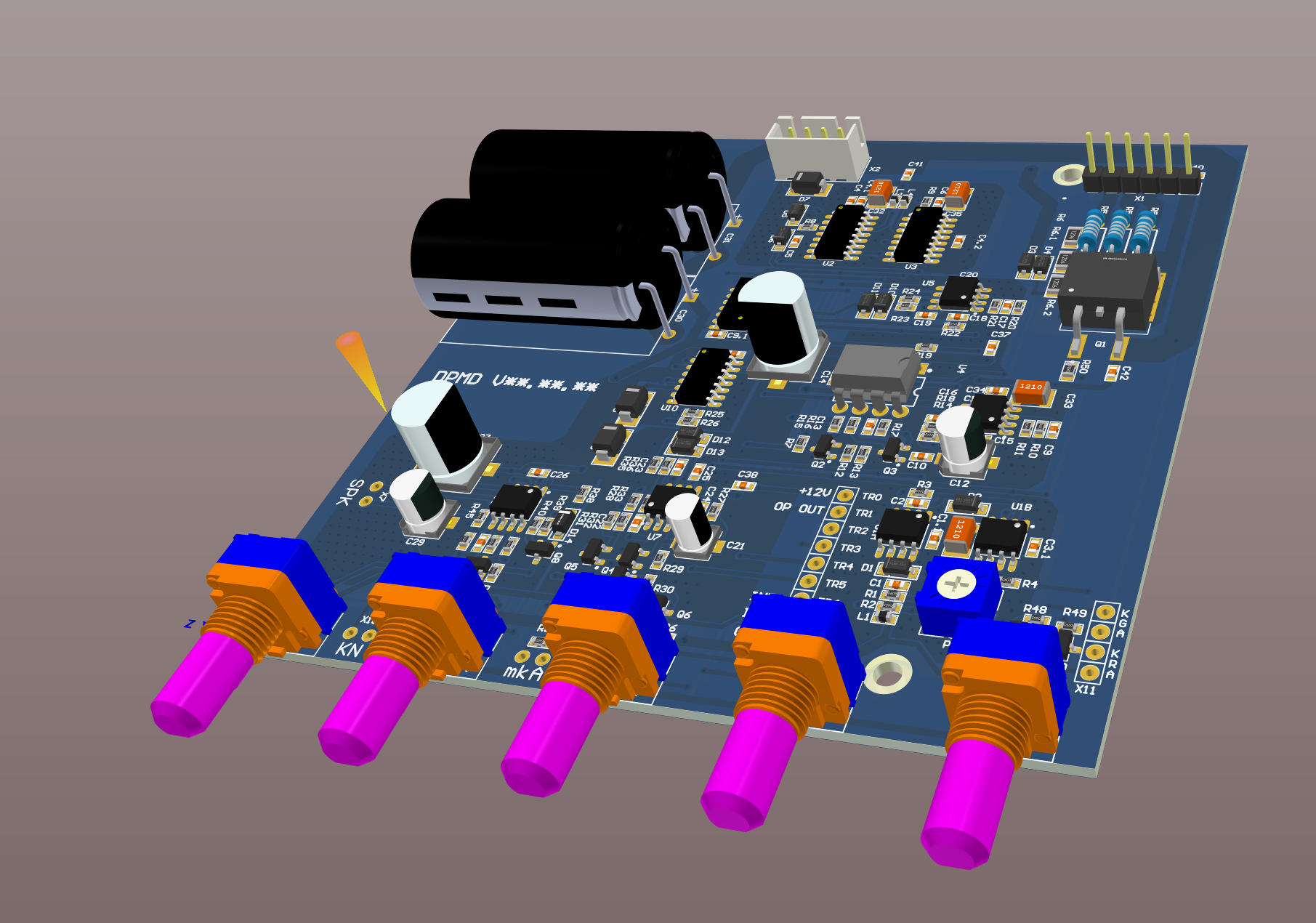

          By the way, a new revision of PCB is already ready.
          Of the features:
          -placement of components only on the upper side
          -improved placement of components and connections between them
          -improved power supply scheme
          -three resistors on different coils
            Of the features:
            [ATTACH]55318[/ATTACH][ATTACH]55319[/ATTACH]

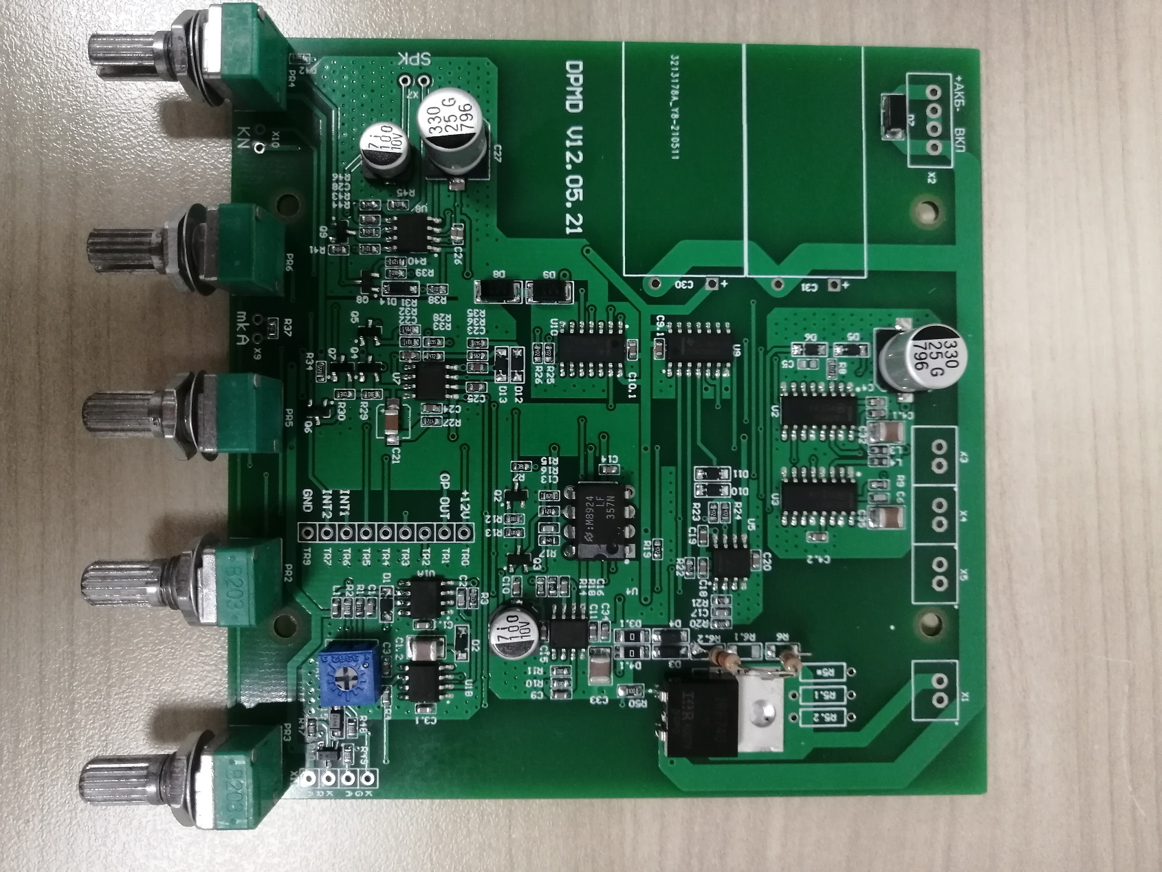

            Do you solder all that by hand? If so perhaps you can share your technique, I find SMD daunting.

              Yes, I solder by hand, I think there is nothing frightening or surprising here. A good tool, a soldering iron, a microscope.
              For example:
                Do you solder all that by hand? If so perhaps you can share your technique, I find SMD daunting..
                Soldering SMD by hand is easy. Use your soldering iron to put some solder on just one of the pins (for example a resistor). Then hold the element with tweezers and with the soldering iron melt the solder while placing the element with the tweezers, press down well to the board and adjust the proper angle. Then solder the other pin.
                I solder chips in similar way. Lately I've been working with PIC32 and those have very fine pitch 64 pins which are a bit pain to solder. I use similar technique, and I found out a good way to avoid shorts on the fine pins.
                I use alot of soldering paste /flux/ and solder braid which you gently rub the pins so all excessive solder is gone and also it makes very good contact /no cold joints/..

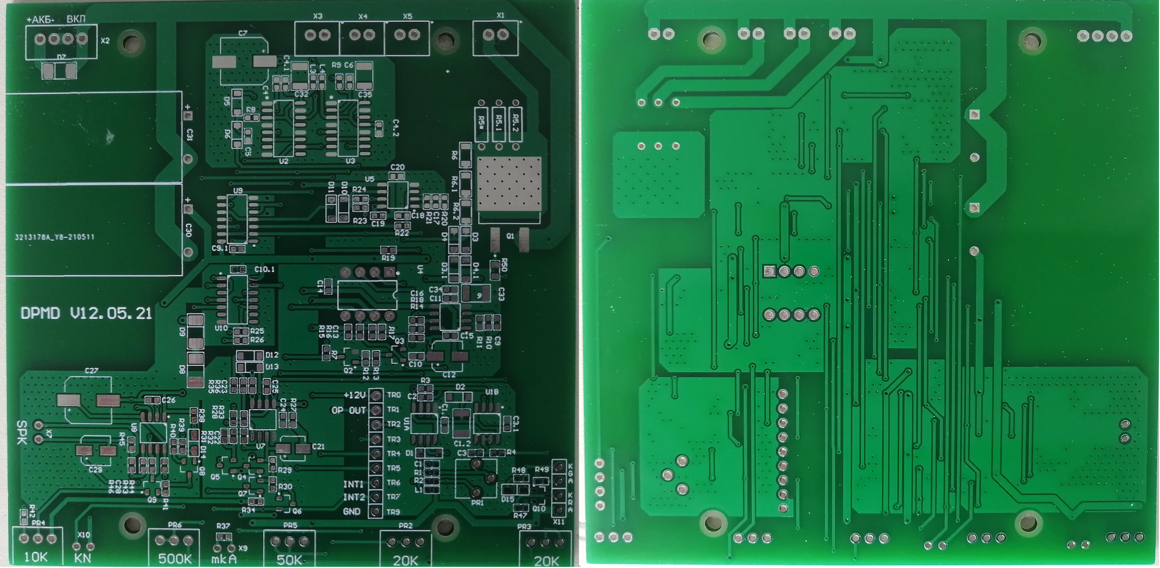

                              PCBs are ready.
                              I'm starting the assembling.
                                The SMD components are already mounted.
