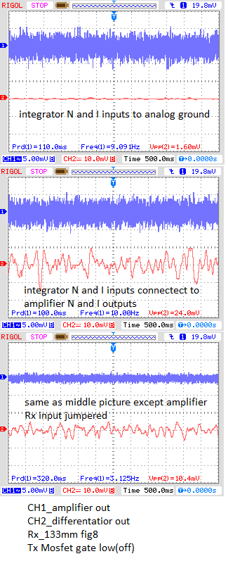

    Some scope pictures of differentiator out. Don't remember seeing pictures of final stage noise of other detectors. Is waveform what I should expect, amplitude not important. Can anyone post some pictures for comparison?
    Coil pickup and amplifier noise. Tx Mosfet off.
    In general that is what my Hammer Head 2 looks like.

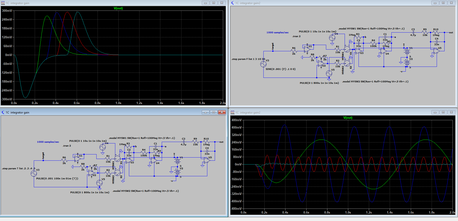

      Thanks for the reply. Have see different cut off frequencies used in post filtering, both low pass and high pass. Including a spice simulation stepping frequency and pulse time on. Is there a better input signal to test with? Circuit has a DC gain of 1000 with 1000pps and 10us sample time. How is best cutoff frequency determined? Comments or suggestions appreciated.
