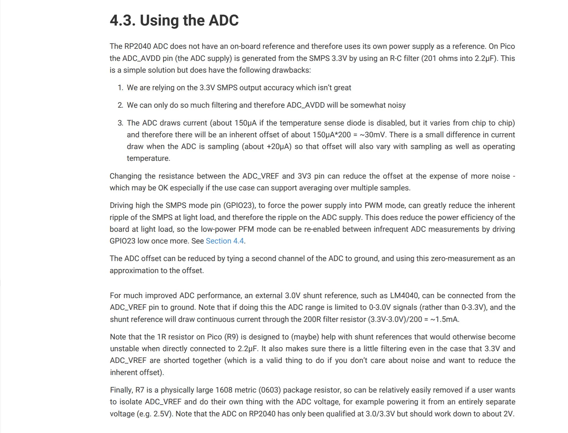

          Sure you can use Raspberry to build a detector. It's good to see Pico has a 12-bit onboard ADC. But the SMPS will cause lot's of problems. See extract from datasheet:

              Thanks for your information lucifer, i have not tried ADC in action. I think for non direct sampling will suit fine.

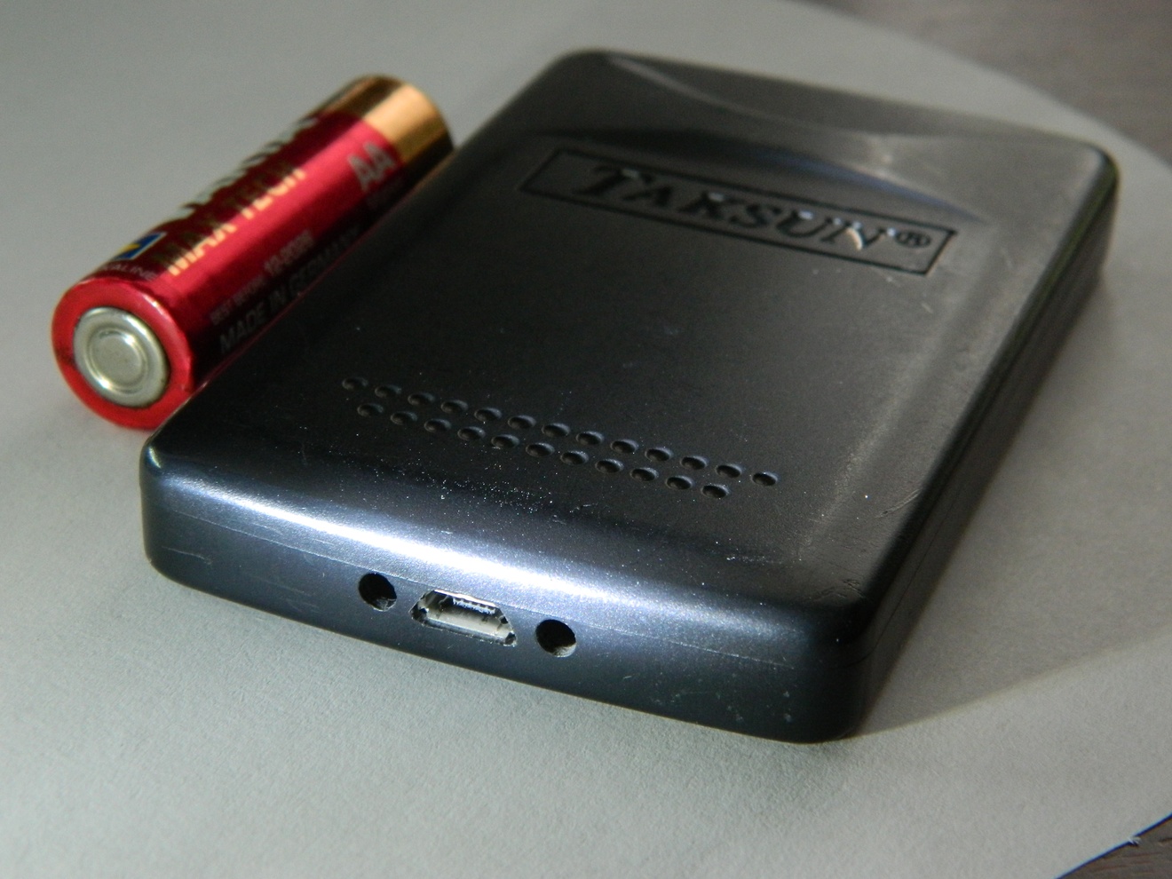

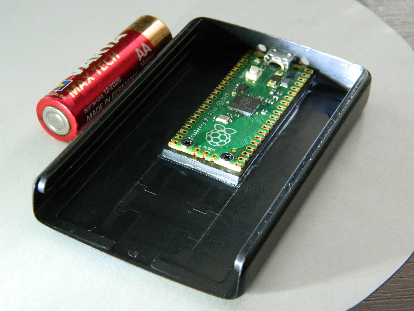

              This is my enclousure for RPI
