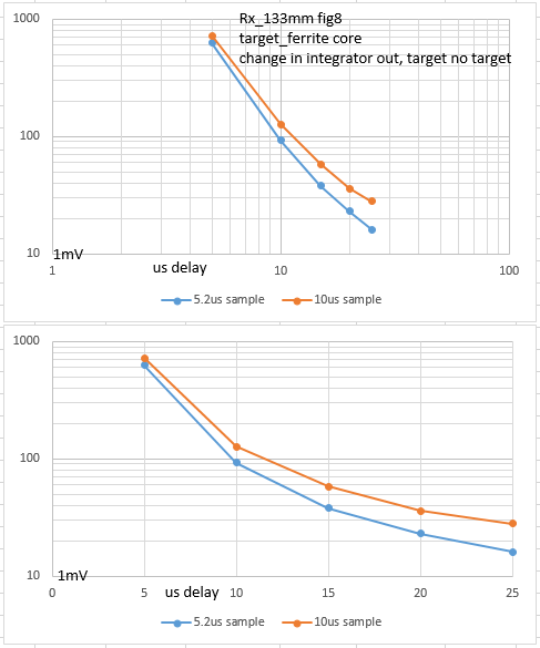

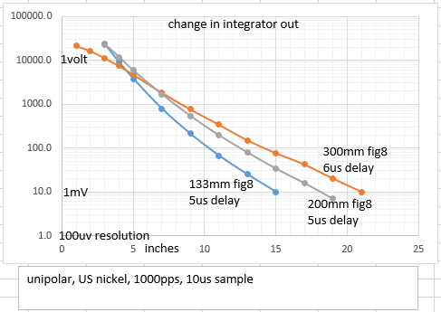

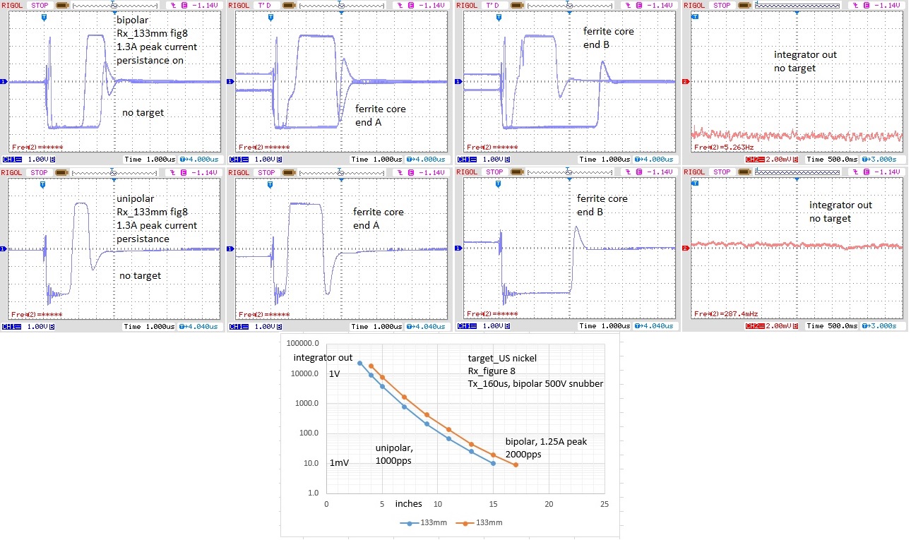

I've been playing with moodz CC bipolar and a standard bipolar Tx circuit lately. Bipolar should be better, especially like moodz CC circuit. Longer Tx on time reduces signal subtracted from target sample. Bipolar doesn't need EF sample. But so far I haven't been able to get bipolar Tx to be better than my unipolar Tx. Charted change in integrator out vs target(US nickel) distance for my latest unipolar circuit which I added a 7V Tx supply so signal what remain constant as PS volts droops from 12V to 8V. I tried charting a 200mm fig8 coil that I'm working on. Data not as good as it should be. Coil needs shielding, added poster board sheet painted with graphite over the coil when I tried but it wasn't good enough.

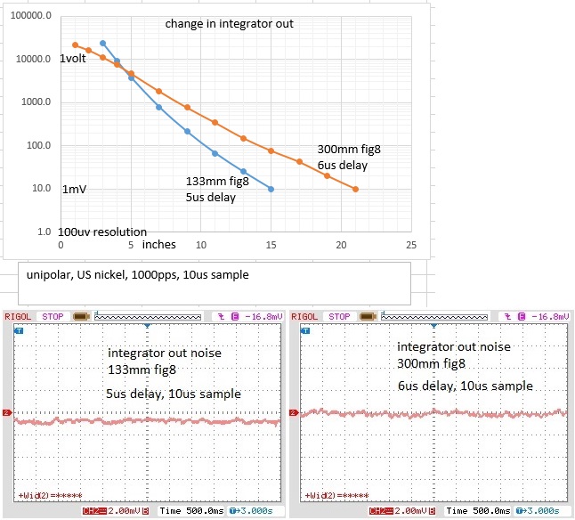

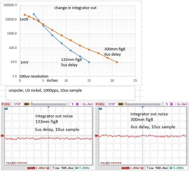

Something to compare the bipolar circuits against if I can get one working the way I would like. Charted integrator volts out vs distance instead of a visual or audio indication detection vs distance to minimize noise effect, DVM averages signal. Target is stationary, not effected by how I move it.
