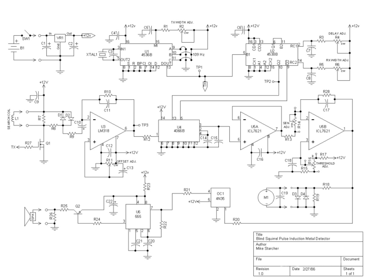

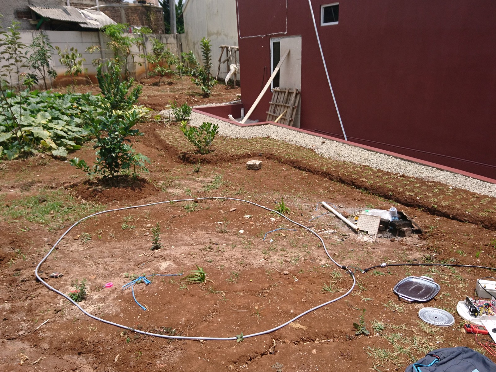

    I've build Mike Starcher detector, BlindSq. Working good with 45cm coil. Now I'm going to use it with very large coil, the target is 3 meter deep at size 50 litre stainless steel drum. I have 2.5m circle coil already (380uh 1.8 ohm with damping currently 470R 5Watt). I still doubt to plug into the circuit yet, I want the right move before doing it. Before started, I need advice from anyone here. Question are:
    1. Is it possible using Squirrel for this search?
    2. Is 1.3A battery will do?
    3. For this target what is the right config: what freq? tx pulse width, sample pulse width?
    Thank you so much for any suggestion.
    Taufik
    1. For running a large coil you want a zero-motion PI circuit which the Blind Squirrel is. So in that respect it is a good choice. The only question then is whether it has enough depth.
    2. Should be fine.
    3. For a large steel drum you probably want a TX pulse with of at least 250us. Run the frequency as high as you can, this will be limited by the heat that is generated in Q1, R7, and R8. 1kHz should be possible. The sample delay should be as fast as you can do it (it will be limited by the wider TX pulse width) and the sample width can be fairly wide, say 50us.
    Always use an identical test target to see what works the best.

            Hopefully I can report here in several days, after changing freq etc. But it seem on the jumper table shows:
            C B A Frequency
            0 0 0 6.9 Khz
            0 0 1 3.4 Khz
            0 1 0 1.7 Khz
            0 1 1 873 Hz
            1 0 0 436 Hz
            1 0 1 218 Hz
            1 1 0 109 Hz
            1 1 1 54 Hz
            To have 1khz is difficult for me to decode, nearest would be 873hz
              I don't think Carl meant precisely1kHz , he meant 'up to 1 kHz'. It's not that critical.
              However, if you do want more choice of frequencies, you could change the quartz crystal. Choosing 2.4576 MHz would give a range of intermediate frequencies, as it is approximately 0.7 x 3.579 MHz. Choices would be 4.8 kHz, 2.4 kHz, 1.2 kHz, 600 Hz, 300 Hz, 150 Hz etc.
                I see. Incredible inputs Mr. Skippy, thanks a lot! I'm ordering the xtall now. I'm going to use 1.2Khz option. Regards

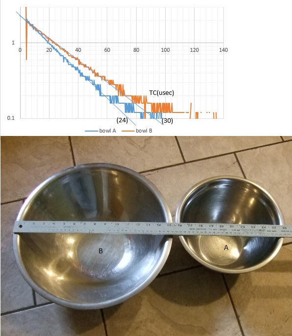

                  I have found some stainless targets hard to detect. Have some stainless bowls that I tested this morning, guessing Op04 target could have a longer time constant. The bowls I tested should be easy to detect.
                  Suggested bowls should be easy to detect if coil is large enough. Wondering if true if detector doesn't have ground balance.
                    For the benefit of OP04, what Mr. Green's picture shows is that a large stainless steel bowl has a decay time-constant of 30 microseconds. This is quite short, it's comparable to a USA zinc-cored 1 cent coin 'Zincoln', for example. Such a coin may be of some use when doing basic tests on this Squirrel machine.

                      Another possible test target. Aluminum coke can has a time-constant of around 35sec.
                      Found a decay chart, looks like aluminum coke can time-constant is closer to 40usec.

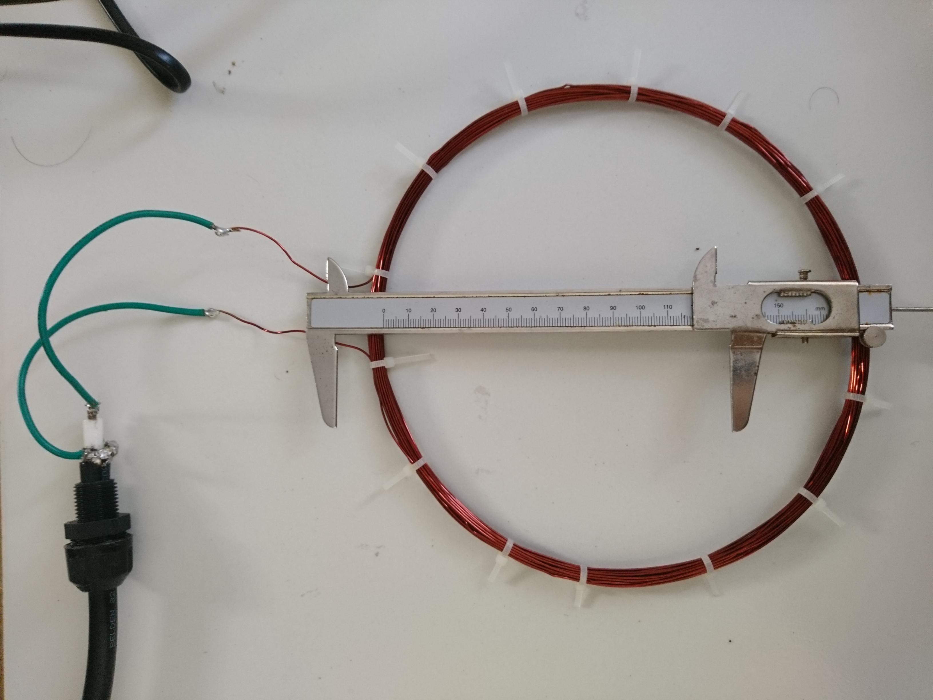

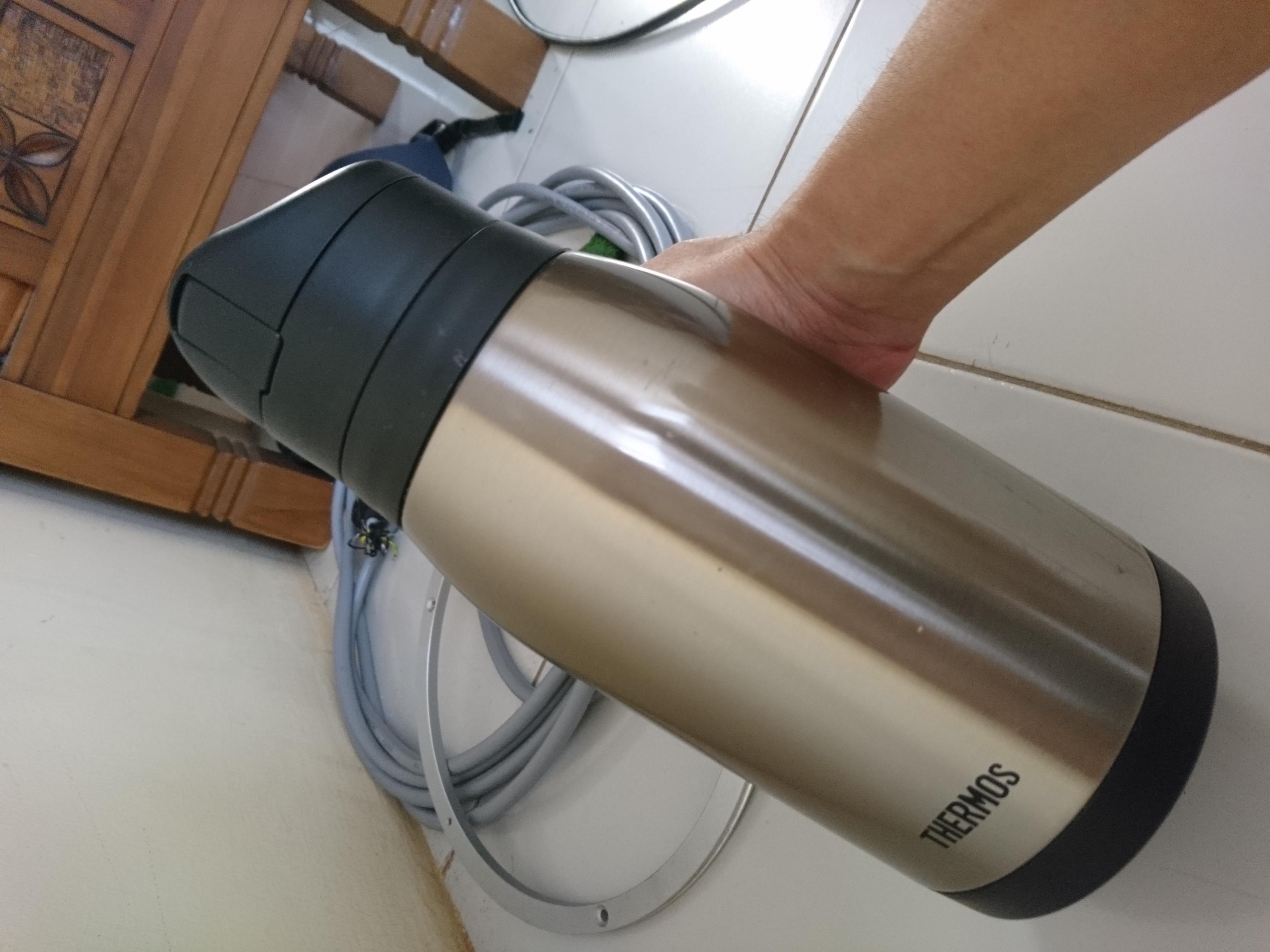

                          I finally got the time to do some test. I can't find my 45cm coil, so I made a new smaller 18.6 cm diameter just for this. Unfortunately I can't reach o'scope (I usually borrow from a friend but he's out of town). So I put fixed resistor for the sample width (R4) 12k (assuming I get 49us nearly to 50us) and R6 at 6k8 for 30us delay. I also guessing the maximum TX width I get 270us from measurement R2 by 21.3k ohm. Ignore the LM78H12K which damage during test (before, using 24V / 2 series battery) so I bypass directly from 1.3A 12V gel battery. The top I get from stainless water jug is around 45cm. I still don't know how this performed compare to the big coil.

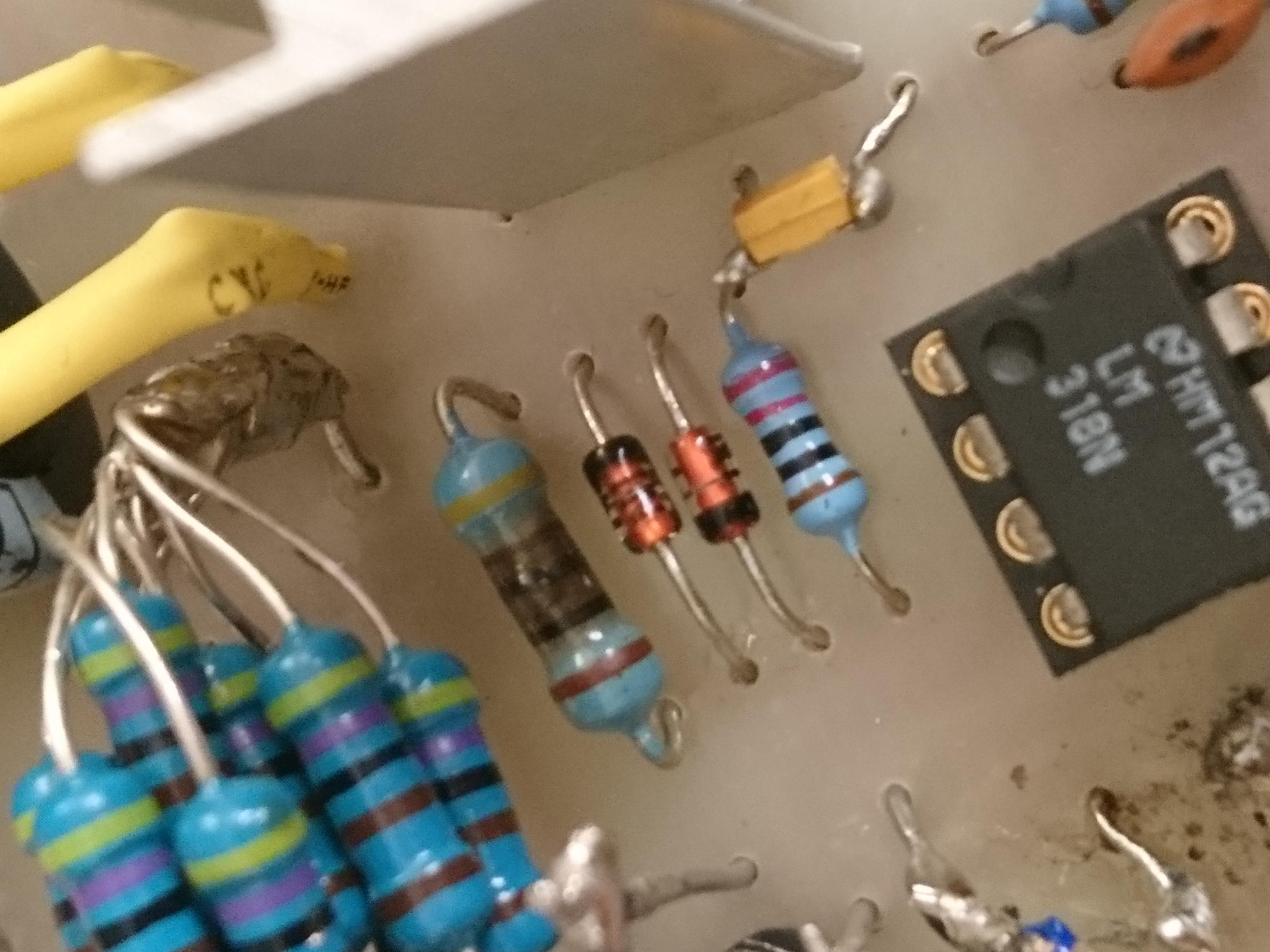

                            What Mr. Carl pointed R8 will be hot, it's true. After several hour testing, R8 is so hot, replaced with 2watt rated still hot. IRF740 is hot but I can still touch it, Should I change R8 to higher wattage? Meanwhile everything stable enough.
                              If the resistor is getting discolored then you need a higher wattage.
