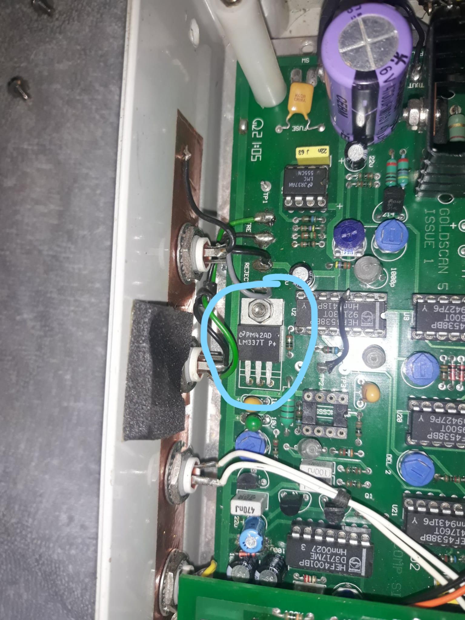

    Hi guys, my GS 5 stopped working. It had been out the day before and the next morning when I went to turn it on, the battery meter went all the way up and started to smell burnt.
    I quickly unplugged it and the transistor below was very hot. Not that this could happen.
    Can somebody help me? Or I would like to know who can fix ...

    not a transistor. it's a stabilizer of negative voltage of power supply.
      The LM337 provides -10V for the audio circuit. Maybe the headphones got shorted. The -10V also drives a -5V regulator for the rest of the circuitry but I would think the -5V reg would burn up long before the LM337.

        Why is there an IC missing from the Dip8 socket?
          There's probably another issue with the board.
          The regulator there is probably overloaded with high current caused by short, maybe even damaged mosfet transistor not willing to switch on/off or mosfet timing circuit malfunction.
          If you have knowledge in testing do the following:
          1) Disconnect the coil
          2) measure the coil resistance must be over 2 ohms to be sure coil is not shorted
          3) Measure voltages +5V, -5V, -BAT to LM337 output
          4) Measure the gate pin on the mosfet, you must have about ~3Khz frequency there with oscilloscope
          All Eric Foster machines can be repaired because there's no chips deleted, white paint etc crap.
            True. Voltage stabilizer
              It has always been like this. The reason I do not know

                    Hi Draco,
                    Something puzzles me about this board. The missing IC is a Cmos 555 used to generate a square wave of about 60kHz to drive a diode pump type inverter for the +5V rail used in the receiver. The link of black wire to the 4538 IC looks to be a substitute for the 555. This is not original. If it works, then the result is that the inverter is synchronised to the TX pulse rate, thereby eliminating a potential source of interference.
                    Over the next few days, I will get a board and see if this, or a different fault, could cause the 337 regulator to run hot. The green capacitor is also a foreigner.
                    Eric.
                      The green tantalum bead capacitor does look to be 106 = 10 uF, and it's fitted the correct way round, so maybe the original died, but the replacement is OK ?
                      The dark blue preset pot looks non-original, too, to me.
                      If the 555 pin 3 was used to drive a charge-pump & its load, then there would've been a significant current drawn from that output. No problem for a plain bipolar NE555, or even a LinCMOS TLC555, but hopeless for a 4000-series monostable timer IC, surely ?
