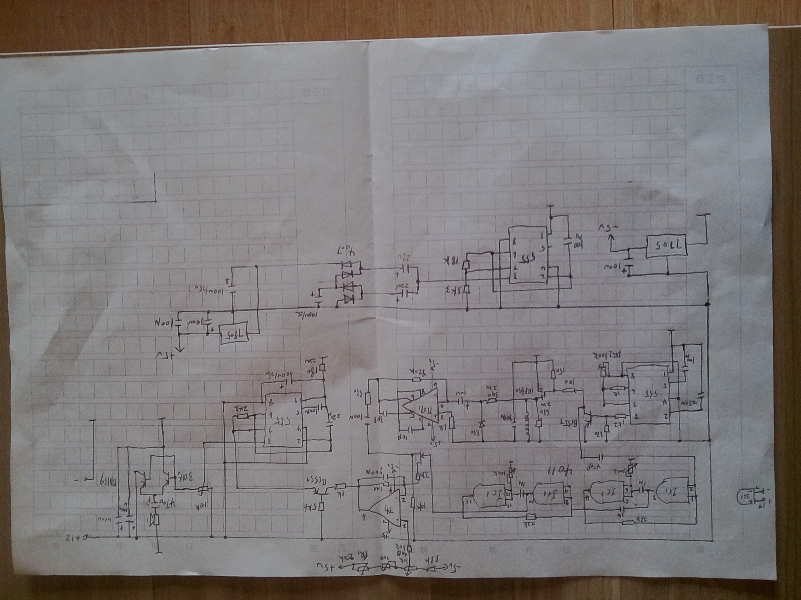

      Unfortunately, I can't find its circuit diagram. If I have time, I will modify one according to the original machine drawing.

                Can anyone post another PI with GB?

                            based on the hand drawn schematic from post #21, the circuit diagram is a PI-Polones circuit diagram... The "GB" label on the schematic diagram is not correct. It is only an ordinary threshold poti. The detector PCB shown in post #14 does not has a ground balance circuit. DISC1 seems to be an ordinary poti for pulse delay. This circuit part is from the original Sandbanks PI detector and someone added two control poties for DELAY and SAMPLE WIDTH to it. DISC2 changes the sample width only. The text "Setting Frequency Min 350MHZ to 1,2KHZ" is also nonsense. It should be "350Hz to 1,2kHz". It seems that the “PCB designer” does not know what he/she was copying when added the legends to the PCB board.
