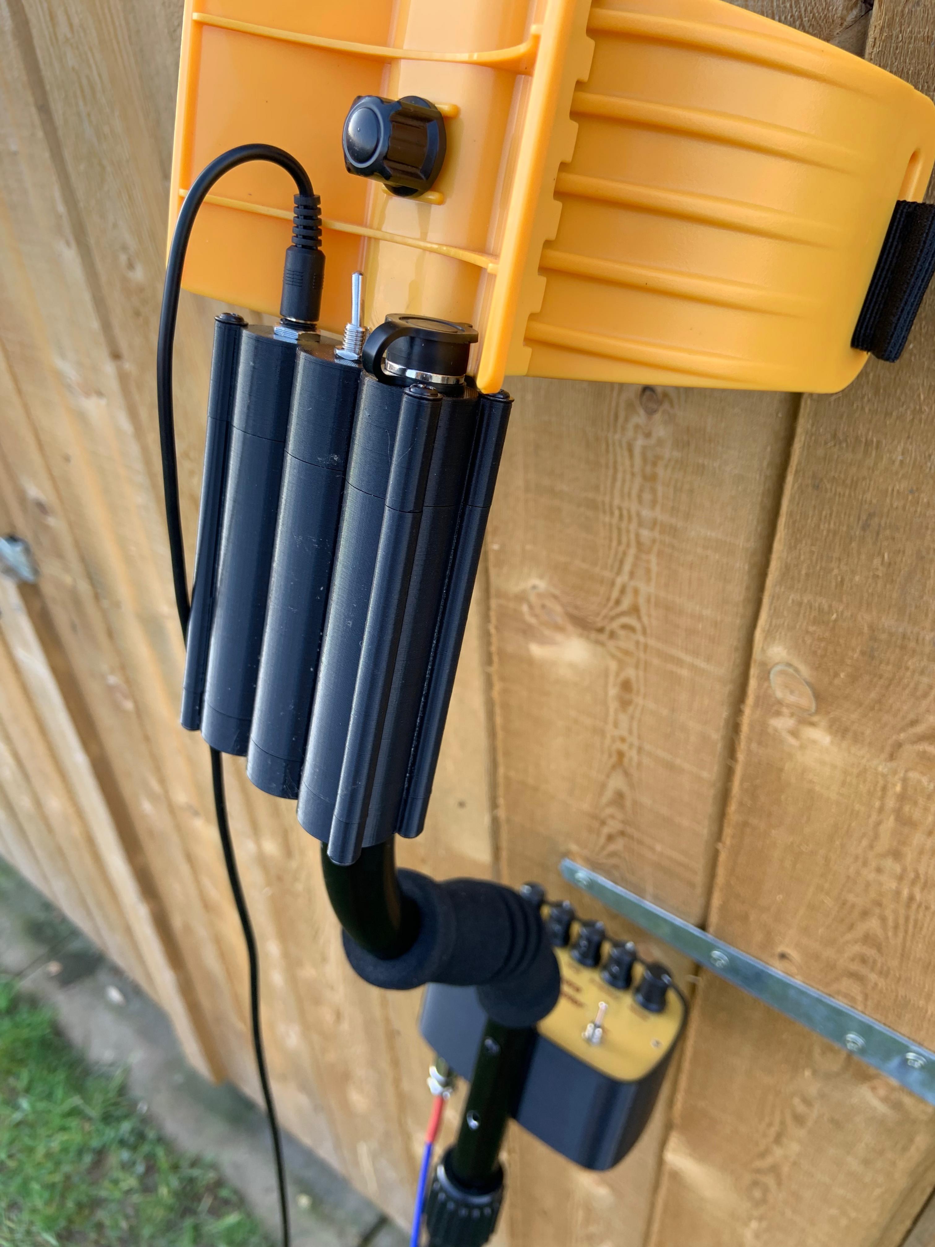

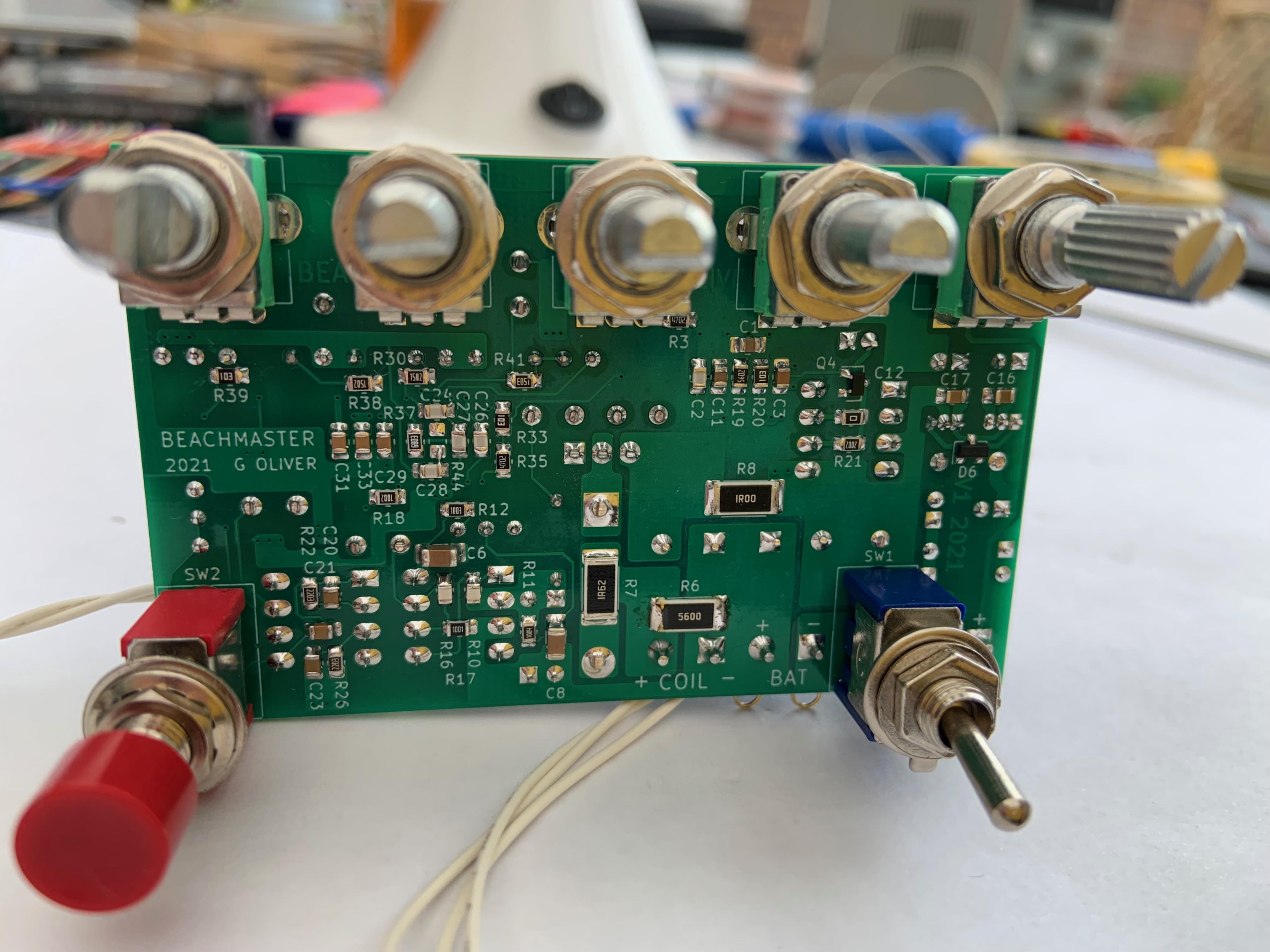

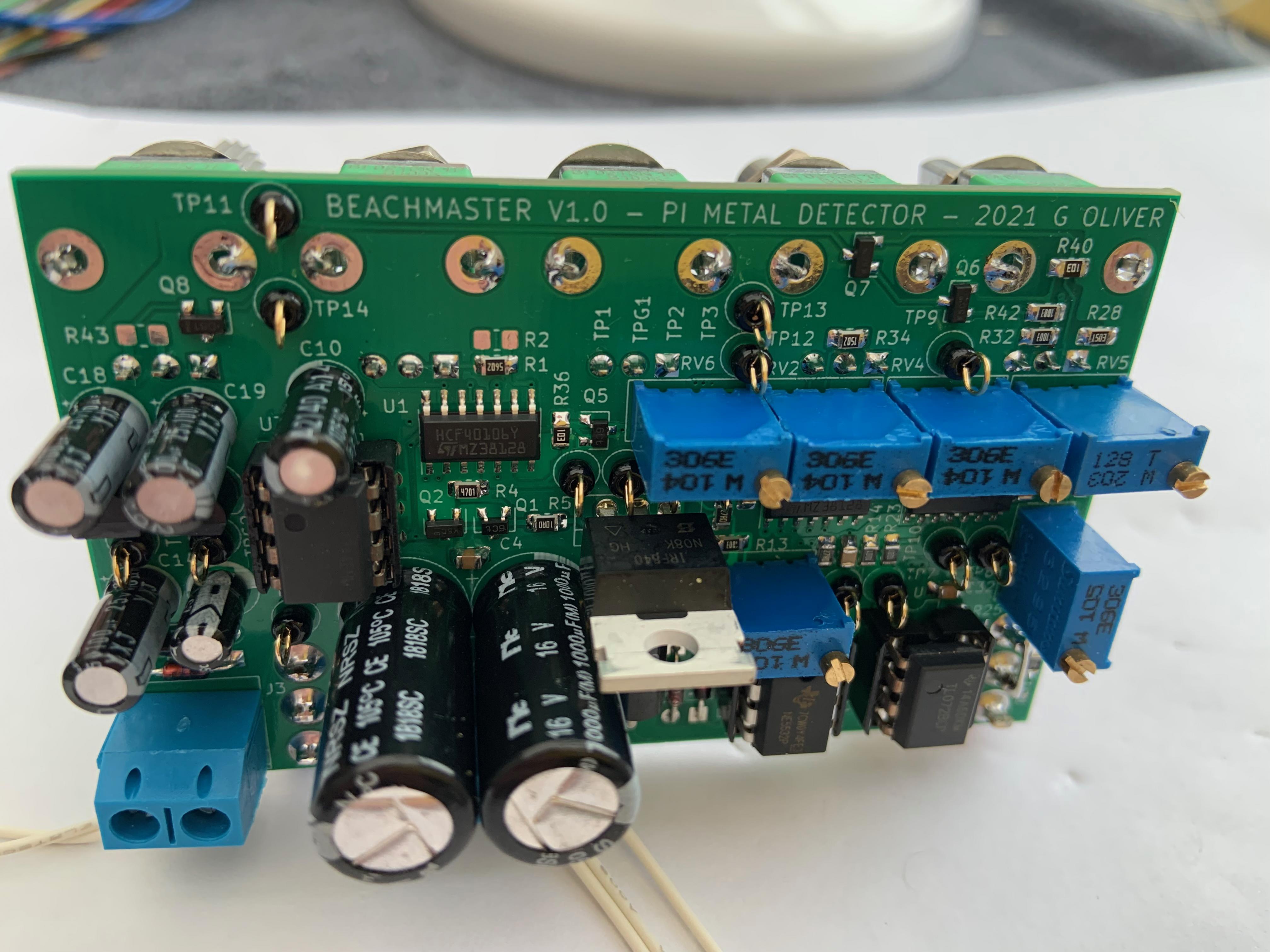

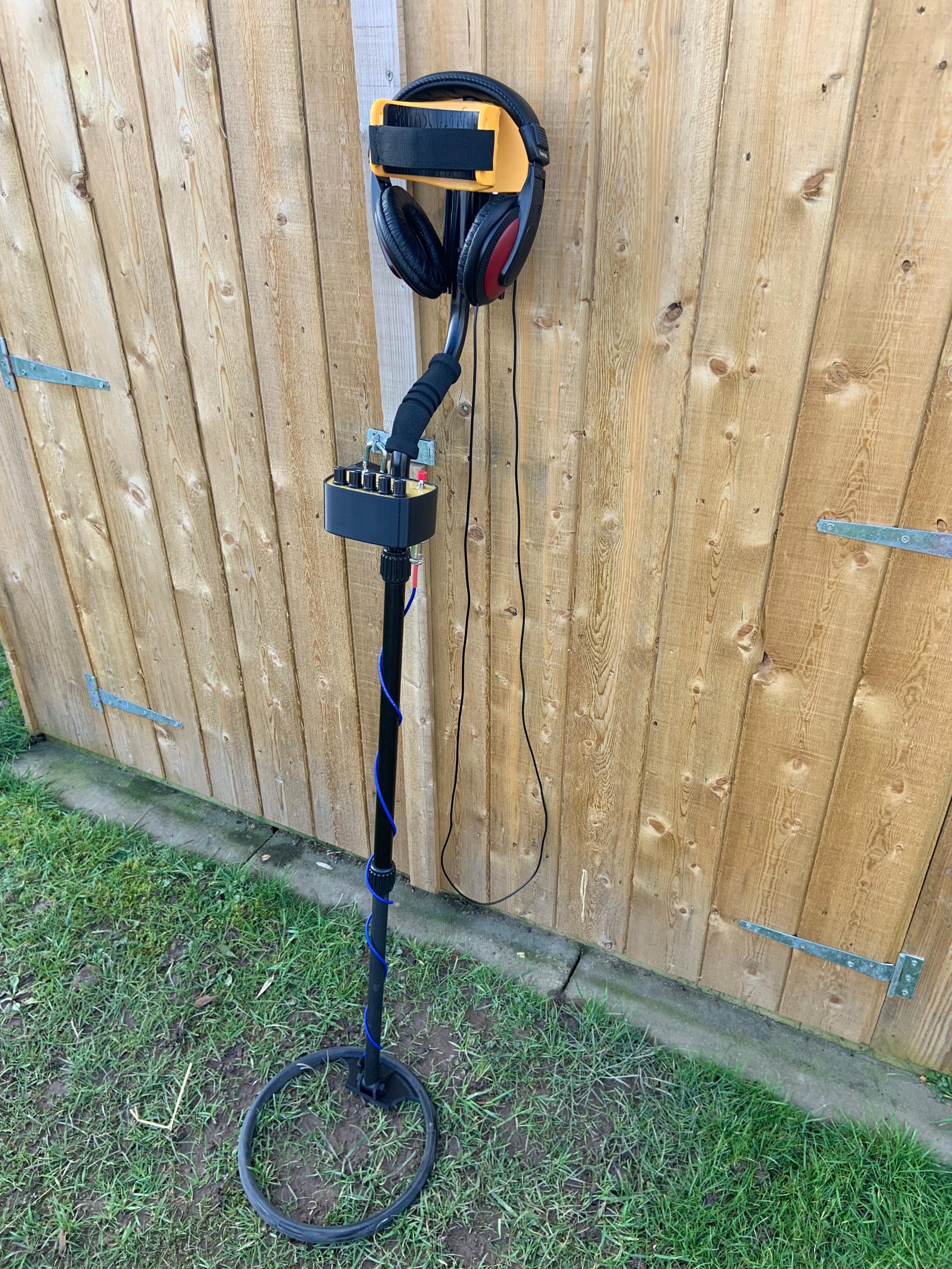

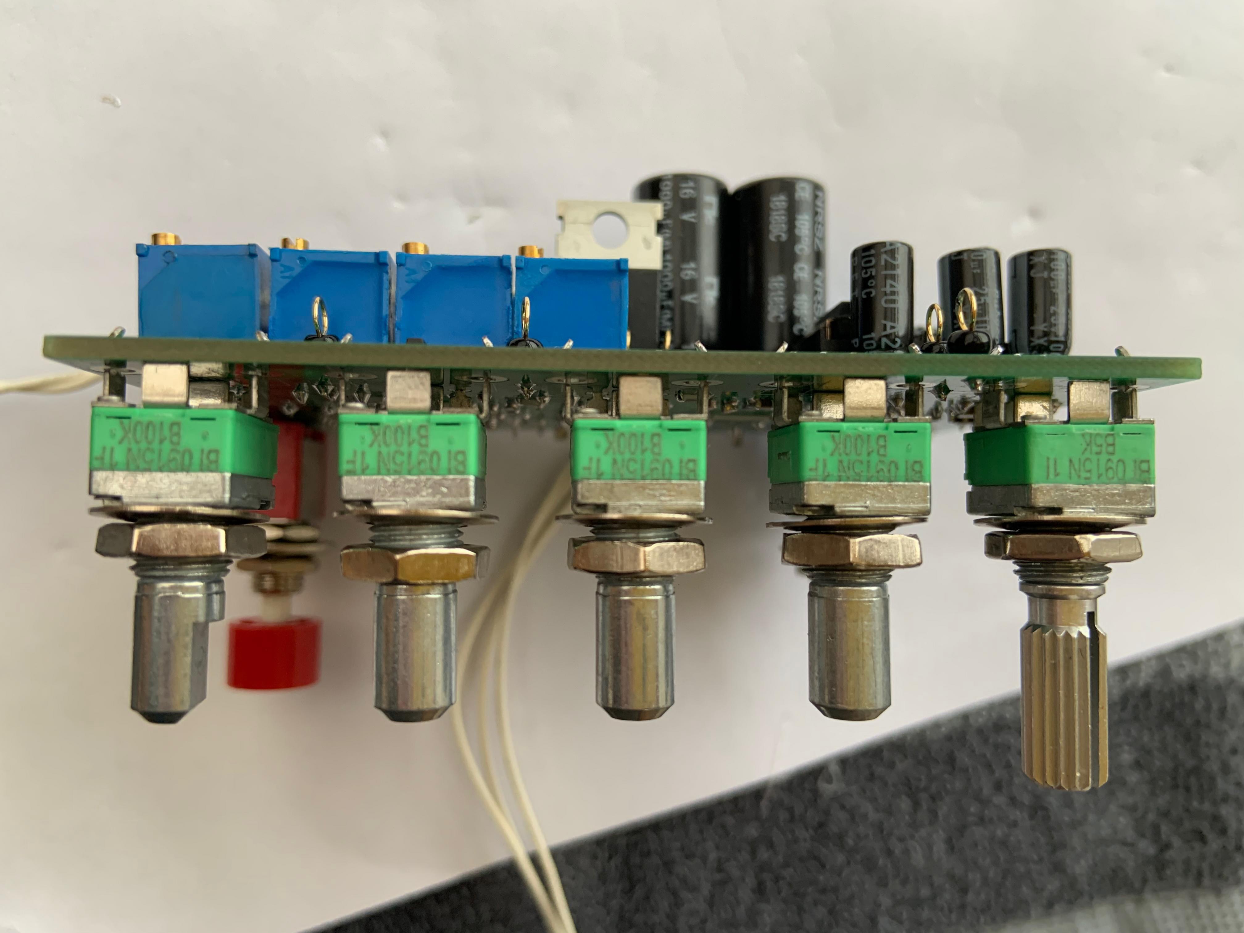

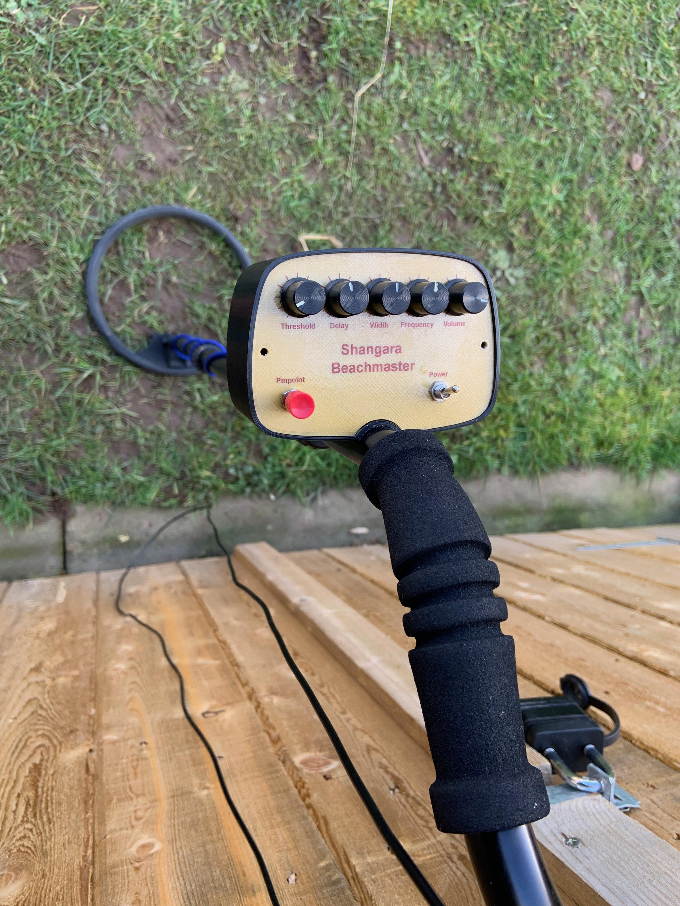

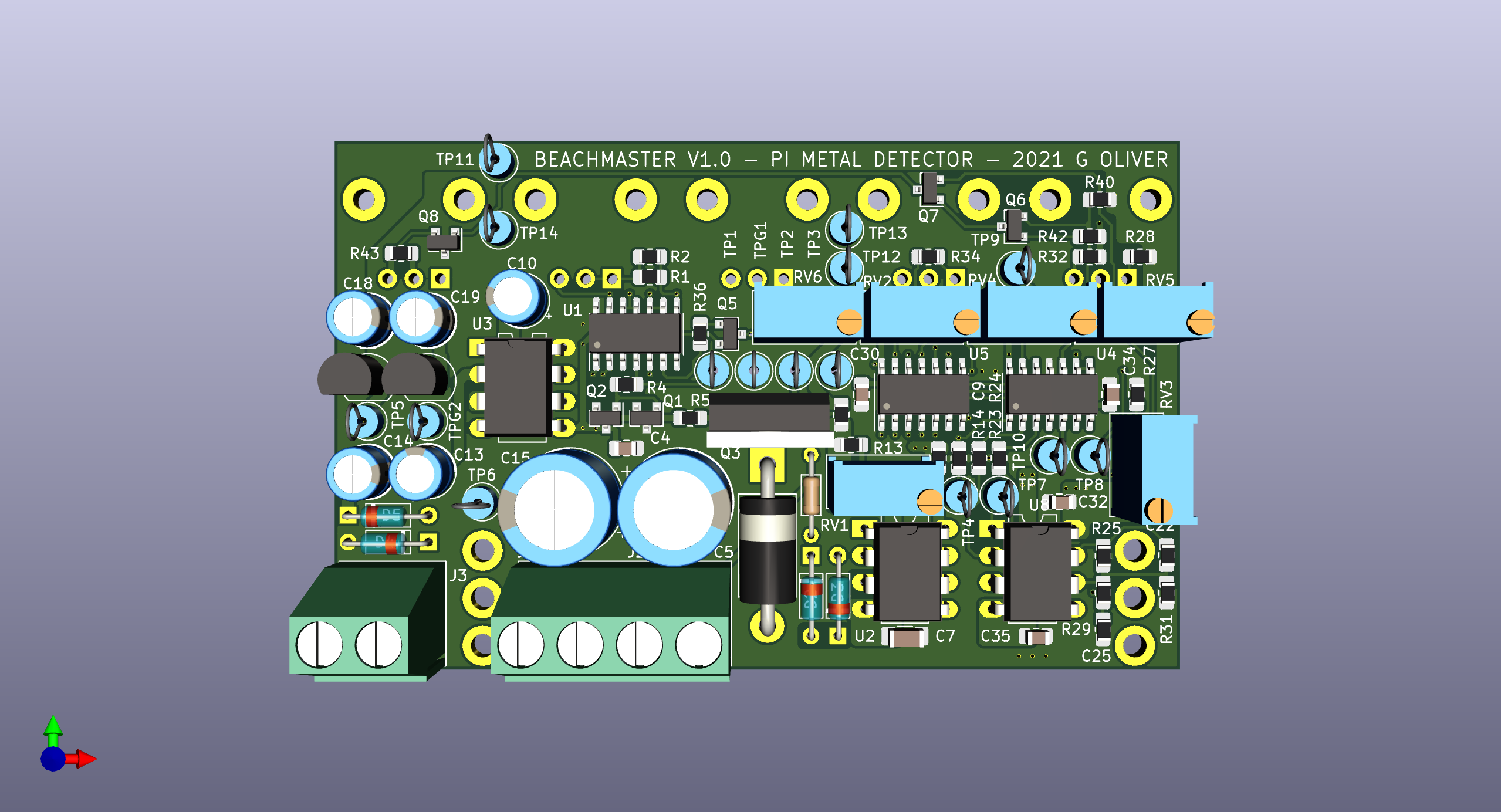

Hi all, I hate lots of fiddly wiring inside enclosures so have been working on a small and simple PI board which draws inspiration from some of the great projects on this site. (Hammerhead, Baracuda and the Arduino Nano PI), and also adds one or two little tweaks from my side. The main idea was to keep it as small as possible and have all pots and switches mounted directly onto a 50mm x 80mm PCB. This does involve surface mount components unfortunately but I've kept resistor sizes at 0805 so not too tricky to assemble with a steady hand (and a good magnifying lamp).
I've built up the first one and so far testing has been very positive - here are some pics as a little teaser.
Beachmaster.pdf
Will post further pics of the assembled board and some field testing reasults once I've got it all nicely wrapped up.
