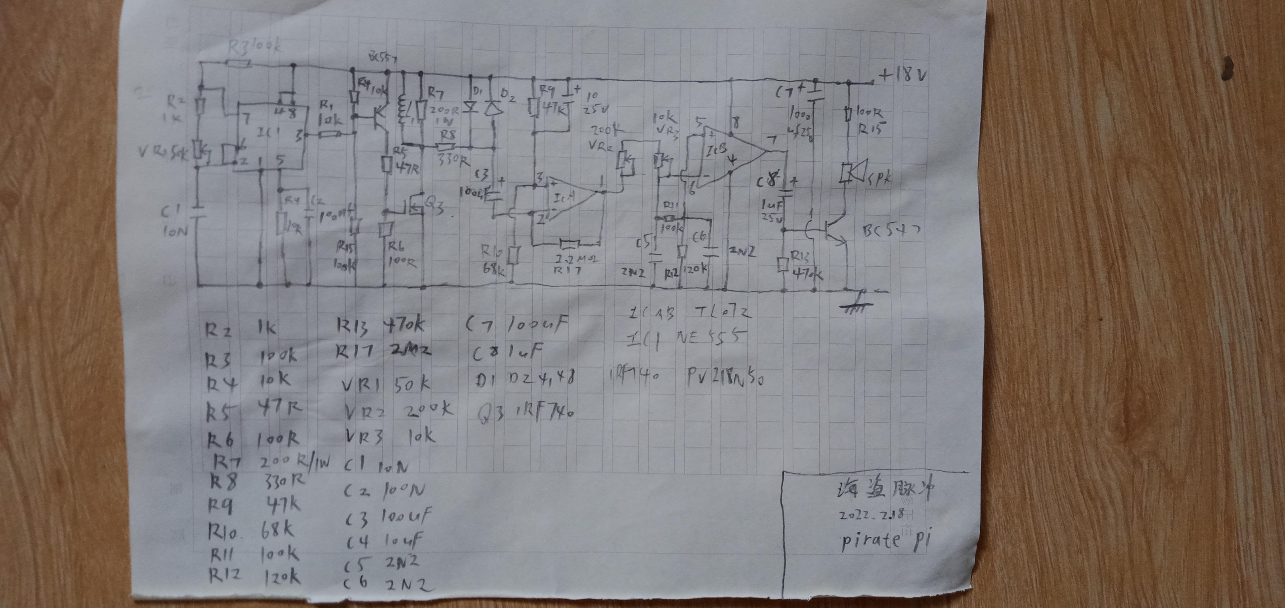

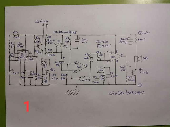

    I got the drawing from a group, and I redrew the clear version. I haven't done any tests, but the video posted by its owner shows it detecting close to 1 meter in the air, and the test item is something the size of a coin.

              One of the reasons why the PI can detect a coin in air at 80cm might be because the detector is running on 18V. And maybe the coil is perfect adjusted to the TX circuit.
                The Prirate PI is a nice simple PI detector. With the right coil adjustment and PI settings every PI detector posted in this forum should be able to detect coins at this distance (in air) as claimed by the Prirate PI. Probably the coil and how it was made plus the right adjustments are the secrete.... not the detector circuit itself.
                @Zoujiarui
                Do you have informations about the coil and how it was made?
