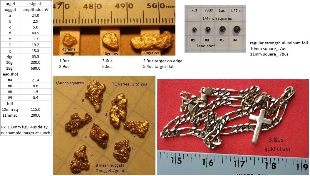

              Some gold nuggets and possible test targets. Didn't test gold chain today, it was borrowed and measured awhile back for time constant. I purchased the 1 gram of nuggets (a thru g) awhile back. #9 lead shot harder to detect than any of the nuggets. Nugget e a little less signal than #8 lead shot.

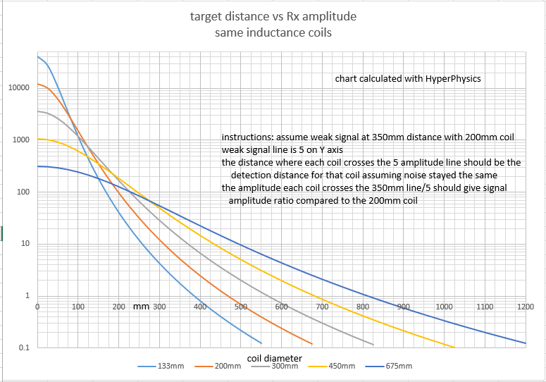

              Nuggets vary a lot. Think, need to pick one of the lead shots for a desired target before defining coil and amplifier specs?
              Need about a 3 times signal increase to increase detection 1 inch from chart for 133mm coil.

                That's a nice collection of targets Green. That #8 shot is tiny.
