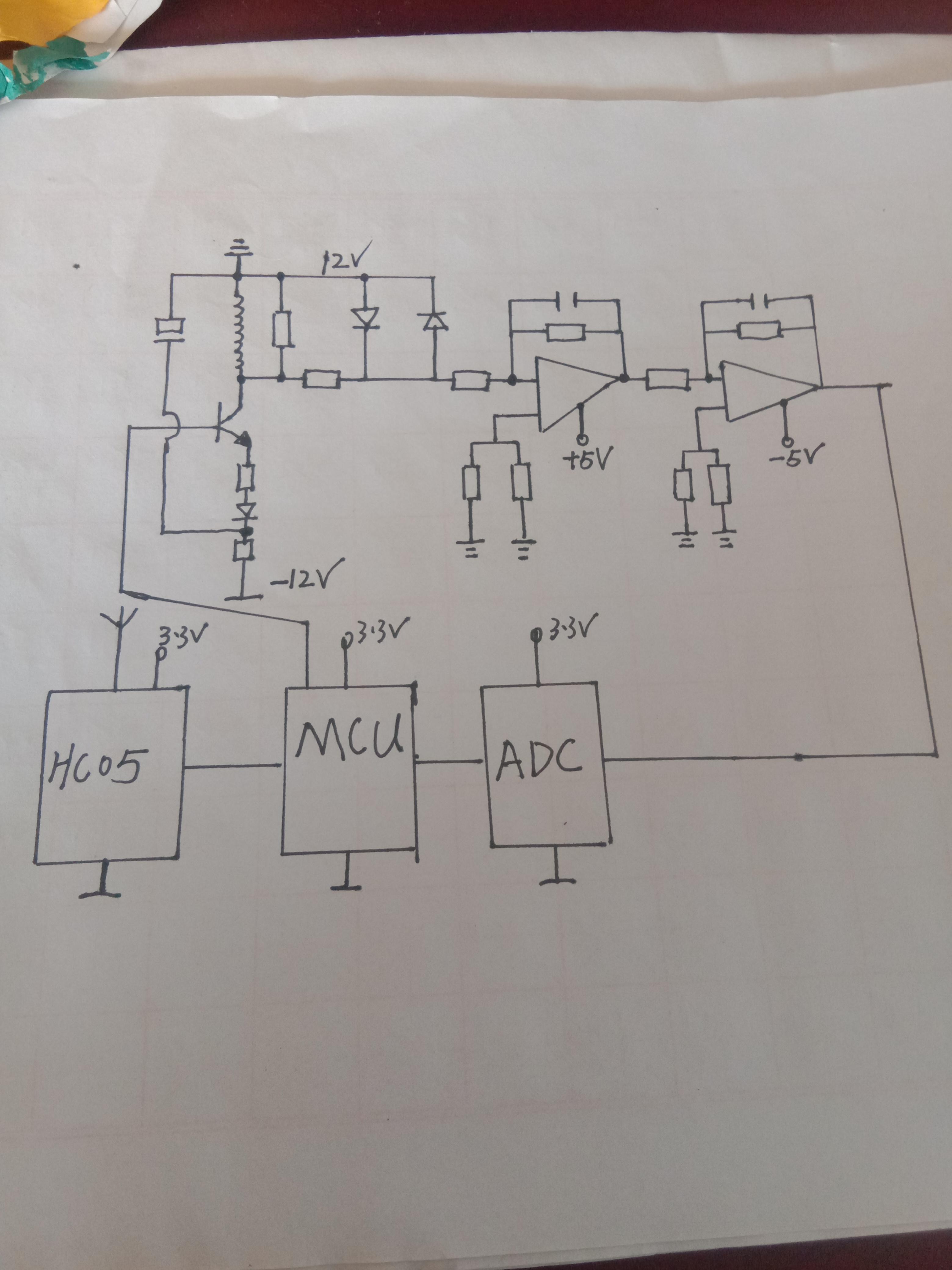

    Hello everyone! I want to make a wireless detector with Bluetooth and single-chip mechanism, because the op amp is required to be ? 5V level, single-chip microcomputer and Bluetooth 3.3V, then in this circuit, how should I generate ? 5V and 3.3V?Click image for larger version

    Why not run the opamp on 3.3V?
      Please give me a good suggestion and program, mainly the power supply of the op amp output is much higher than the single-chip power supply, how can the single-chip function detects the voltage of the op amp output
        If the 3.3V is connected to the GND, the microcontroller cannot detect the negative pressure of the op amp, if connected to -5V, then the op amp output is 10 volts, far exceeds the maximum pressure of the microcontroller.
          You would need to create a rail splitter to create an "analog ground" of 1.65V. Then you will also need to AC-couple the flyback to the preamp. The Pulse-4 project in ITMD shows how all this is done.
