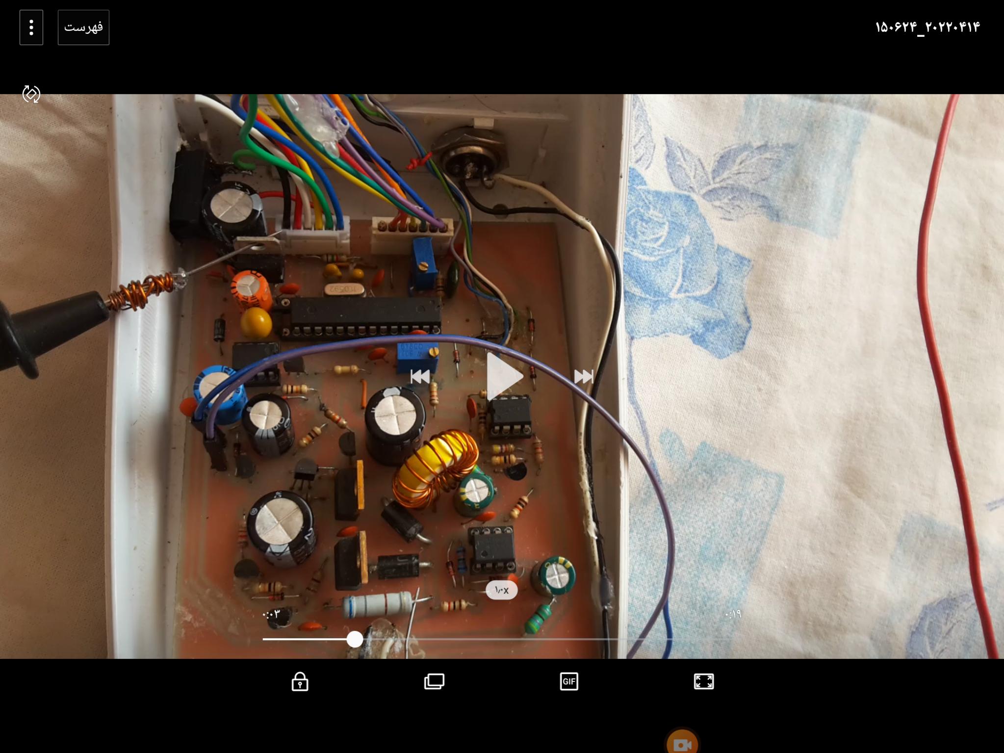

    Hi my chance pi frequancy suppose to be 185 Hz but it is
    2450hz and I don't know what is wrong ?
    is it to do with program 121 or fuse bit.
    Or isome thing wrong with hardware.??!!
    can any one help me??

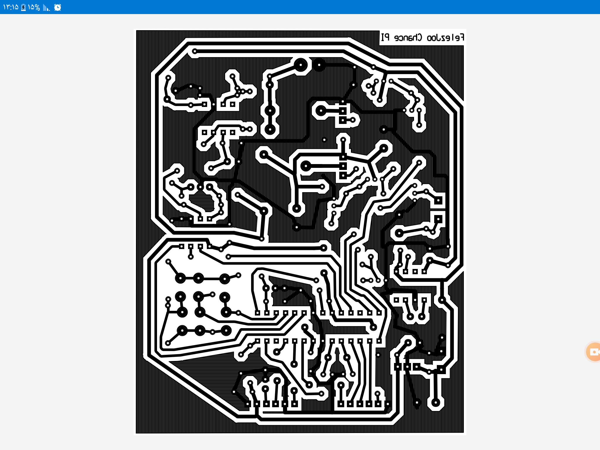

    there is alot , you should check trace and line of your pcb maybe some parts are wrong or you put them wrong or maybe you have bad coil winding
    it would be better if you add some picture of your completed pcb and coil then the masters of the froum help you better

      thanks for your fast response, yes I have the venue and discrimination ,every thing looks right ,but frequenc is 2.45o khz ,
      With the coil goes to 3.400khz,
      I show it to some engineer ,he test it with oscilloscope
      There was no since wave,
      I will put some pictures,.
      By the way have I made 3 of this metal detector.
      Thanks your attention

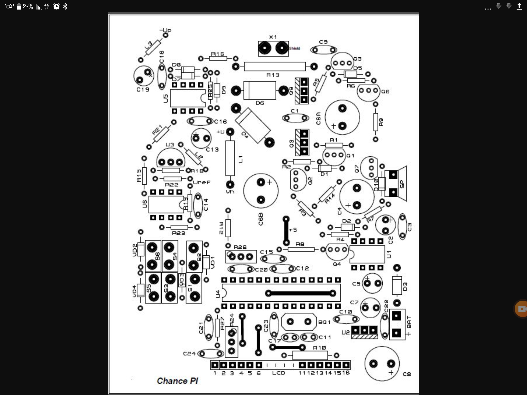

            It seem that you have another chance pcb than common chance pcb, (i look but not found it ) if you are sure about pcb and others so
            ok start debugging , look at Q9 and Q3 if can you see signal? or even offset? if no look at leg of atmega 14 and 15 how about that?
            regard HH

                Yes it is correct Persian version is little different with Russian circuit.
                I will attach a copy of circuit ...
                The high frequency starts from pin no 14 keeps on going to the r3
                then q2,q1,r1,q3...

                  Do you have a schematic for this project?
                    Chance pi
                    Not as such, I have this one as well that
                    I attached it for you,
                    thanks for your help

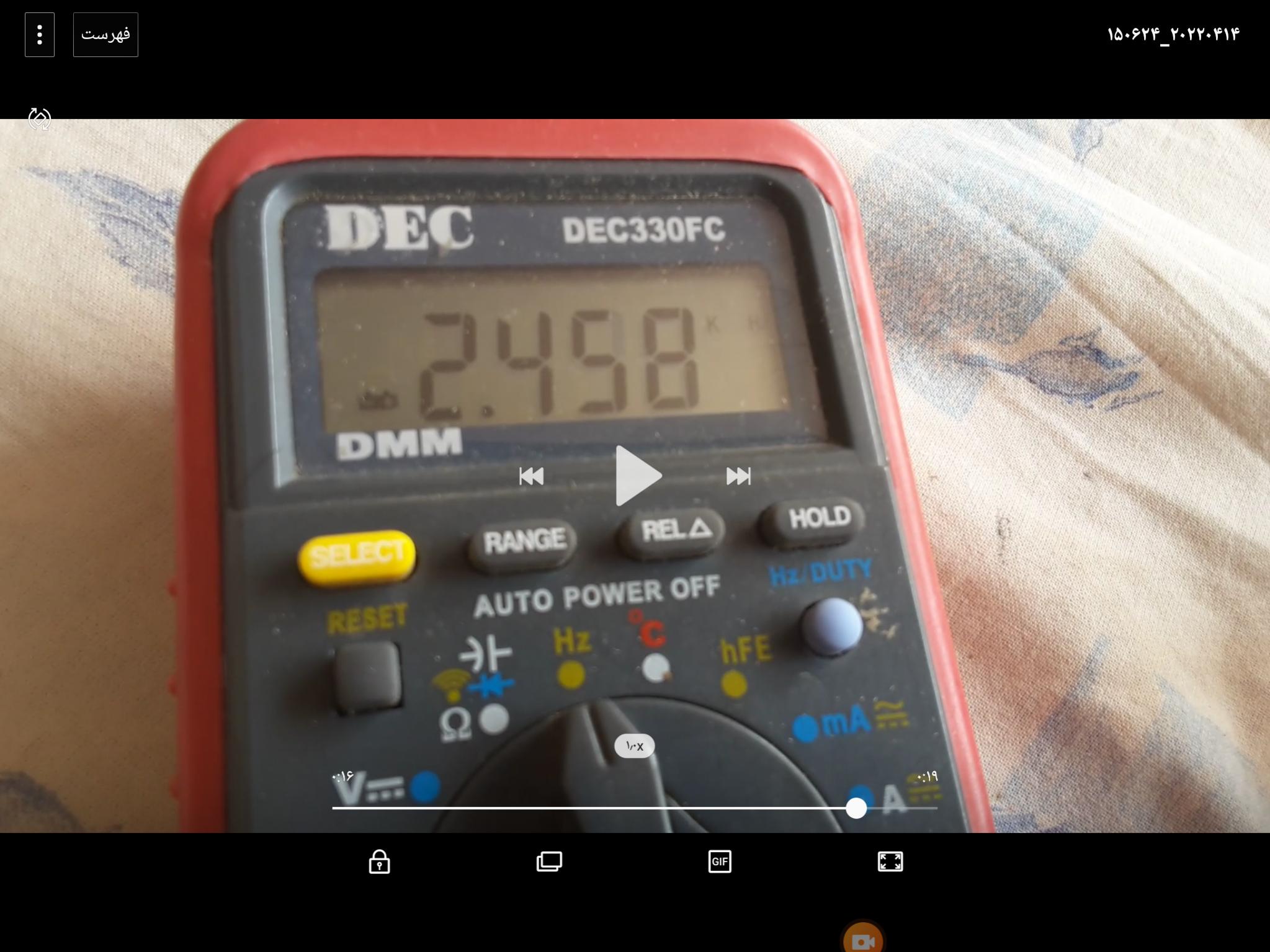

                      I test the frequency of my detector with few different multimeter and
                      Multimeters and two oscilloscope,
                      I had three diffrent readings ,some showed around 2.5HZ and some showed
                      2.5. KHz. , Unity brand multimeter showed 98HZ.
                      Wondering world !!!
                      Surprising!!
                      I don't know which one is correct?
