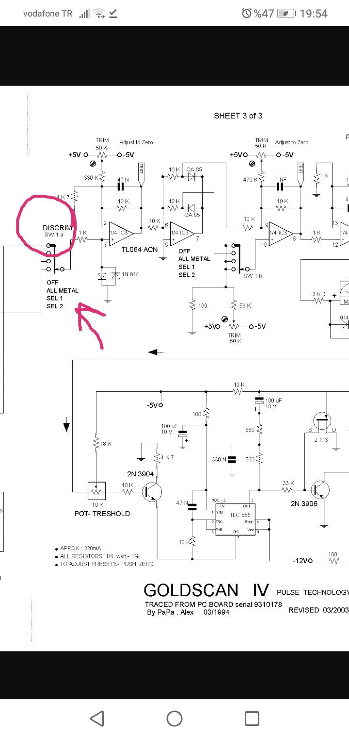

            The Goldscan is a 2-channel PI for ground balance. You can also use this for a crude low/high conductivity discriminator but it's VERY crude. If you set it to reject iron (like nails) it will also reject silver coins, for example. There is no PI design that has a VLF-like discriminator.
