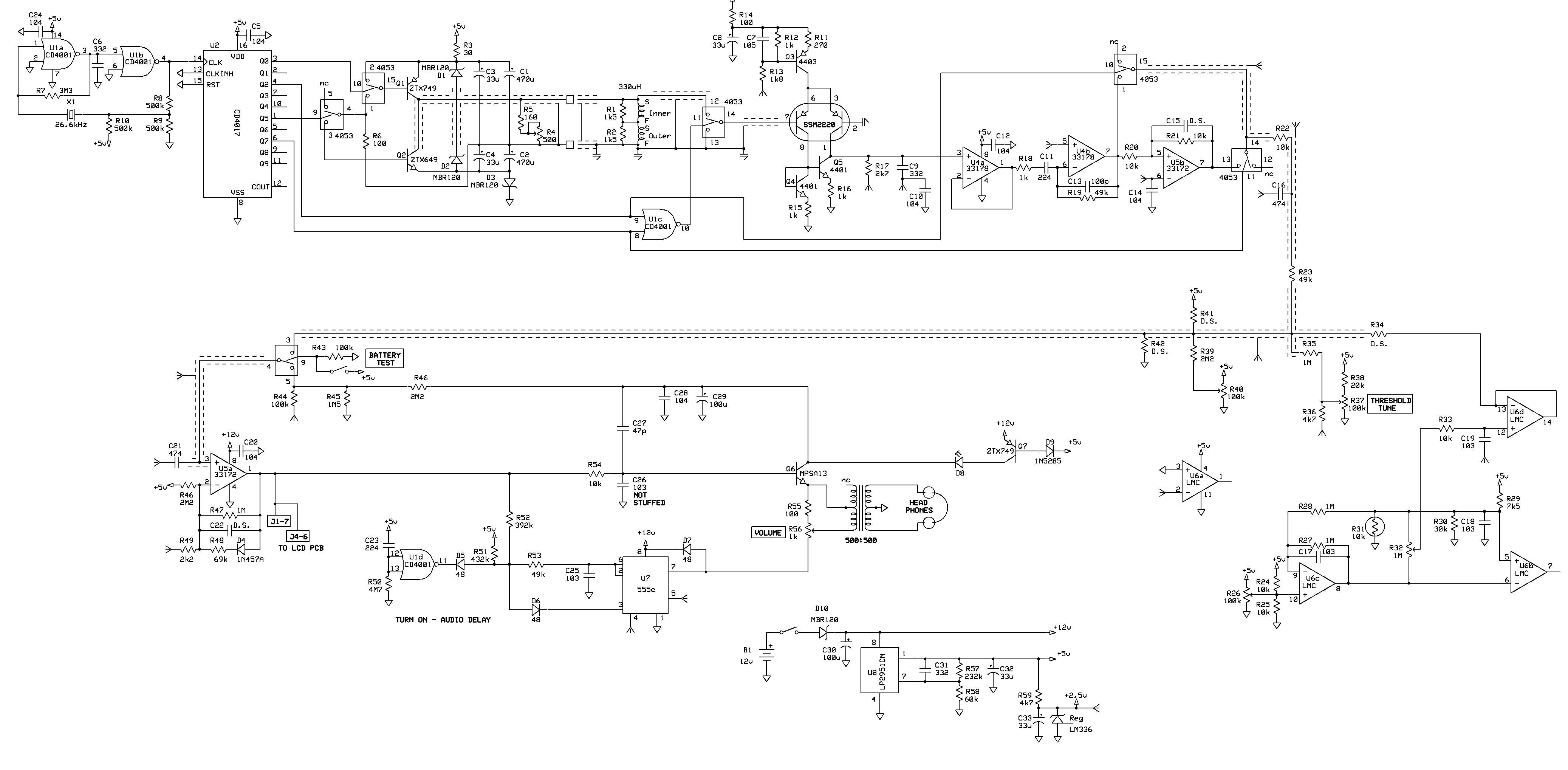

    Difficult pulse metal detector, who would like to redraw the schematic and PCB?
    It is the latest advanced pi detector in the forum. The first problem is that its schematic is difficult to understand, with some rare or professional symbols on it.

              I just redraw it. Most awkward and annoying schematic that I have ever did so far!
              Few "fishy" and highly doubtfull moments in the schematic.
              Not to mention some obsolete components.
              And now when is drawn better and became readable; it is easy to see that it is obscure design.
              Some "moves" on the schematic are weird, I assume it was design by some egocentric, a self-centered self-loving maniac!
              Here it is, enjoy!
