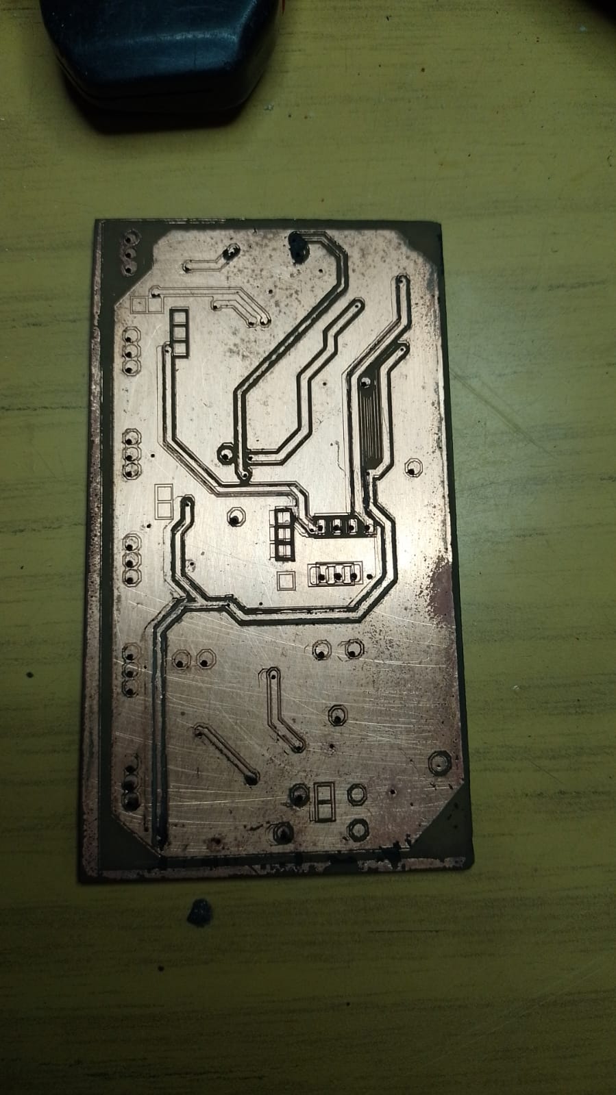

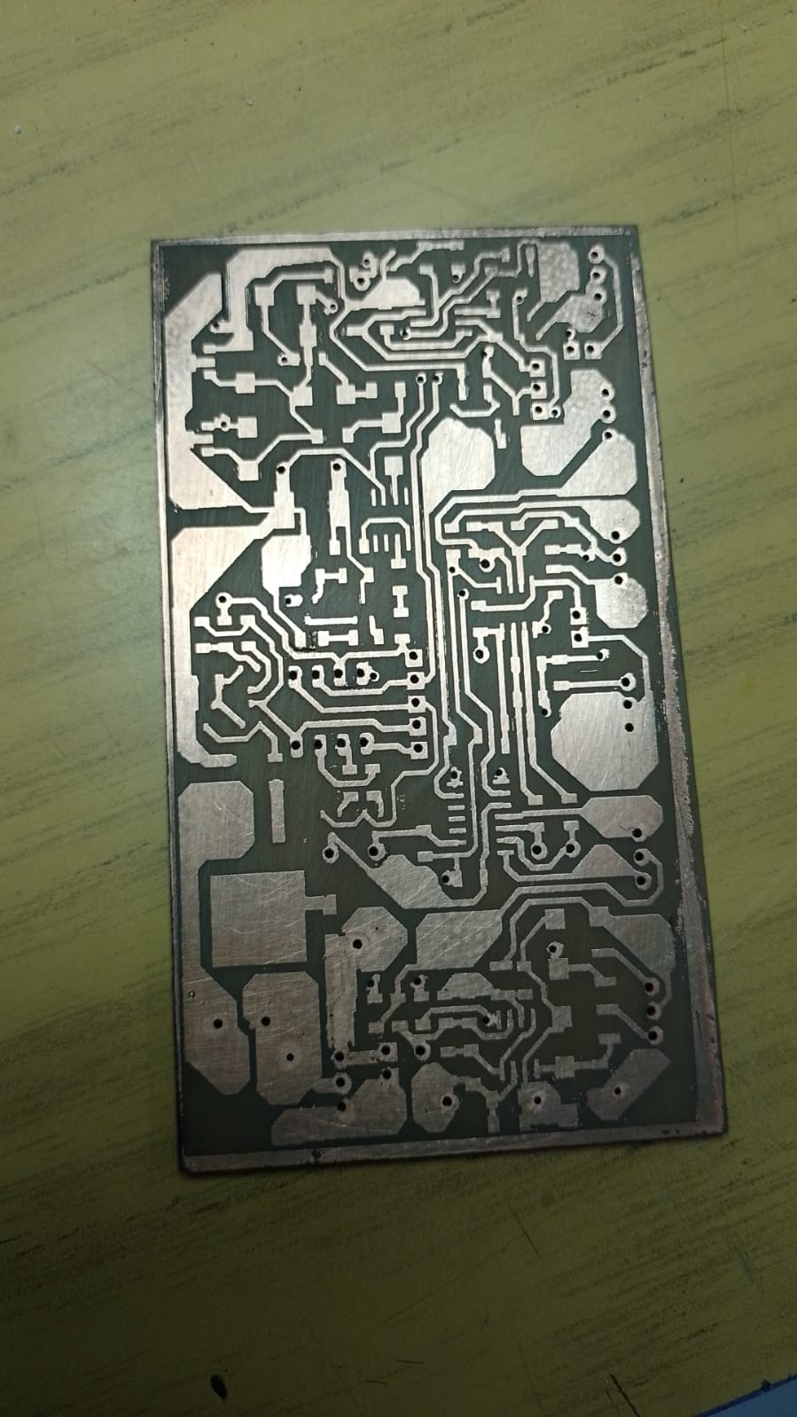

                              hi walt... i have finished my pcb and i am going to start assembling the components, do you recommend i make a new thread to show the development and discussions of the HH2 SMD?
                              Dario
                                Dario
                                [ATTACH]58005[/ATTACH]
                                [ATTACH]58006[/ATTACH]
                                I will be very interested to see how this detector performs
