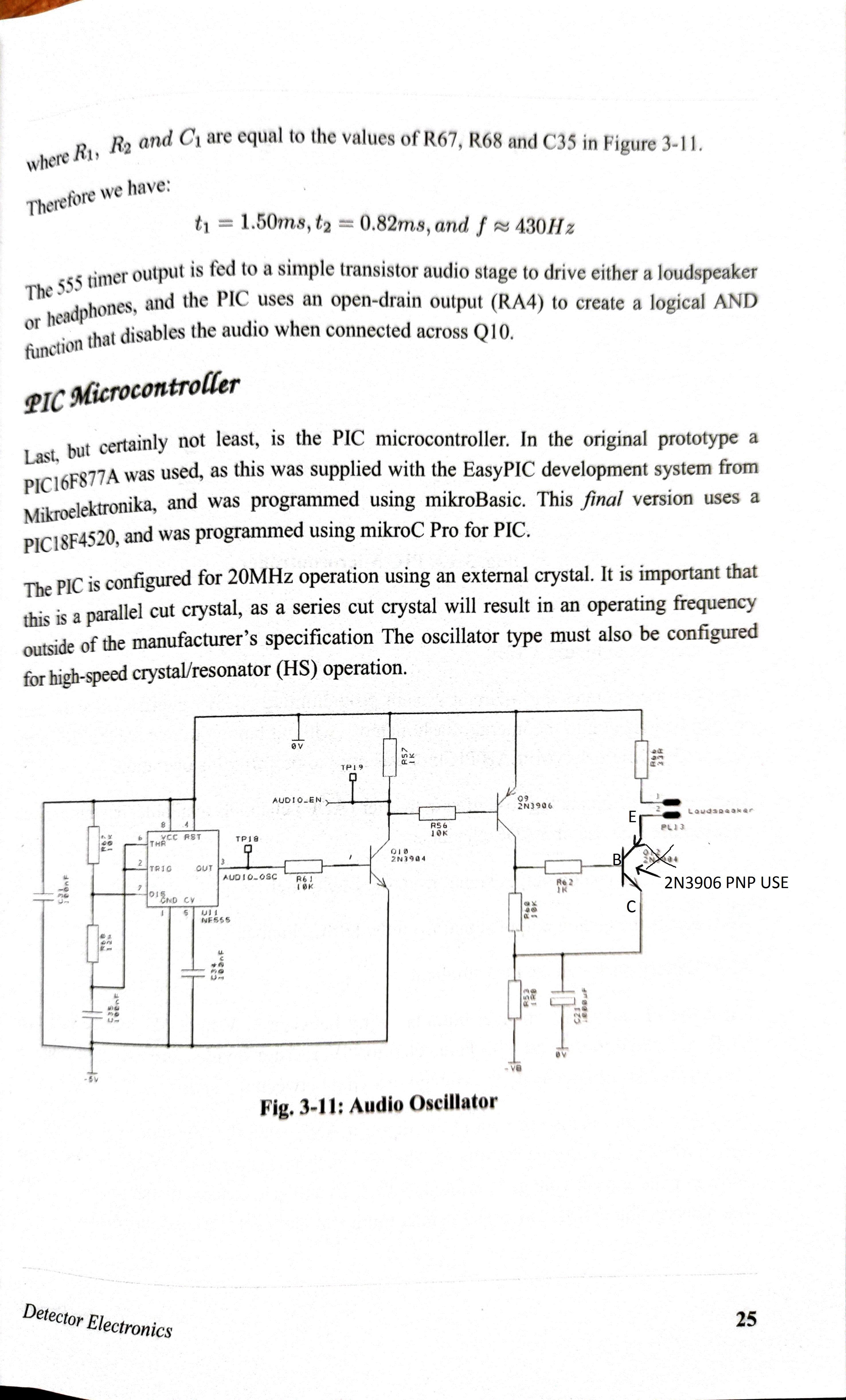

problem on the voodoo project
In the Errata section here -> https://www.geotech1.com/forums/show...d-October-2020Originally posted by nandimonay3 View Post
Point number 5 says: Page 88, Component Parts List (Miscellaneous) - speaker / headphones should be high-impedance.
No doubt this is the problem.
If you have a few hours, read through the Voodoo project posts. You will see that other people have experienced a similar problem and have offered suitable solutions.Originally posted by nandimonay3 View Post
