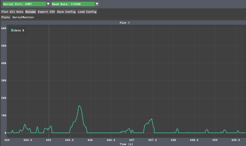

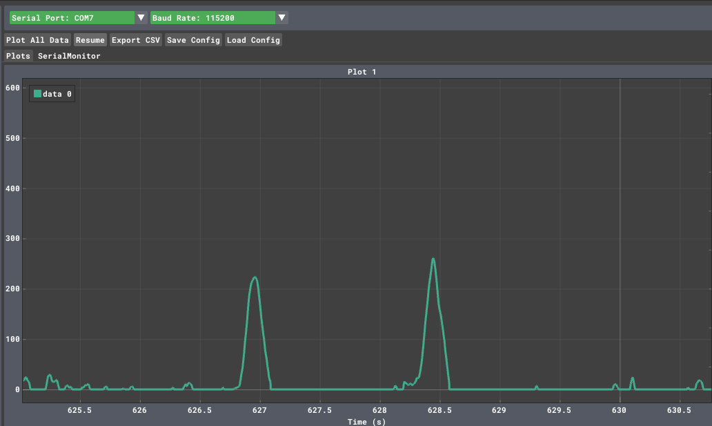

                The 15-bit version is much more stable.
                Here's the 15-bit signal after EF and background subtraction.
                The two largest peaks in each graph are the signals of a 0.7g nugget at 7cm (top graph) and at 6 cm (bottom). The rest is the noise.
                One tick of the Y axis represents 2uV at the preamp's input. (Vref / resolution) / Gain = (1.1V / 32768 ) / 17.
