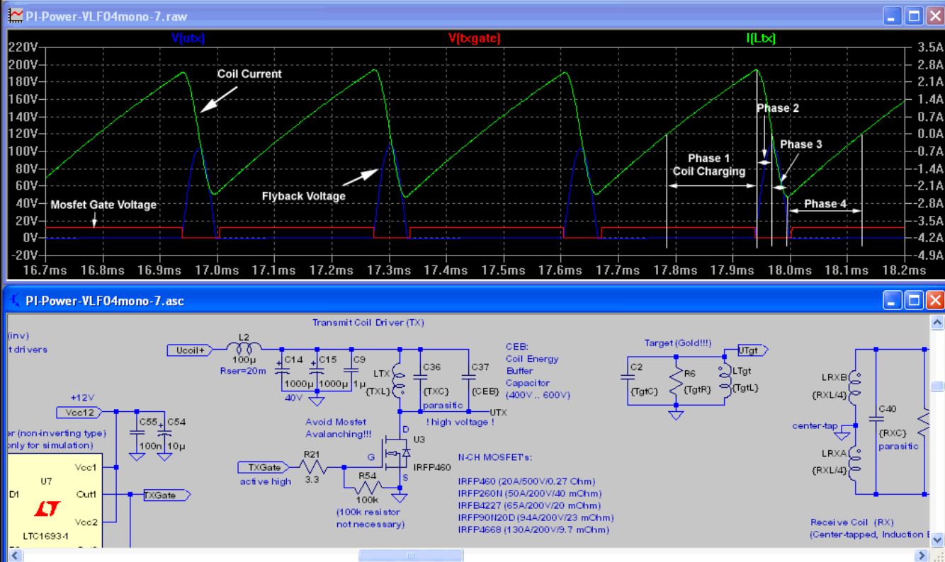

            Have a look at phase 4 enhanced, the mosfet is again switched on towards the end of the coil discharge, to compensate for losses. But this gate pulse appears to be of much shorter duration than the drive pulse. So there appears to be a timing scheme involving the gate logic. Maybe at this point, the oscillations you describe are precluded because the residual energy in the coil cannot flow into the buffer capacitor. For this to be plausible, the coil voltage supply would have to be disconnected through this phase. ????
            It seems to me that there must be a timing scheme involving the gate logic and the coil supply.

              This is when Phase 4 enhanced is supposed to kick in( another shorter pulse at mosfet gate ), precluding any possibility of oscillations, because the buffer capacitor cannot charge, because the coil supply is simultaneously disconnected. The remaining energy in the coil now must return to the electrolytic caps.

              "Phase 4 enhanced" reference to Aziz post #819

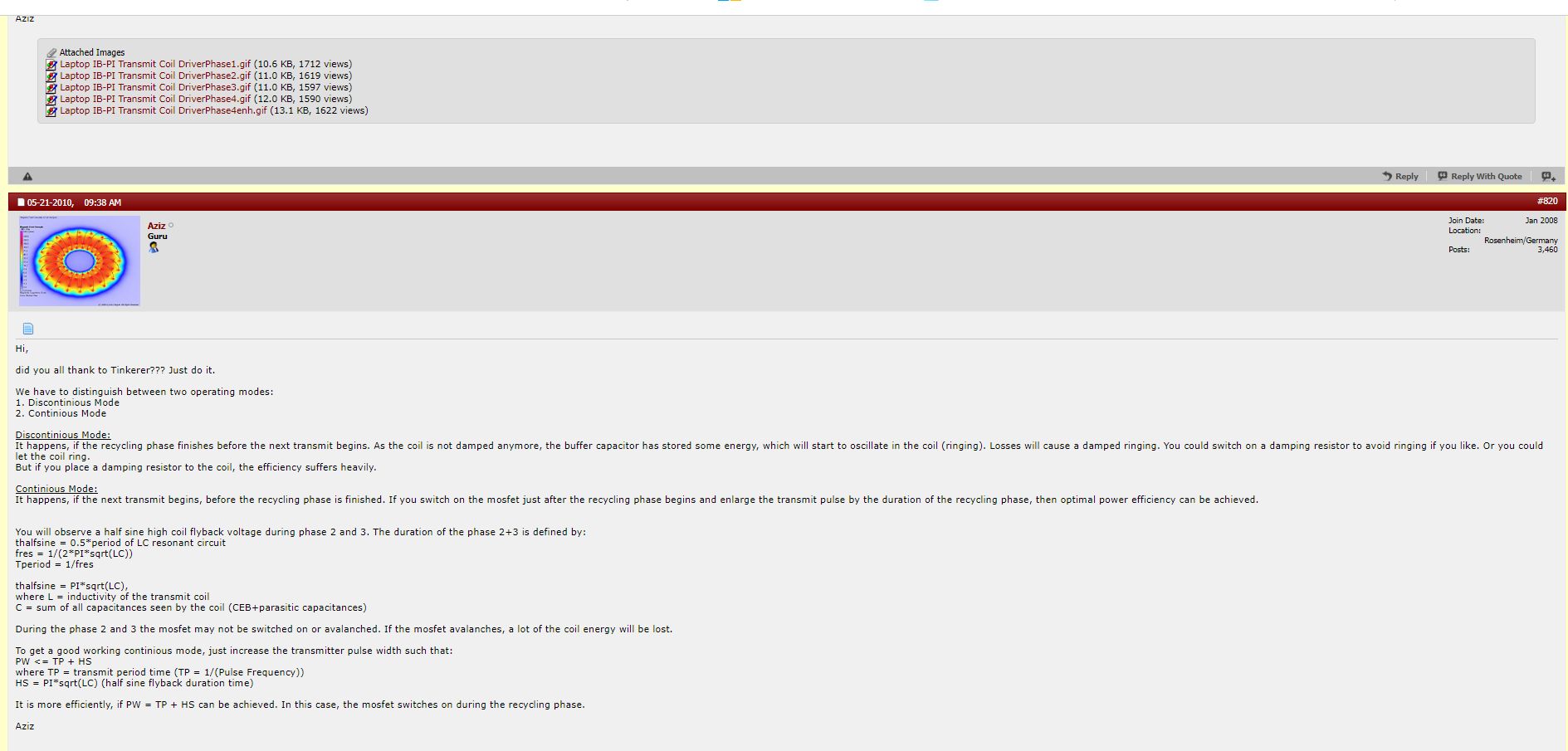

                        That would be great - exactly the computer simulation i wanted to see . I repeat from my first post here is a link to the circuit - Thread: Let's made a PC-base metal detector with usb interface !!! , page 33 , Laptop IB-PI Transmit Coil DriverPhase1.gif (10.6 KB, 1711 views) - ( #819 ) . The pulses to the gate IRF740 are 150 microsec. long , pauses - 1350 microsec. ( 9 x 150 ) . The first capacitor , which I tried was 33 nF . coil - 1,5 mH / 4,5 ohm. Power supply - 9 volts . The shape of the current through the coil is as here- File Type: gif Laptop IB-PI Transmit Coil DriverSignals.gif (42.4 KB, 1157 views) - (#821 , page33 ). Only in my case during pause time damping oscillations are observed with an initial amplitude about 1/30 of the second peak current . They have a small but noticeable amplitude even after 1350 microsec. It is . Now the ball is in the court of computer simulations...

                          As Aziz thanked me for the circuit, I feel obliged to give you some further explanations on how it works.
                            Triangular
                            Screenshot of the simulation. This is correct.
                            How does your waveform compare with that?
