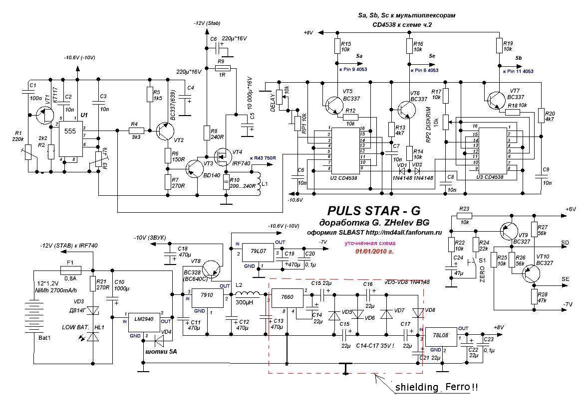

          Hi,Geo! Happy New year 2013 to all !! Puls Star - G , "I have a 10mv ripple at power supply" (Geo). FINAL TEST :Power supply only AKU !! AC power supply ..NO!! OFF TV! Final test ...the fields, the woods! Not in the city !! Discriminator WORKS! "FERROS" and "NONS FERROS". Discriminator "FERROS" > 99% real. Alominium (Al) >shows ...FERRO! ALL PI DETECTORS, for aluminium (Al) >diskriminator shows > FERRO. Sorry for bad english. G.L!Regards[/QUOTE]

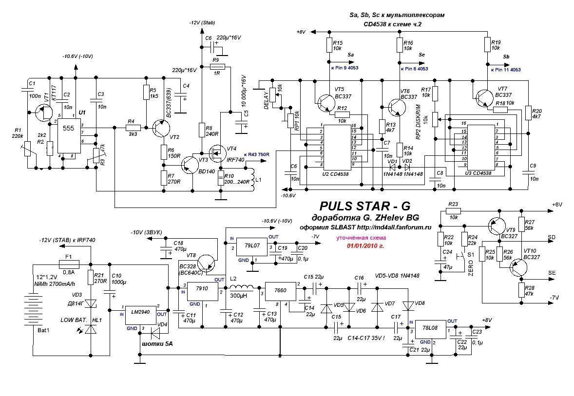

              • Hi Georgi and Happy New Year.
                I solved the problem with the ripple, it was from the power supply.I connected a battery and its OK. Now i have another problem. I can't take 0V at pin1 of U7A. With RV7 i can take 0V at U6A but with R8 i can't take 0V at U6B. I can't understand what is happening!!!!! Pin6 of U4 is +0.2V. Yesterday i made a test with a pcb 10x10cm and a soda can. I had not good depth, but it detected them a ferrous and as non ferrous. The same for a coin and a screwdriver. This is the reason that now i want to adjust it so to have good depth.

                    • Hi Georgi.
                      Schematic is the same. Waveforms are all the same with yours except that the pulse voltage is about 450V and not 600v. RV11 is potentiometer and with it i zero the leds. I have not connect any instrument. Depth is 16cm for a 1euro coin. When i press zero, both leds stop lighting, and when i put a coin near to coil, lights the green led and when i take the coin far then lights the red until to press the zero again. Why????
                      Also i can't zero the out of U7a. I replaced the IC-7 without results.
                      Any idea???

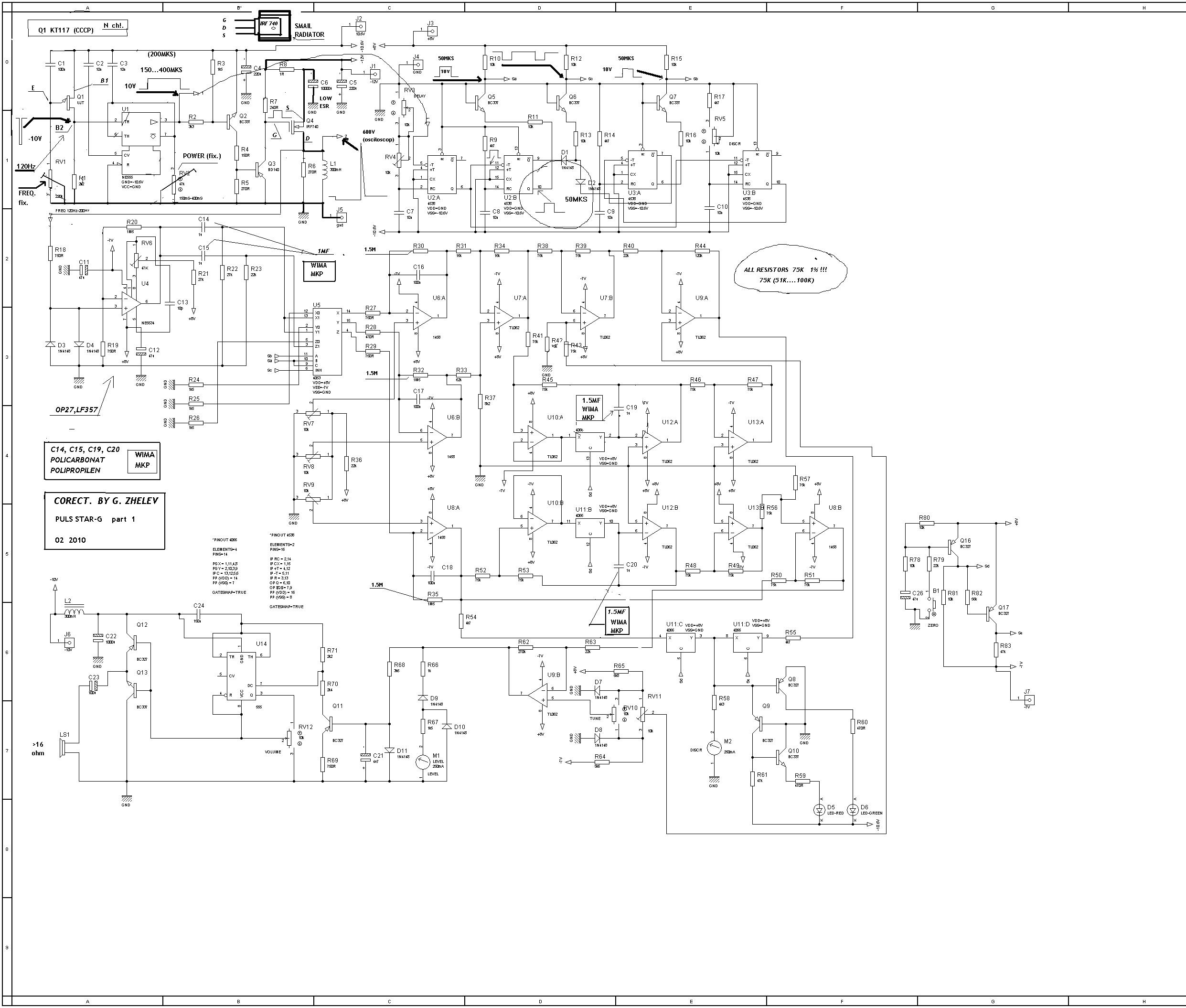

                      • Sensitivity of the discriminator is 60 .... 70% sensitivity mode all metals. Sensitivity LED is a small ,instrument microamp. sensitivity at large, using instroment mikroampermetr.OK? "Also i can't zero the out of U7a" (Geo) , Chenge U6, NE 5534 pin 6 ...-0,2v. Use LF 357 or OP 27 (no OP37) .Pulse voltage > 600V to osciloscop .
                        • Originally posted by georgi.g.zhelev View Post
                          Thanks georgi.
                          I replaced the 5534 with other 5534, with LF356 and with LF357 but i had the same problem. I am sure that there are some errors, but i have to get the schematic from start. So, why to have smaller pulse??? I don't use the Q1, but i use the 555 as astable at 125 Hz frequency with pulse of 150 us. After it all are the same as at schematic. Coil is 315 uH with 1.2 Ohm dc resistance. Battery voltage is 14,4 V. I checked the pulse with both channels and with different probes.
                          Any idea????
