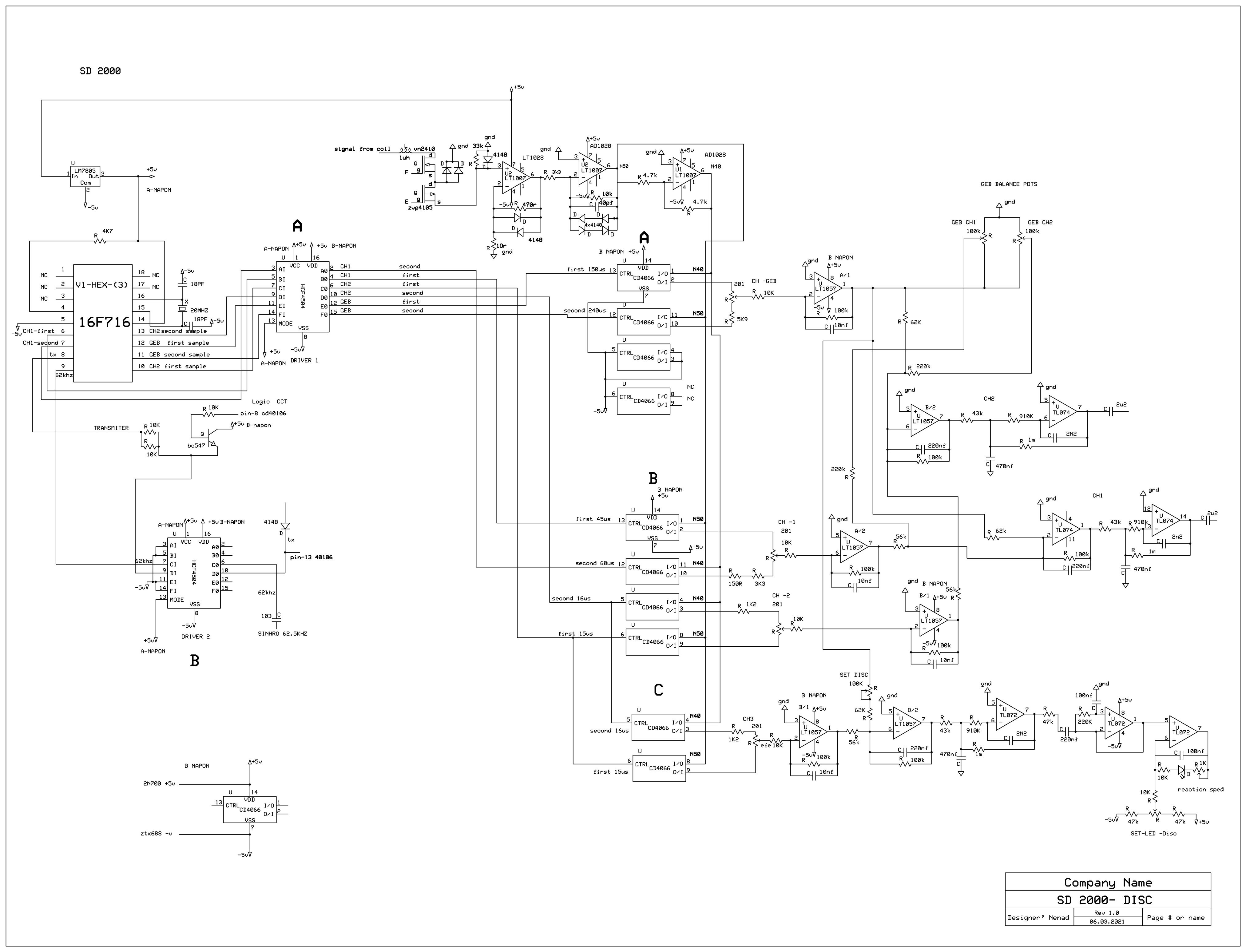

                  Who wants to play with the sd 2000 or 2100, here is a mod for similar discrimination as on the tdi, the led on the iron dims and on the high conductors it lights up more​.Click image for larger version

                      Who wants to play with the sd 2000 or 2100, here is a mod for similar discrimination as on the tdi, the led on the iron dims and on the high conductors it lights up more​.Click image for larger version  Name:	discrimination-LED-sd-2000-2100.jpg Views:	218 Size:	824.4 KB ID:	412877
                      Many thanks for this mod! Incredible! Somehow I missed this post. But, is it possible that you will share the hex and fuse setting for this? Thank you Sir Orbit
