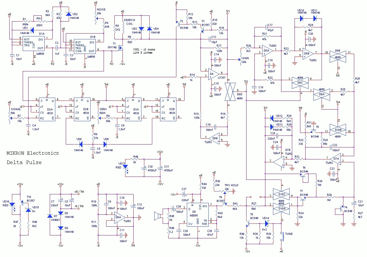

        Is this schematic correct?
          all schematics are correct. your board is not corresponding to them. it is uncorrect just.
            I downloaded the pcb from internet and not designed by me..maybe there was some error in it ..
            If I follow this ,should solve the problem right?

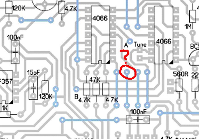

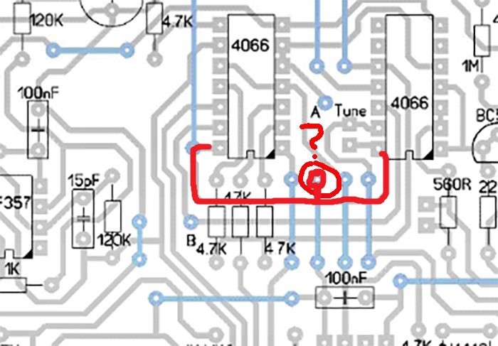

                check every track. begin from this.Click image for larger version
                  check every track. begin from this.Click image for larger version  Name:	Untitled-1.jpg Views:	0 Size:	77.2 KB ID:	413318
                  Mr kt315.
                  Click image for larger version  Name:	Untitled-1.jpg Views:	0 Size:	78.2 KB ID:	413321
                  There is a connection here as I have shown

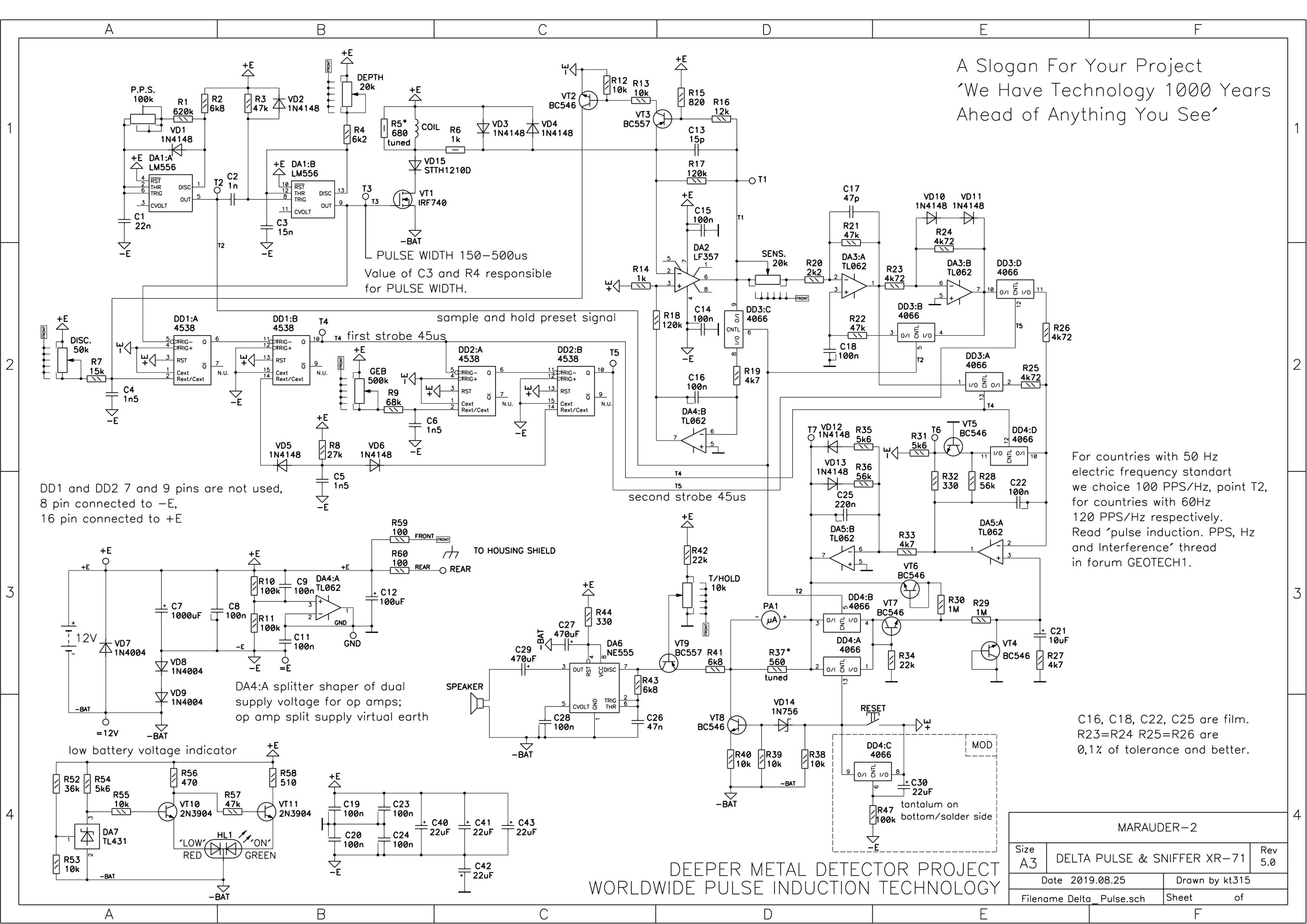

                    Hi Chamath,
                    This is another fine example why I do not trust readymade PCB's which are "floating around" in the Internet. The same is for schematics. When I analyse them, I always check and judge whether the circuit part could be correct or not. In more than 20 years I have seen only less than a handful detector schematics without errors. In almost every case was something doubtful, errors or they did not correspond to the PCB. That is fact, designers want to "protect" their work and do not really want that you copy their work easily.

                            i gave the pcb looking on the sea of complaints and tears. but they want to do 500-5000USD price detector for nothing. i bought THE VOODOO copy,
                            to give the people SMD board. 20 euro. i pay always, i paid for GMT KING COBRA sent from USA. i paid for COBRA II sent from USA. I paid for BOUNTY HUNTER IV.
                            they just take layouts 'floating around' in the internet very hoping do not waste two cents.
                            some pirates copied DP lay, they asked me to give pictures of both sides before. so they put the images in layers in SPRINT LAYOUT and do lay for half day.
                            BTW i learned P-CAD ONE YEAR. it is not joke.
