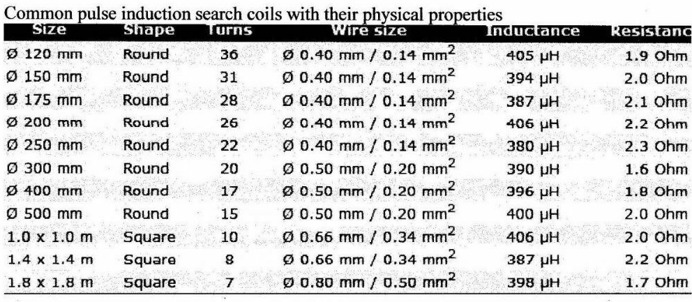

                I made a 60cm search coil. Took a 0.5mm copper wire. 25 turns
                Here the inductance is around 1343 uh. I think that inductance value has become a problem​

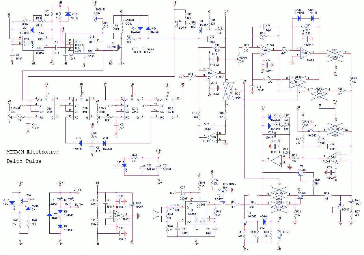

                  Hi Chamath,
                  in 2005/6 I made the Delta Pulse based on the Delta Pulse schematic. I followed very closely the diagram and the circuit worked fine at the first time. There was no error in it. Of course I made my own PCB.
                  I did not used one of the "ready made" PCB's which were floating around the Internet.
                  Here is the circuit of the Delta Pulse I used for my PCB.

                    I looked at this before and I saw that it works well in many places. My device is working but the problem is with searching depth.
                    Could a change in search coil affect this? What should be the value of the inductance of the search coil suitable for this?

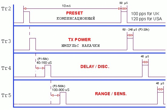

                      really the pots are:
                      - PULSE WIDTH. TX power. in old sch it is NOISE.
                      - FIRST DELAY. cut off nails. in old sch it is SIGNAL.
                      - SECOND DELAY. tune on your ground condition. in old sch it is SENS.
                      left are clear for you, i hope.
                        I think the inductance is much to high. Should be anything between 300 and 400uH. See below coil table.
                          If you look at the table, you see at a 50cm coil diameter a suggested # of windings of 15 only. At a coil diameter of 60cm it schould be somewhere around 12..14 windings only.
                            I have had this information for a long time.. This is a data record that can only be used for the clone pi metal detector type, right? I have used it before.. works well with those devices.

                              Sorry. I'm not really clear. Am I wrong in the diagram? I don't know exactly about it. I chose those places because they were pointed out elsewhere
                              Can you please give me the locations in order?
