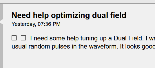

              This is what I see in the first post:
              Photos aren't showing.
              In any case, with the DF coil the overall damping R is related to the internal damping R (for the inner coil) so I assume there is a limited range of values for which the coil will work reasonably well. Question: are you trying to adapt a DF coil to the SMPI, or is this an SMPI-DF you are trying to optimize?
