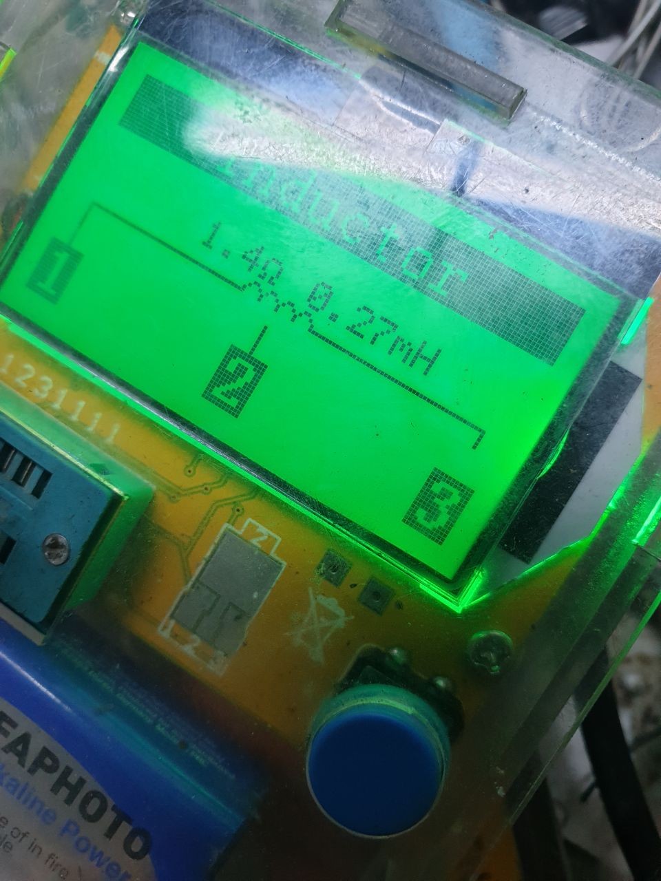

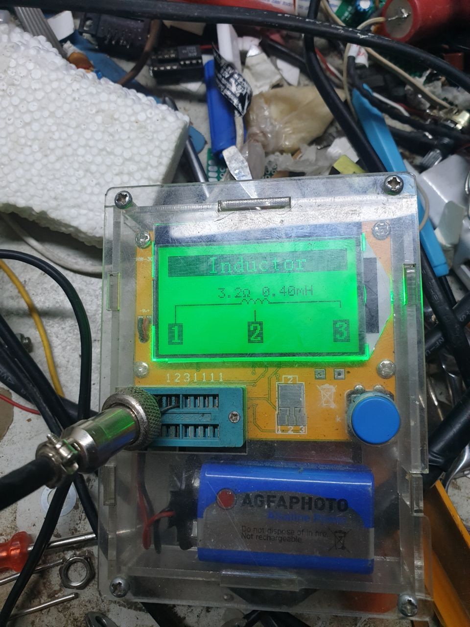

        intended coils to make specs:
        -COIL 23T, 0.5mm, 40cm
        -30T, 0.55mm, 30cm 420uH
        any correction is welcome
        video of the progress
        https://gemoo.com/tools/upload-video...70621106835456
          i do not see the standart reaction of DP work... sure seems you are just on start position of your longest way to first result (((
          coil for DP has to be 500-550 uH, but just for the test, not for fields job, you can use any L value - from 150 and above.

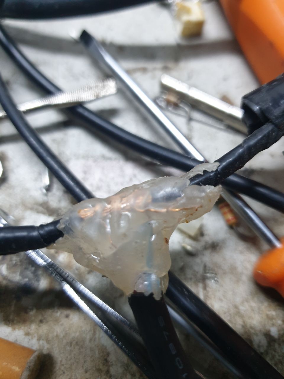

                My brother, i have managed to get the machine work eventually . It was ANOTHER bad potentiometer the 10k one and i spent couple of hours trying different 082 op amps and playing with pots the range varies but within 80cm with the small testing coil on a big object relatively. Still good because im still learning it's settings and it gets good depth sometimes when i change pots. I know some machines will work but never get decent depth mine looks fine no heating components or anything and everything looks healthy, i have gone through the forum today and found someone saying diodes could be the reason i checked them and changed the mosfet put irf740 but it was the 10k potentiometer, i suspect the reason is hot glue got inside them when i screwed them in the box. It's around 2 am here just finished with the md but tomorrow i'll post video, my plan next is look for different lf357n pieces, more tl082 until i get it working at it's best then I'll go to the discrimination circuit and lcd part and the big frame job. Hopefully everything goes smoothly. I appreciate everything you helped with and all the time you put replying.
