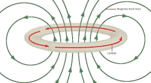

            Don't have any old coins, but tested an Australian 5c coin, and got the following:
            Coin flat (parallel to the flat detecting coil): Could be detected around 16cm if the coin was moved near the centre of the detecting coil.
            Coin on edge (perpendicular to the flat detecting coil): Could be detected around 14cm if the coin was moved near the outer diameter of the detecting coil, but only detected around 5 cm near the middle of the detecting coil.
            I'm now interested to see if I can model or measure the magnetic field distribution of my detector coil.
              That it is your the magnetic field distribution, when the coin is perpendicular to the magnetic lines it causes maximum distortion, when parallel = minimum distortion, so the behavior of your detector is normal.
              For the first machine, the range is good.​
                Click image for larger version  Name:	image.png Views:	0 Size:	69.6 KB ID:	418987
                Of course, makes perfect sense! I should know this, I'm a physics teacher and talk about mag fields and eddy currents! Brain has truly switched off since I'm in holiday mode.
