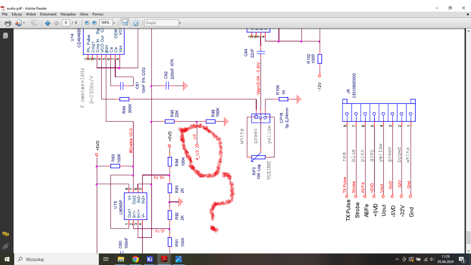

        • #49
          Analyzing the diagrams posted, I noticed errors in the description of the connections: 4_U3? , 3_U1? , U2? , 6_U3 ? Do you have the correct diagram or original?

            • #51
              Description of the outputs of individual modules in version PI+M DET. BALANCE 5 REV.B​

                • #53
                  Tomorrow I will mark it on the diagram, I am still interested in it, best regards​

                    • #55
                      Hello
                      How to read 4_U3
                      pin4 u3 is Vss I don't understand​
                      • #56
                        In used program for drawing of the schematics, the first number is the number of the page where this signal is directed. The name of the signal follows this information. This is not the name of the integral circuit.
                        • #57
                          The name of the program is Orcad.
