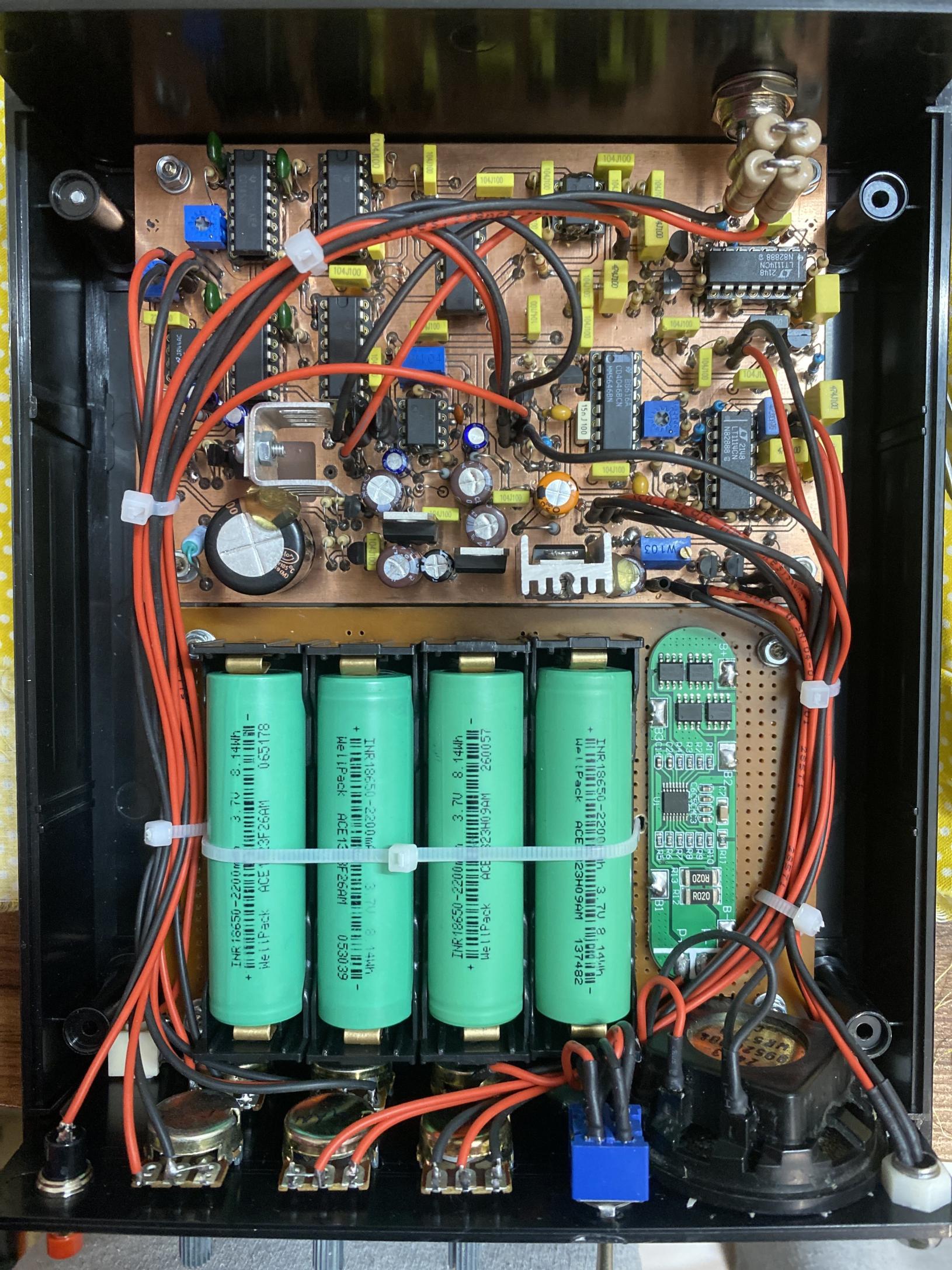

                    Hello Eduardo. I hope you are well. I am going to build this circuit. But before that I have two questions, please answer them. Is this pcb correct and does it work? And how is this pcb different from GS5litle in terms of depth and quality in general. Forgive me if my spelling is wrong. Thanks.
                      Hello. The PCB circuit is correct, as mentioned in the previous answer. I think this question is redundant and there's no need to repeat things so many times. The difference between the GS5 and GS6 is that the GS6 is deeper for high-conductivity targets due to the lower operating frequency of the detector. These two detectors require a good understanding of electronics, as they are not beginner projects. If you want to build a detector that works the first time, buy the ITMD3 book, where you'll find excellent PI projects with very good documentation and technical support. Good luck.

                        Thanks. I built the GS5litle that you posted on the forum. And it works fine. Of course, it took about a month to build and configure. Now I want to start this circuit.

                            Gs-5 liteClick image for larger version
