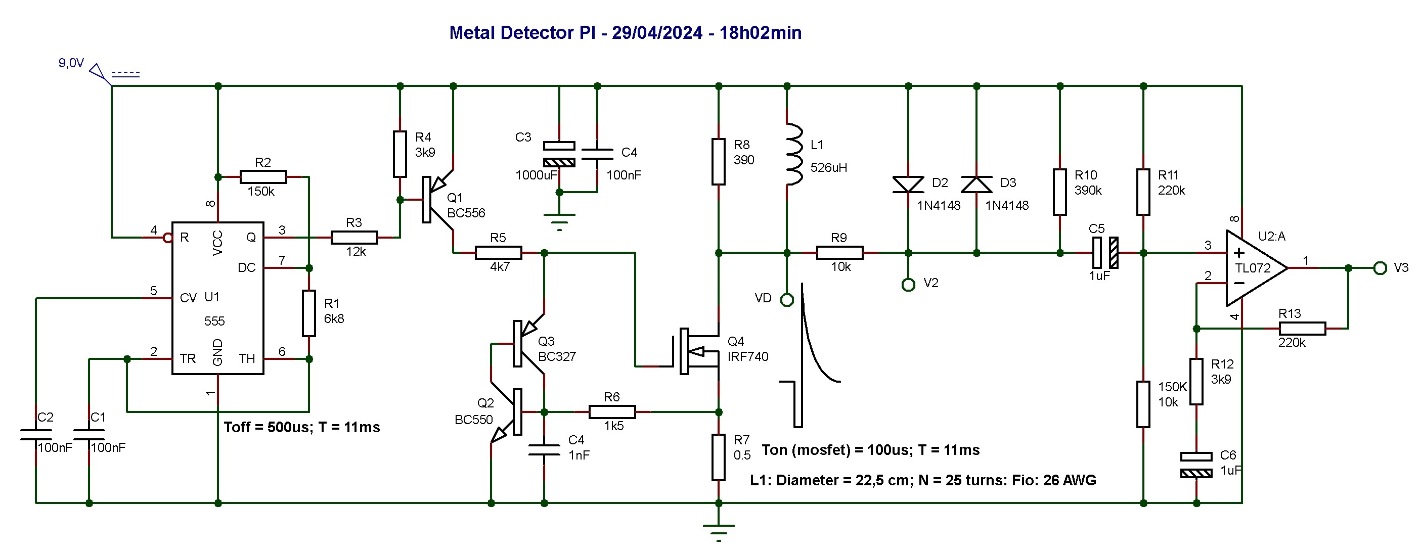

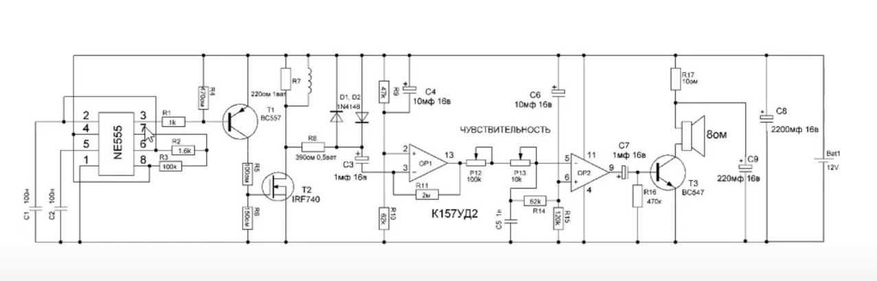

                  My Circuit.
                  Ton of 555 = 500us; T = 11ms
                  Ton of MOSFET = 100us; T = 11ms
                  I(MOSFET) = 1,2Apk

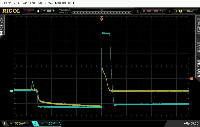

                  MOSFET driving and flyback signal. Yellow: V2 (on diodes). Blue: V3 (OA output. Pin 1)
                  Both the blue signal and the yellow signal are AC
                  Click image for larger version  Name:	2024_04_29_01.jpg Views:	0 Size:	82.6 KB ID:	423472

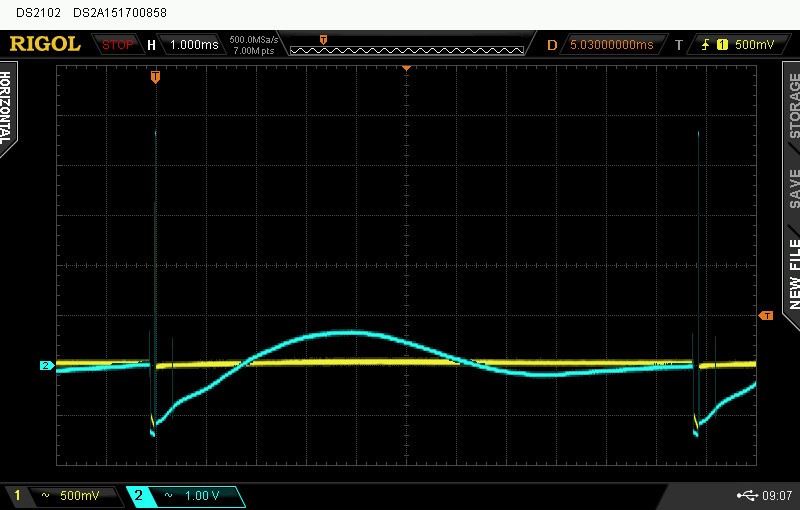

                  Same as the previous one but showing the entire cycle. Yellow: V2 (on diodes). Blue: V3 (OA output. Pin 1)
                  Note the undesirable signal between 2ms and 6ms.

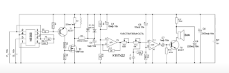

                    Is this the original schematic you are trying to improve?
                      Click image for larger version  Name:	PIRAT_DETECTOR.png Views:	0 Size:	136.5 KB ID:	423494
                      Yes it is the original circuit.
                      I'm trying to improve it. But there's still not much difference from the original.
                      The period of the 555 only differs at Toff = 500us (ton on the mosfet).
                      Q2, Q3, R6, R7 and C4 form an SCR, which limits the drain current to 1.2A (Ton on the mosfet with 100us), whatever the value of the L1 coil.
                      R9 = 10k. The value of R8 is such that the flyback pulse does not present overshoot, as can be seen in figure 2.
                      I increased the value of R9 (10k) to reduce the Icc current consumption. As a result, I had to change the signal for the positive input of the OA.
                      The value of the inductor L1 = 526uH is within the expected range for the Pirata detector.
                      Observing the blue signal at the OA output, in figure 2, the signal has 40us and when I place an iron box, this period increases, as it should be.
                      My only issue is that there is an undesirable signal between 2ms and 6ms (figure 3), which I believe makes it difficult to identify the useful signal.

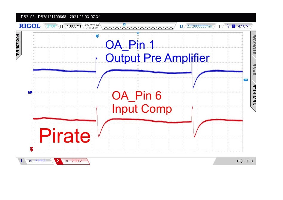

                            I finally finished assembling the Pirata metal detector and I have some observations to make:
                            I photographed the Pirate detector waveforms from pins 1 (OA output) and pin 6 (comparator input). Follow the photo.
Name:	2024_05_02_Pirata_Pinos_1 e 6_Ed.jpg
                            1 - The gain of the preamplifier in my circuit (non-inverter) is worth around 57 and is greater than that of the pirate (inverter). That's why the positive output of my circuit has almost 20us of saturation. The negative pulse of the Pirate preamplifier does not saturate, or is almost saturated.
                            2 - The preamplifier feedback resistor (1M8 or 2M or 2M2) of the Pirata detector has two purposes.
                            2.1 - Do not transform the preamplifier into a comparator.
                            2.2 - Establish the upper cutoff frequency. It turns out that depending on the OA used, this frequency may change, due to the open loop gain of each OA.
                            3 - Although this detector has a traditional circuit, I obtained better sensitivity by replacing the electrolytic capacitor at the preamplifier input, with a value 10 times greater.
                            4 - It would be interesting if the second OA, functioning as a comparator, was actually a comparator.
                            5 - The initial detection of small metals would be increased if there was a monostable stage between the comparator and the transistor driver. This monostable (555) could be driven by a current source instead of one of the resistors. This would maintain the signal frequency variation according to its intensity. This already occurs with the Pirata detector, but the beginning of detection would be more evident.
