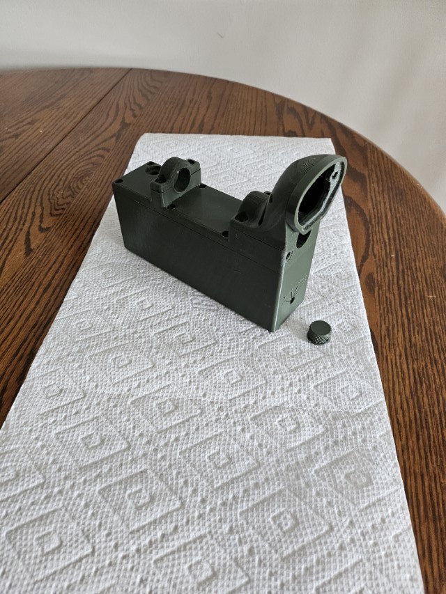

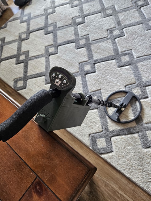

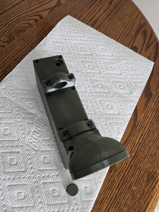

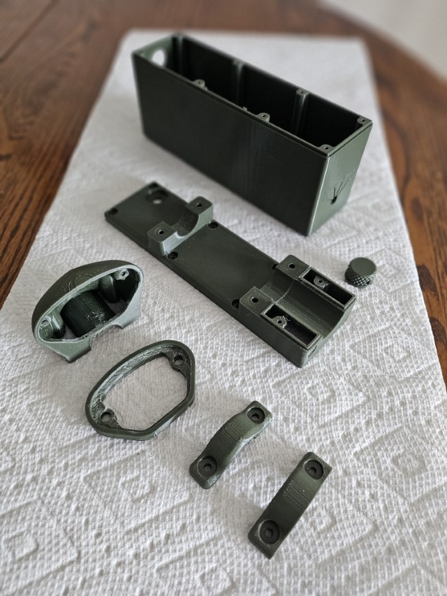

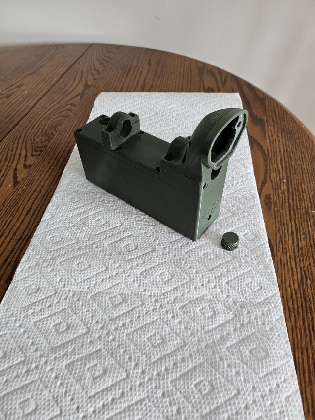

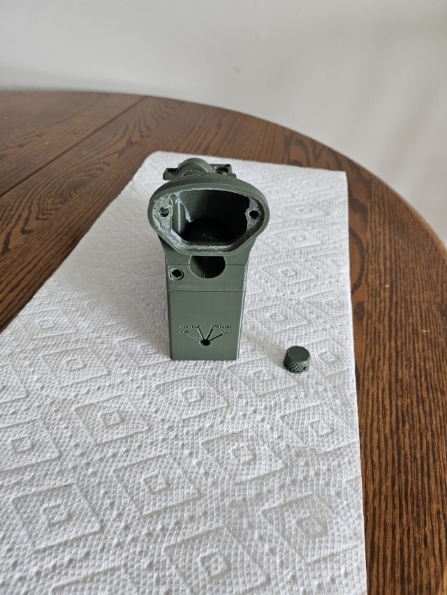

    About 5 yrs ago, Eric Foster gave me the electronics for a VMH3Cs to aid in our efforts to analyze the TX and FE methodology/technology. During that effort, I originally cased the electronics in a generic Hammond housing (discussed and shown here). Last year I obtained a Bambu Labs X1C 3D printer. Since then a project that has been in the back of my mind, has been to 3D print a new case for the VMH3CS electronics that looked and felt like a proper metal detector. Well, last week I stopped procrastinating and start the design/development of a proper VMH3CS re-case. The design was executed with Autodesk Fusion 360 and resulted with 7 3d models (electronics enclosure bottom, electronics enclosure top, two shaft clamps, power switch knob, enclosure-display transition, and display mount. The display mount holds the original Vallon VMH3CS display. The parts were printed with Olive Drab PCTG filament from 3D-Fuels. The attached pictures show the completed parts of the printed enclosure.
    Click image for larger version  Name:	Vallon-repackage1 (Custom).jpg Views:	0 Size:	141.9 KB ID:	424592 Click image for larger version  Name:	Vallon-repackage2 (Custom).jpg Views:	0 Size:	160.7 KB ID:	424589 Click image for larger version  Name:	Vallon-repackage5 (Custom).jpg Views:	0 Size:	140.9 KB ID:	424588 Click image for larger version  Name:	Vallon-repackage6 (Custom).jpg Views:	0 Size:	192.8 KB ID:	424591 Click image for larger version  Name:	Vallon-repackage7 (Custom).jpg Views:	0 Size:	111.3 KB ID:	424593
    The next step is final assembly (currently waiting on some 3mm black self tapping screws).

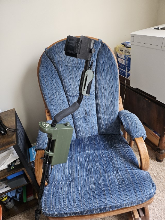

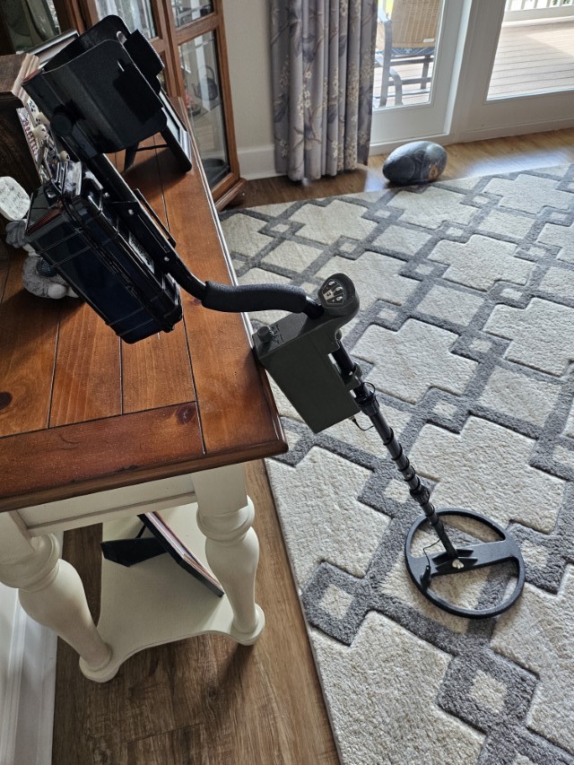

      More progress!!

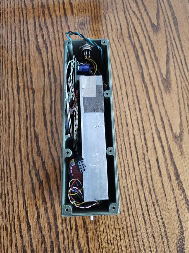

      Electronics fitted:
Name:	Vallon-repackage8 (Custom).jpg

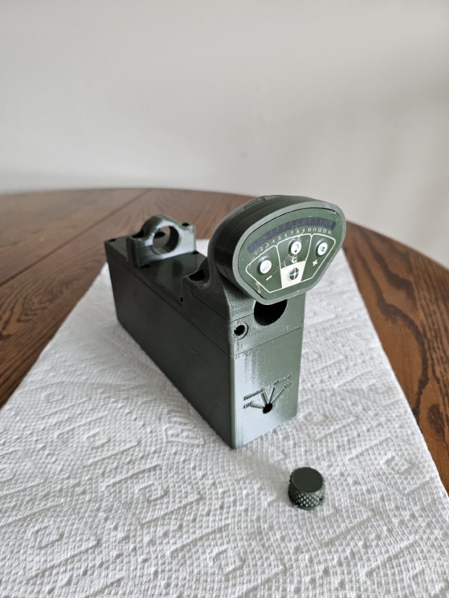

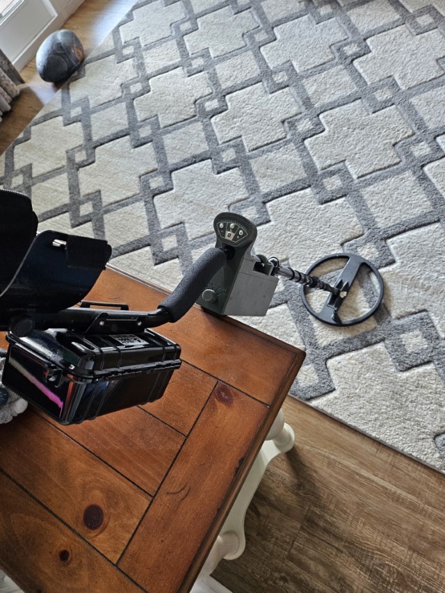

      All together and mounted:
Name:	Vallon-repackage9 (Custom).jpg
ID:	424618 Click image for larger version
Name:	Vallon-repackage10 (Custom).jpg
ID:	424617 Click image for larger version
Name:	Vallon-repackage11 (Custom).jpg
      The next part is to re-do the battery box arrangement. So far I am pleased with the result!

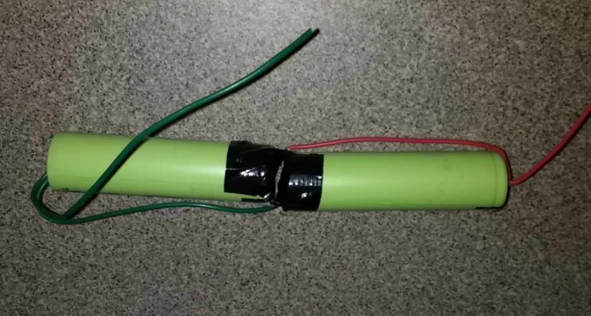

        I replaced the 3 bulky and heavy D cells with 2 x 18650 LiIon batteries in parallel.
        The Vallon is happy with 3.7V and it saves a couple of grams + you can recharge them.

          Currently using a 5V power pack... not really happy with it... I was thinking along the same line as you (2 18650's in parallel). What did you use to protect against the accidental reversing of one of the 18650's (which creates a battery short)?

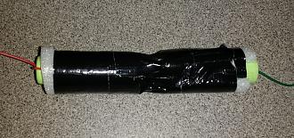

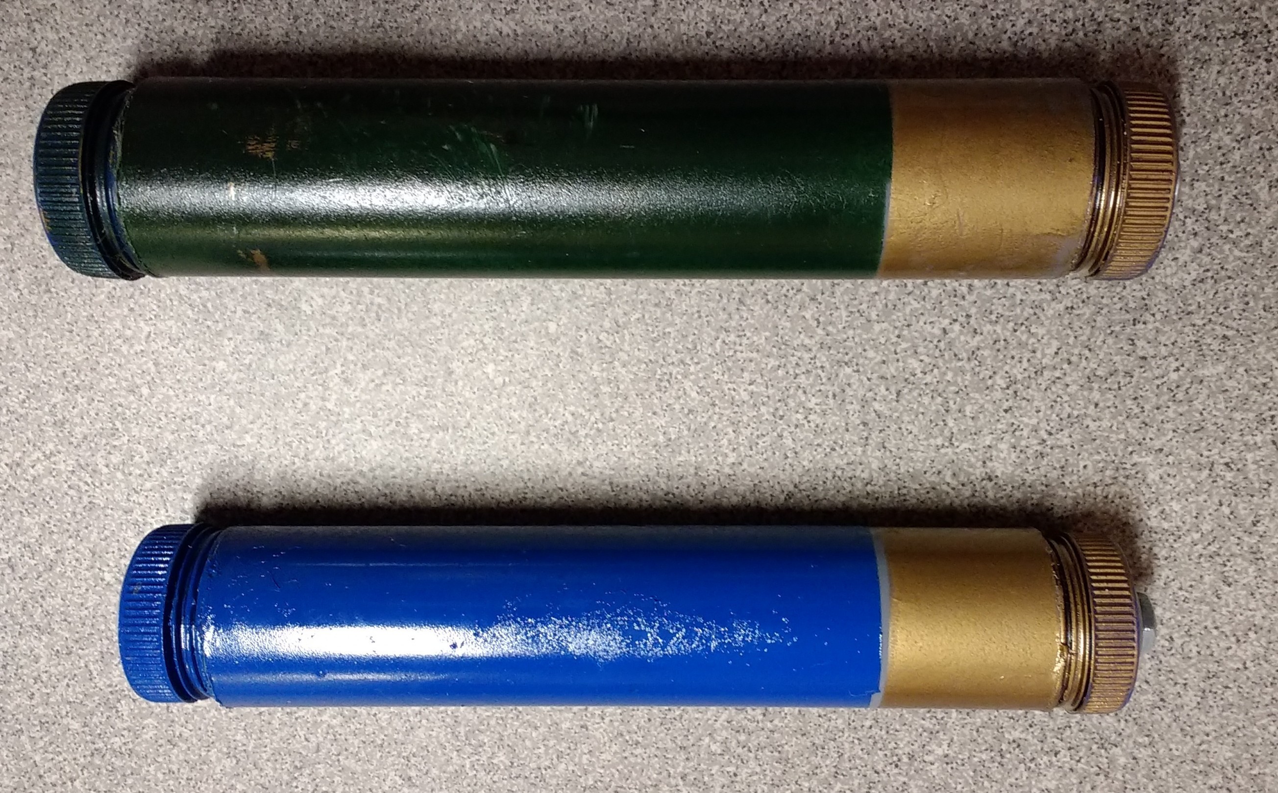

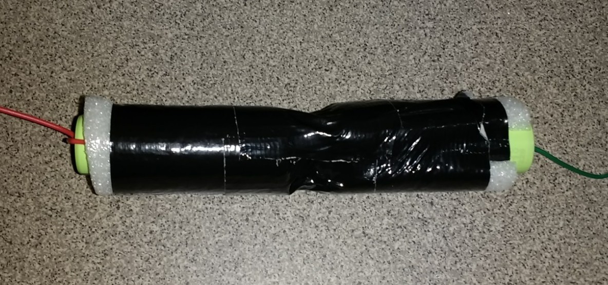

            I connected 2 x 18650 in parallel
            Click image for larger version  Name:	battery_3.jpg Views:	3 Size:	163.7 KB ID:	424630
            Then wrapped in some foam:
            Click image for larger version  Name:	battery_4.jpg Views:	0 Size:	199.4 KB ID:	424650
            Then placed them in a piece of drain tube with the same dimensions as 3 x D cells.

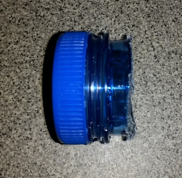

            Both bulkheads are the head of a PET softdrink bottle.
            Both ends have a screw and washer as battery contacts.
            Click image for larger version  Name:	battery_10.jpg Views:	0 Size:	984.0 KB ID:	424639
            The "golden" side is the plus contact. This slides head first in the Vallon tube.

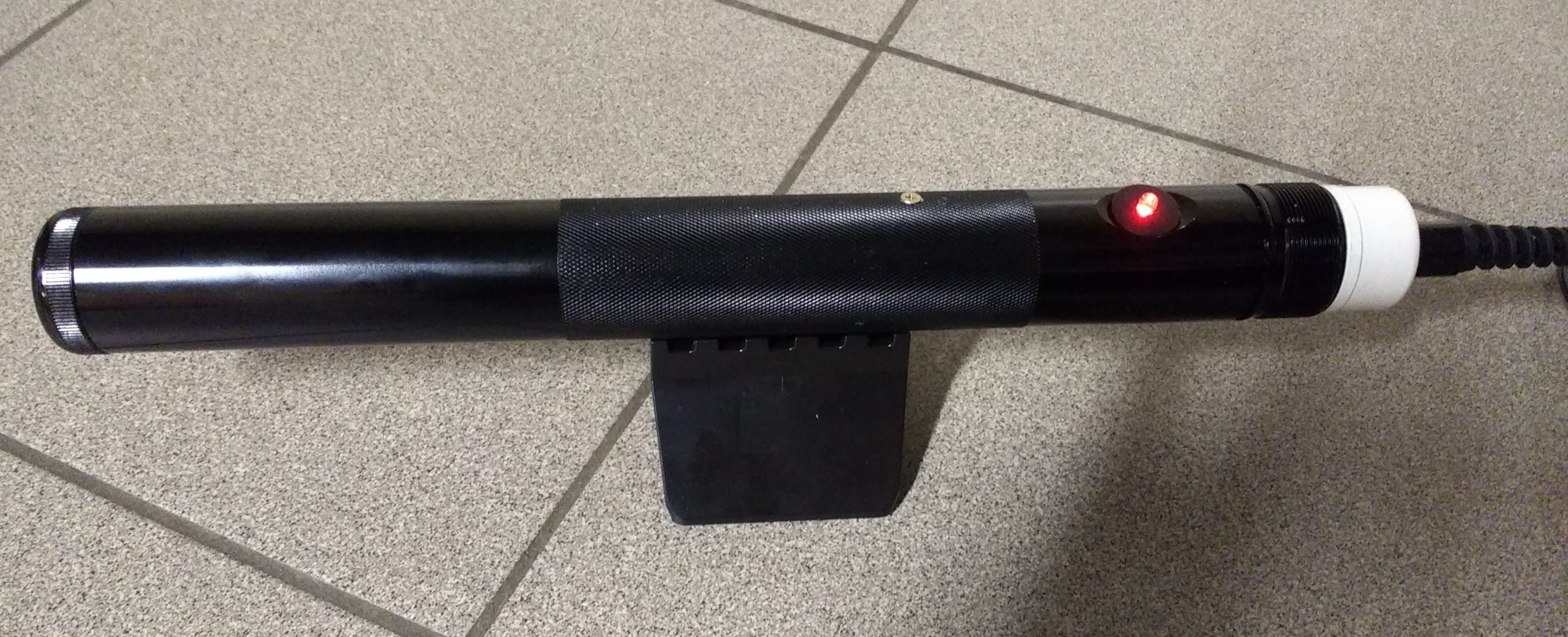

            Click image for larger version  Name:	charger.jpg Views:	0 Size:	998.9 KB ID:	424646

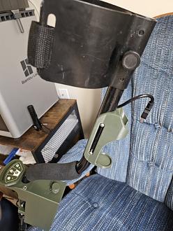

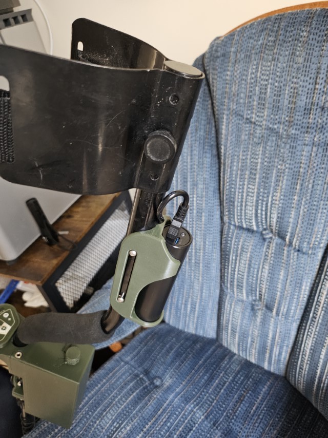

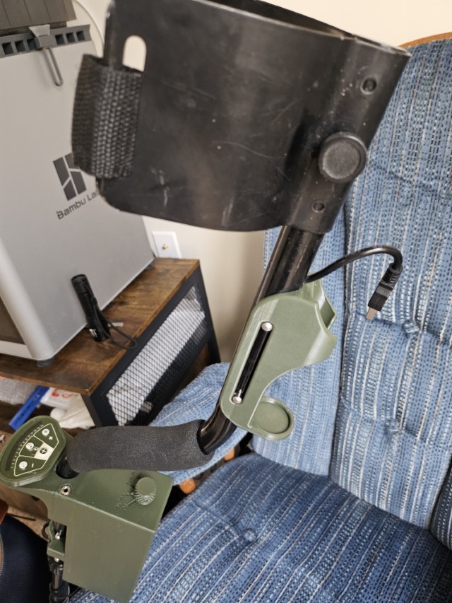

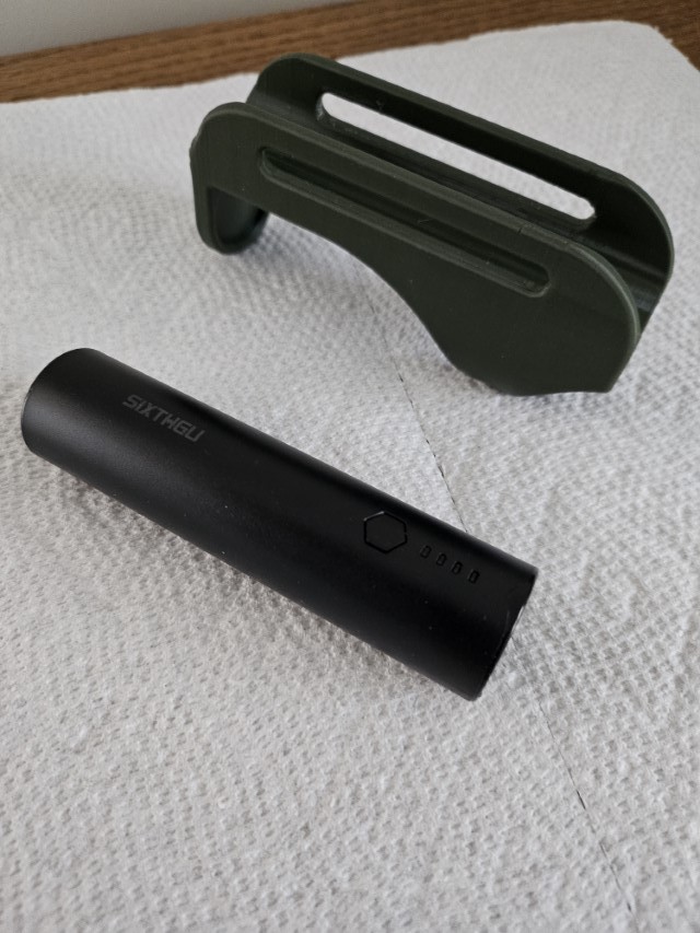

              Well... finally decided and implemented a battery box solution. I finally settled on a compact commercial usb power bank:
              https://www.amazon.com/dp/B0C7PHKKNK...t_details&th=1
              Designed (in Fusion 360) and printed (on my Bambu X1C) a clip-on holder (to fit the Whites "S" shaft) for the power bank:
Name:	Battery(1) (Custom).jpg
ID:	427287 Click image for larger version
Name:	Battery(2) (Custom).jpg
ID:	427288 Click image for larger version
Name:	Battery(3) (Custom).jpg
ID:	427289 Click image for larger version
Name:	Battery(4) (Custom).jpg
              Tested the unit and found that the battery pack powered the Vallon for 9 hrs of continuous operation before the battery needs recharged. I am more than happy with the final result!!!
