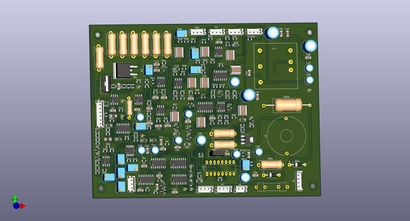

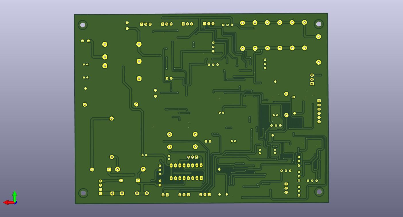

    PCB in 3D GS-6
      Originally posted by hunter63 View Post
      PCB in 3D GS-6
      HI HUNTER63
      CONGRATULATION VERY NICE JOB

        And what is the final schematic of this beautiful board?
          Hello
          I will post the corrected documentation after the PCB is launched, at the moment I am at the stage of ordering the PCB production, best regards​
